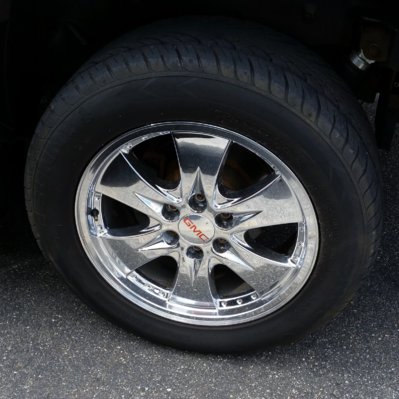

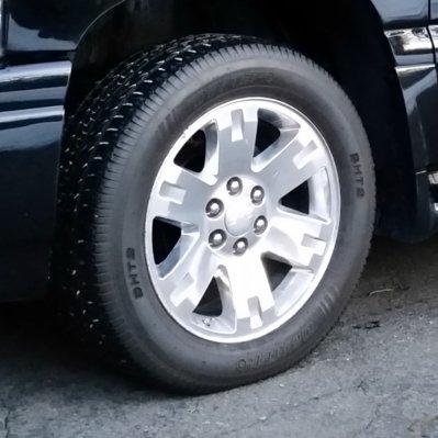

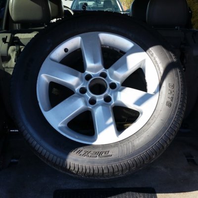

When I purchased my Yukon it had a set of dealer installed 20” six spoke GM 5239 wheels. They weren’t quite my style, and a life in New England salty winters had damaged them to the point that the chrome was flaking off. After months of searching Craigslist a set of NNBS 20” GM 5307 wheels off a 2014 Yukon came up. They were plasti-dipped black, and took the chance for $400 that they were in decent shape underneath. It was a real pain getting the plasti-dip off (WD-40 was the final solution), but I'm glad I took the gamble every time I walk up to it.
I moved the four tires that were on the Yukon over to the new wheel, and while they were remounting them I had four new ACDelco 15114379 TPMS sensors installed.
Before:
After:
Since there was no spare under the vehicle when I purchased it I found a used tire on Ebay that matched the style and tread depth of the ones that came on my Yukon, and then picked up a 20" rim from a 2009 Nissan Titan at a salvage yard. I had them mounted and balanced as a full sized spare. Now I don't have to worry about damaging the AWD do to a difference in the spare’s diameter, and I have a spare that I feel comfortable using if I had to put it on while towing.
Titan Spare:

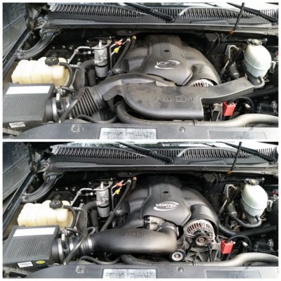

I picked up a nice clean Vortec 6000 cover from @TheAutumnWind for the cost of shipping plus some beer money. While I had it off, I thought it would be a good time to install a new intake tube, so I grabbed an Airaid MIT 200-919 from Advance Auto Parts. They list it for $145, but I stacked a 30% off coupon code and some of their SpeedPerks rewards ($20 & $5) that I had earned from previous purchases. I walked out the door with it for $81 in the end.
They two of them together really cleaned up the engine bay.

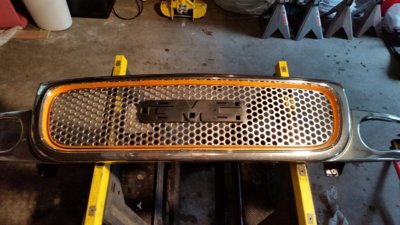

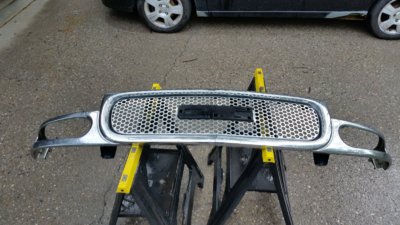

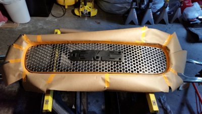

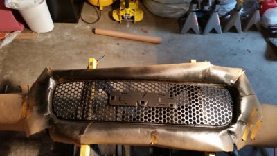

This grille was damaged when I got it last year, so I repaired the cracks with epoxy and sprayed it with a semi-gloss Rustoleum designed for plastic. I used Scotch Brite to clean the surface, and then wet sanded the the chrome mesh before I masked it off and painted it.
For the damaged struts between the main grille and the turn signal surrounds I used JB Weld epoxy. For the main break in the grille surround I embedded a 1"x4" piece of perforated steel in the epoxy to bridge the area.
It was basically a test to see if I Iiked the look, which I do. If my repairs fail or the paint doesn't hold up I'll find a new grille and have it professionally painted, but for now they are both holding up well.

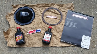

Changed the fluid in both my front and rear differentials and the transfer case. While I had it apart I installed a new cover on the rear diff and used a LubeLocker gasket when I put it back together.
This was my first servicing of the diffs and transfer case since buying the Yukon. The rear diff fluid looked fairly clean, and had been serviced before at some point. Only a little metal dust on the magnet. The front diff appeared to have never been serviced in the 160K on the vehicle. The fluid was dark and opaque. The magnet was covered in a thick layer of fuzzy metal shaving, but no metal chunks or chips.
The transfer case fluid looked clean, but the big surprise was about a quart of extra fluid came out when I opened the fill port before draining the case. A little research suggests that I have a bad input shaft seal on the transfer case and ATF from the transmission is making its way in. I've been keeping an eye on it now since the level in the case is where it should be, but haven't noticed a drop in the level of the transmission fluid.

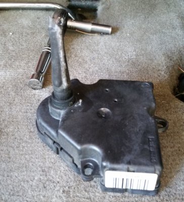

When I purchased the Yukon one of the items on the to-do list was that the back HVAC did not work properly. I tracked it down to what I thought was a bad air blend door actuator. After watching some videos it seemed pretty straight forward, just removing all the interior trim and panels to actually get at it. Much simpler than getting to the passenger side front actuator that I replaced earlier.
When I finally got to it, and pulled out the actuator to my surprise this is what I found:
The shaft came out with the actuator, and appears to be no longer attached to the blend door.
After watching this video, I decided just to replace the entire rear HVAC housing. For the price it was worth only having to do it once rather than attempting to repair the blend door, only to have it fail again later.
It was pretty straight forward, and I just moved step by step taking components off the old unit and transferring them to the new one. Even with taking my time, it only took about an hour to swap it out.

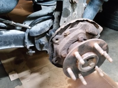

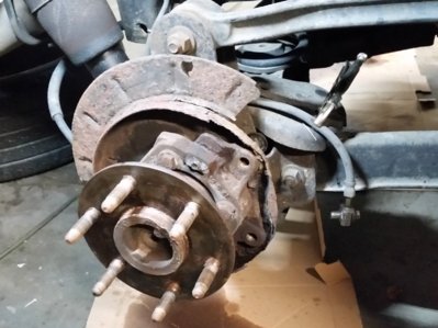

Decided to do a little prep work this weekend to help my complete brake system overhaul go a little smoother next weekend.
I got the Yukon up on jack stands, got all four wheels off, and have started soaking every nut, bolt, and coupling I plan on touching with penetrating oil.
I also decided to pull apart the back drums to make sure everything would come apart without breaking. If so, I wanted to order the parts now so I'd have them on hand for reassembly.
Driver's Rear:
(A lifetime of salty winters really wasn't kind to the rear backing plate on this one)​
Passenger's Rear:
(This backing plate is mostly being held on by rust scale)
I was able to brake all four of the bolts that hold the emergency brake plate on loose on both sides this evening. Hopefully with a little more penetrating oil down the threads they will come out without incident, and I can slip the new backing plates in place and start the process putting all these pieces back together after Thanksgiving.

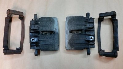

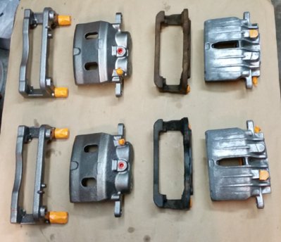

I also decided since I had the rear calipers off, and the new NNBS calipers on hand, I'd clean them up and prep them for paint. I'm going to black out the brackets and calipers to blend in with my coated rotors.
Rear Calipers & Brackets after removal:
(Stained with penetrating oil not leaking brake fluid)​
NNBS Front & NBS Rear Calipers & Brackets Prepped for Paint:
I'm going to hit these with a few coats of Rustoleum High Heat Primer and Black Caliper Paint over the next few days.
