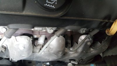

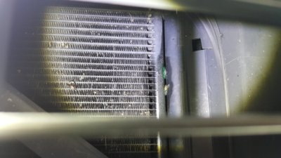

Add me to the list of leaking condensers. 2015 Yukon XL no AC yesterday on our way up to the lake. Checked it out this morning leaks pretty obvious. Driver side of the condenser. Think I found a cracked exhaust manifold too. 20170904_090731.jpg 20170904_090731.jpg 20170904_091017.jpg 20170904_090731.jpg 20170904_091017.jpg
