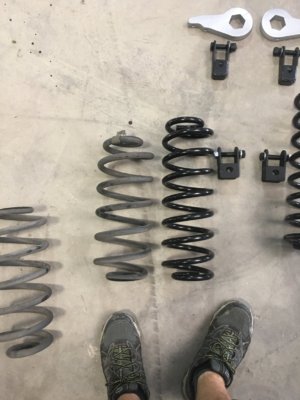

All the parts are installed. Wasn't bad at all. Definitely need some tires now. The z71 coils gave me almost exactly 2" lift.
After measurements
Front driver: 37"
Front passenger: 37 1/4"
Rear driver: 37 1/4"
Rear passenger 37 1/2"
Not bad considering I only spent $100 so far. Here are a few pics to compare stock parts to new parts.

View attachment 182715 View attachment 182719 View attachment 182717 View attachment 182718 View attachment 182716
so you put the springs in the back and then leveled it out?

Yes. Still have about 3/4 " adjustment on the torsion key so if I wanted to do some 11/2 spacers in the back I can still level everything close.
