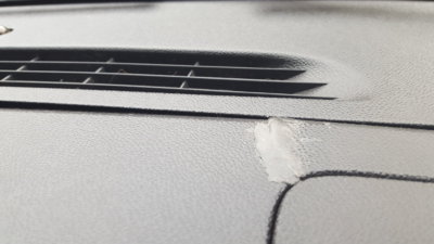

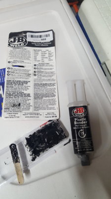

Nice work and thanks for the tips. Mine just started cracking in the same spots but wasn't bad enough where I had to take the dash out. I used some of this JB plastic bonder and hope it stops the cracks from spreading.
