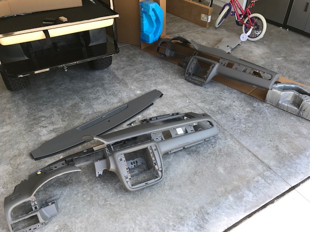

lots of epoxy was used around the airbag hole. there was a lot of plastic missing:

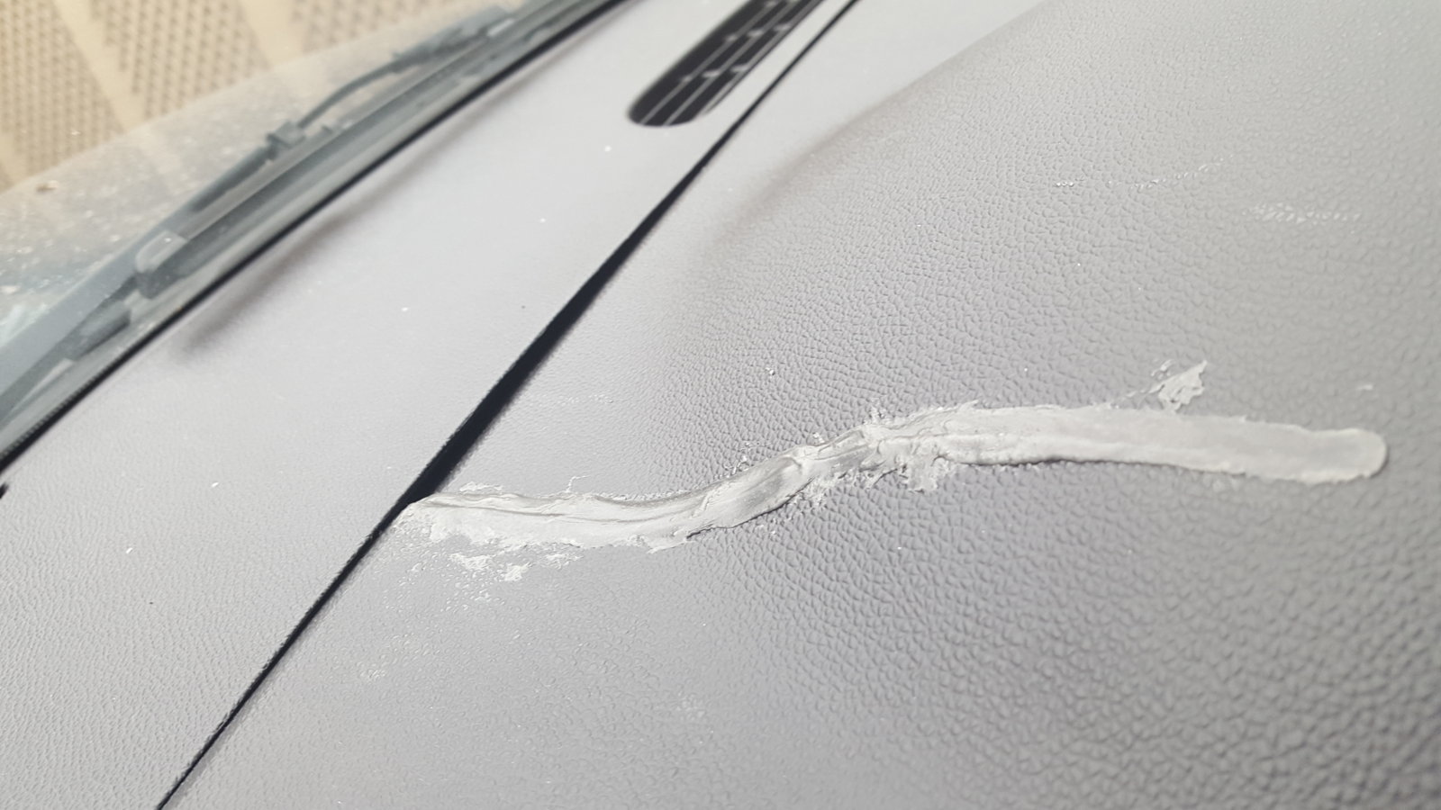

the crack next to the gps antenna took a lot of epoxy - it never did cure just right. had to use zip ties to hold the dash in place while it cured:
again, this single piece is huge. glad my son was able to help me get it in and out of the truck:

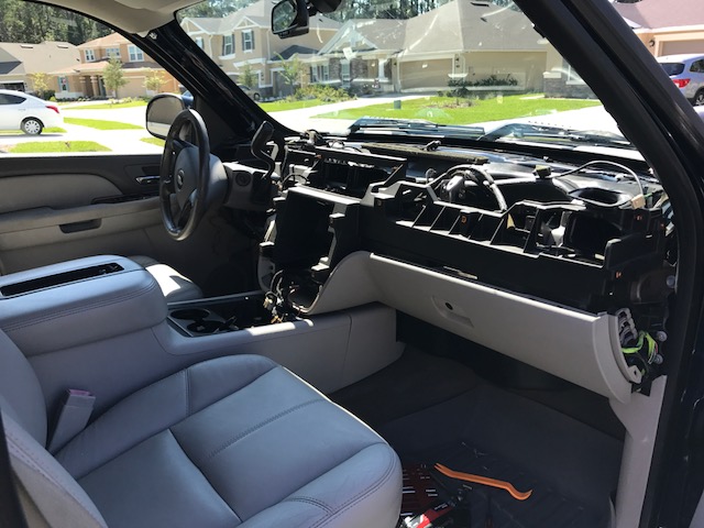

for a diy'er, the inside can look a little intimidating once the dash is out:

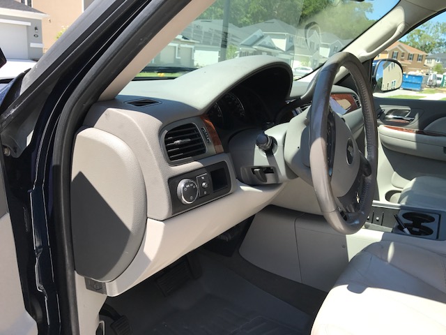

all in all, i'm glad i tried it. it took me just over two hours to remove, a little over 2 hours to install, and a 2 hour break in the middle to apply epoxy, let it dry, and make lunch. i'm sure when i finally decide to spend the coin and replace it altogether that it will go a lot quicker. any competent tech should be able to do the swap in half a day if a novice like me can knock this out.
the end result is fine for me. there is some spots on the surface of the dash where the cracks don't line up perfectly, and some other spots where the clear epoxy came through. you'd only really notice if you know what to look for when it comes to cracked dashes.
