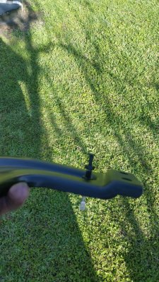

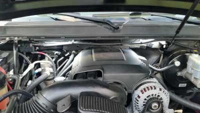

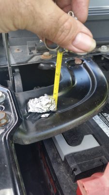

The under hood light install went easy. I started by locating my switch. I used tin foil to set switch height. 20170414_165121.jpg
Then I closed the hood and measured the height.
Then removed brace and installed switch.

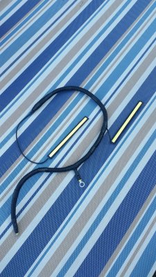

Then I built my wiring harness. I tapped the power from the junction box by the battery.
