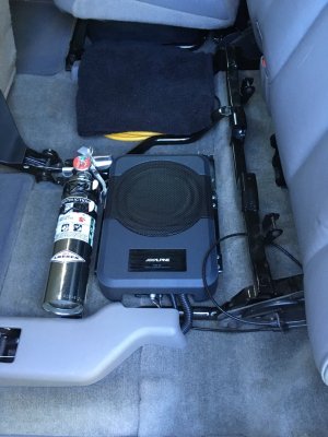

image.jpeg So I changed my mind after reading all the comments and suggestions. Since a had replaced the HU with an Alpine unit that had line outputs, I went with a Alpine compact powered sub. Installed under the rear seat. Kept the working stock sub. All in for $310, and about 10 hours work. Taking my time, I need to remove the rear seats to modify the bracket so the sub fit where I wanted it and custom made mounting brackets. Front seat lossened to run line cable away from power wire. All in all I could not be happier. Fills in the sound I was looking for, didn't take up cargo room, and not too much $$$ for what I got.

View attachment 64956 So I changed my mind after reading all the comments and suggestions. Since a had replaced the HU with an Alpine unit that had line outputs, I went with a Alpine compact powered sub. Installed under the rear seat. Kept the working stock sub. All in for $310, and about 10 hours work. Taking my time, I need to remove the rear seats to modify the bracket so the sub fit where I wanted it and custom made mounting brackets. Front seat lossened to run line cable away from power wire. All in all I could not be happier. Fills in the sound I was looking for, didn't take up cargo room, and not too much $$$ for what I got.
looks good man! nice and clean
