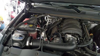

I would have to say the Magnaflow muffler paired with the AFE CAI is freaking awesome. I don't need a dyno sheet to prove its performance. It may be a placebo e ffect but I feel something good when I give it WOT and the deep sound it gives off... Its good!! As a matter a fact it blew my transmission!! 2nd tranny being installed at the dealer.

Very cool! I already have the AFE installed.
