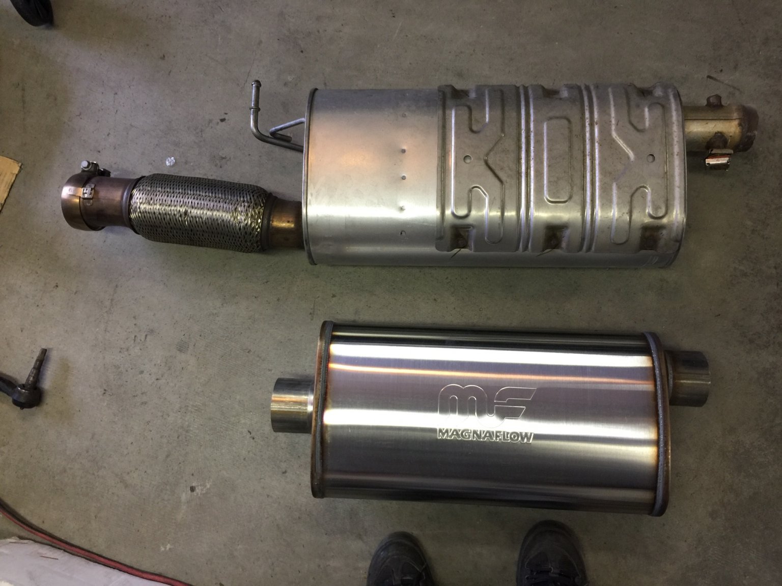

DO NOT CUT THE RESONATOR ON THE 15 UPS. HORRIBLE DRONE and sound. Just do the MagnaFlow muffler I have on my site and your done

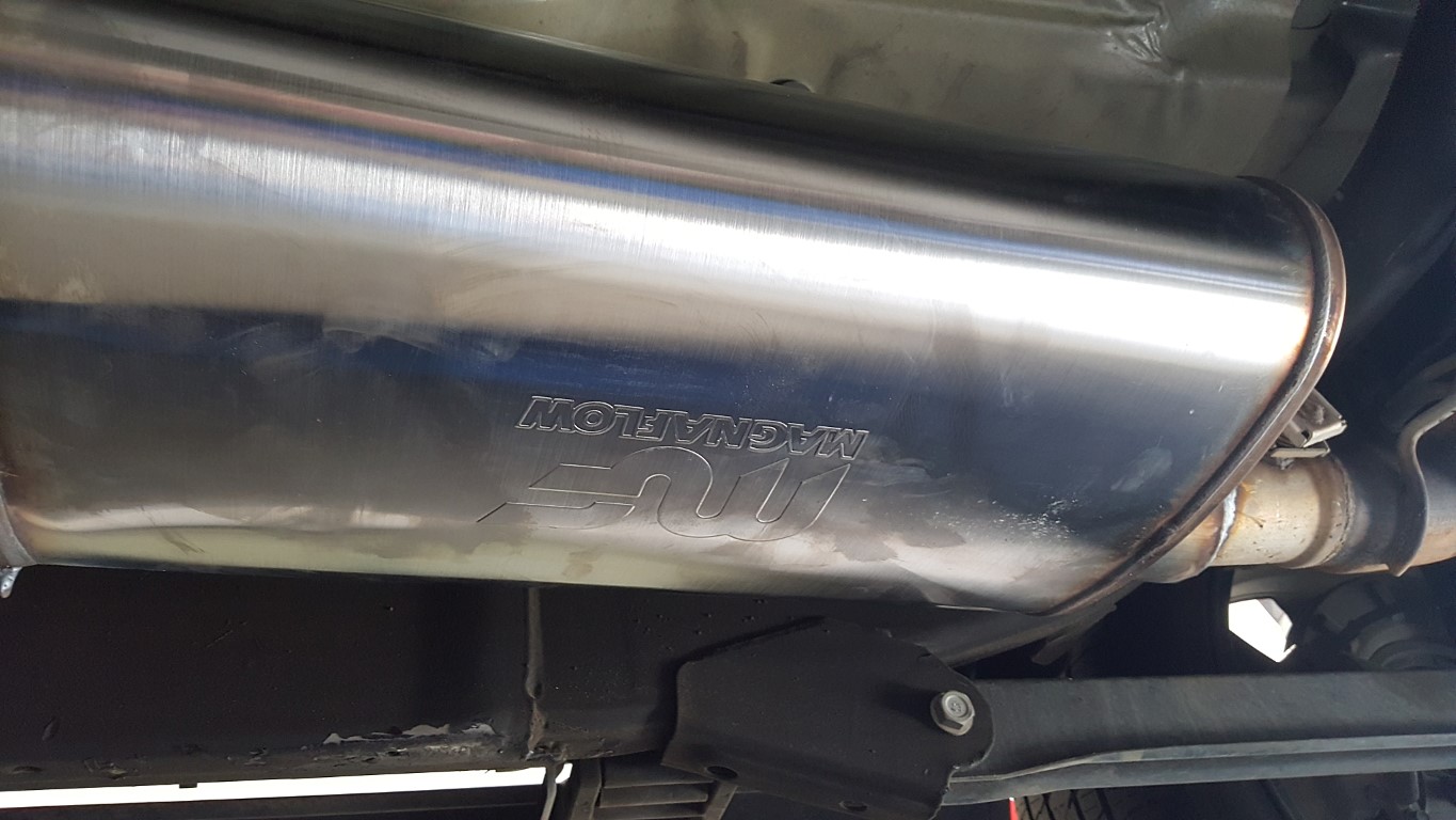

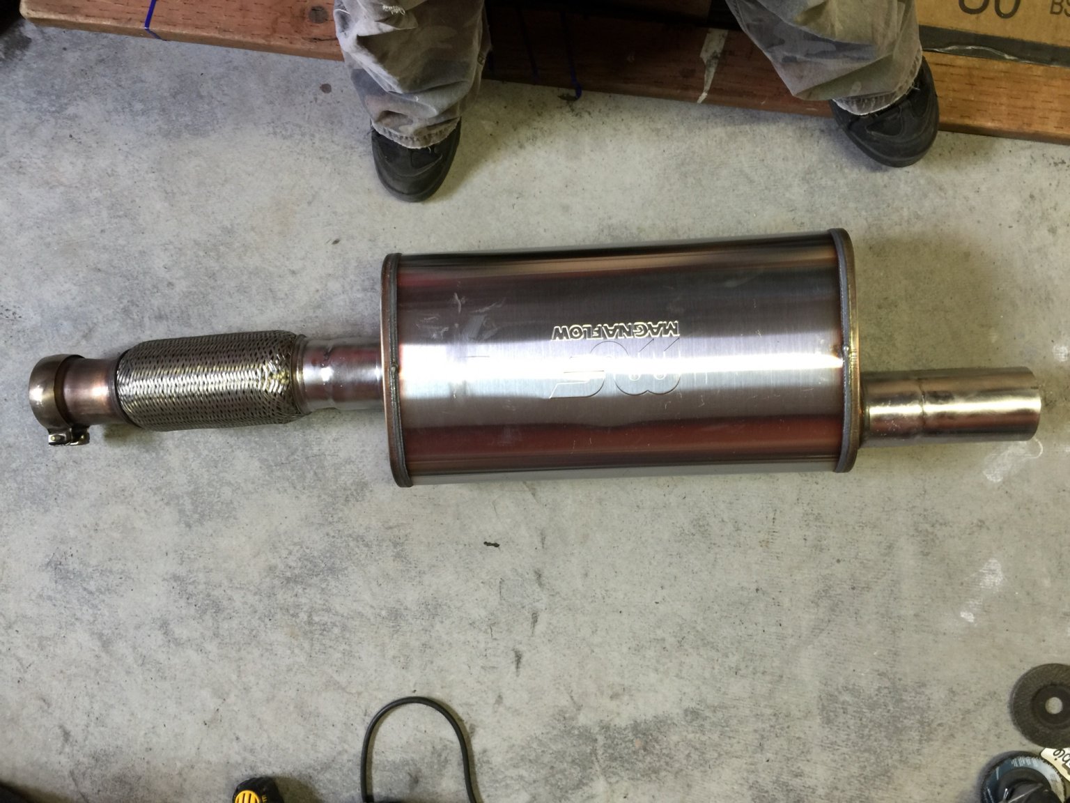

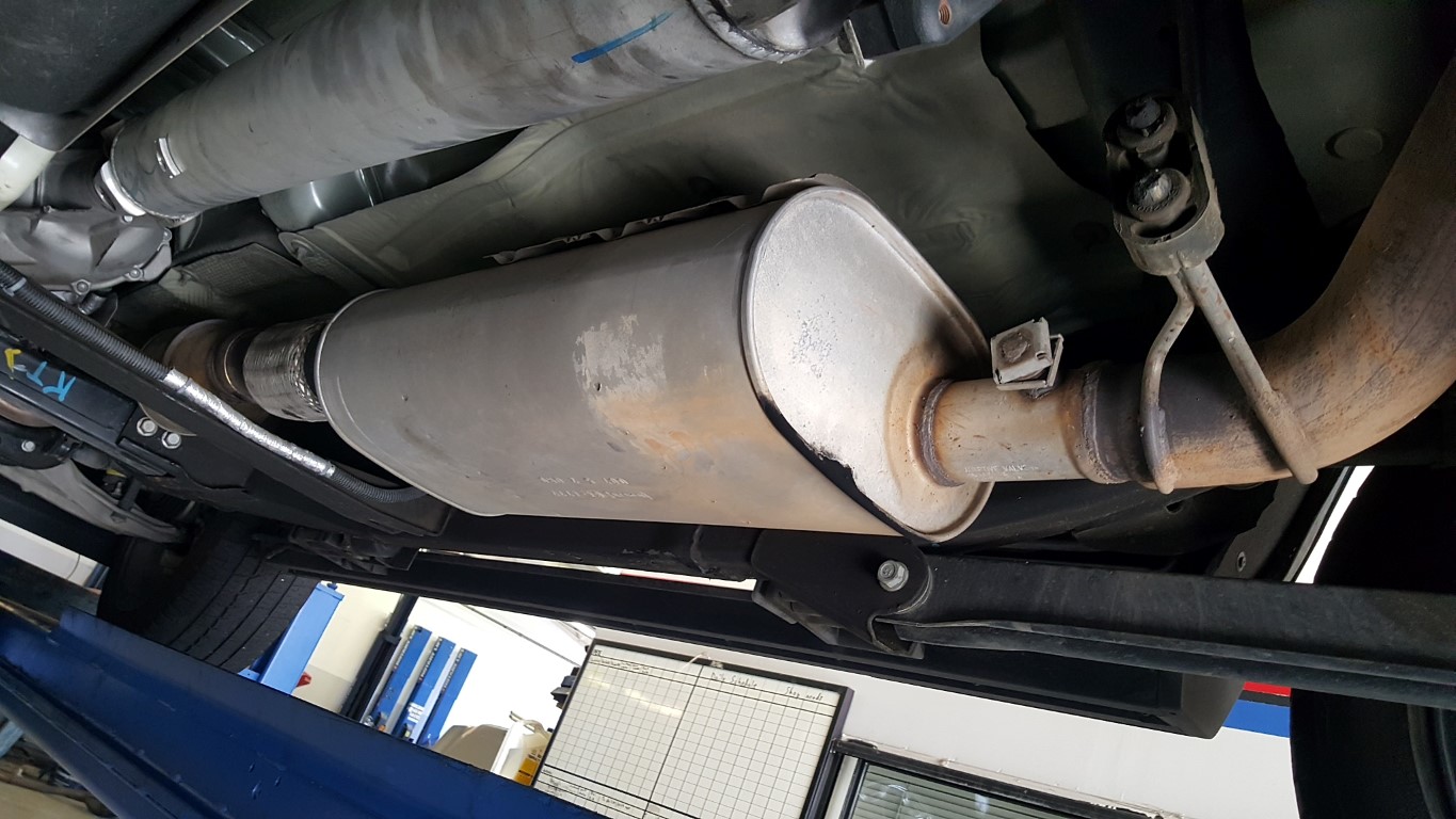

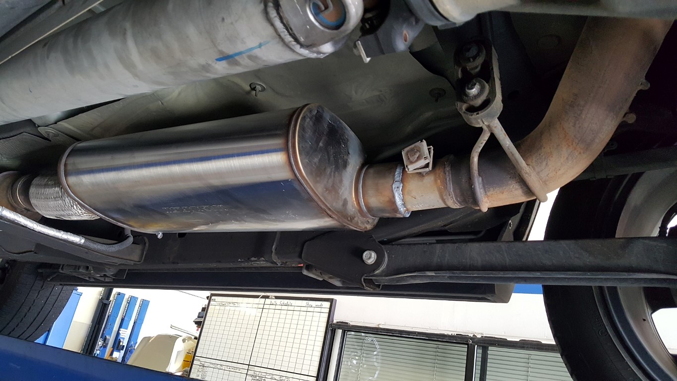

I had my Magnaflow installed that I got from Mr. Tony... It sounds pretty pretty good!! very happy with the sound. A much throatier sound and NO DRONE!!! left flap valve and resonator. The flap valve is questionable... the muffler place said it looks like a 3" diameter vs the 3.5" only that small section. I almost had him remove it but didn't want to chance drone if I removed it. by the way it was a buck and a quater to get it welded in place.
View attachment 63454 View attachment 63454 View attachment 63456

Yeah if you take flapper valve out will be more deep
