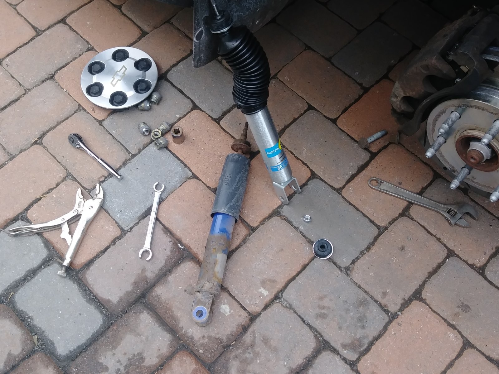

yeah, the fronts look like a standard shock, old vs new.

i didnt, my brother didnt and he had that air ride set up.
rides the same, only nicer.
