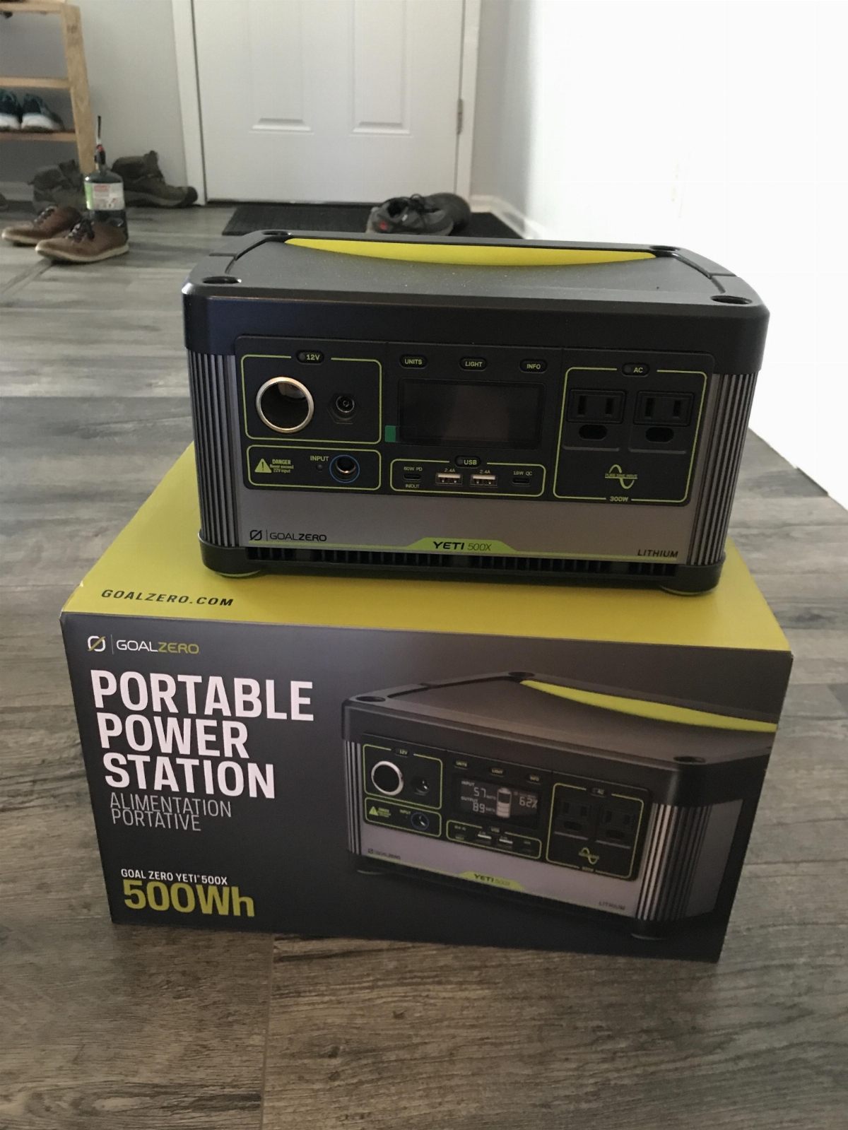

How about a Jackery? I've heard they're very good.
Those were on the list along with Rockpals and Inergy. What sealed the deal for the GoalZero was I got it for 20% off in store at REI, which has an amazing return policy. If you look at Amazon, there was only a single, no name 500wh generator that was Prime eligible. I just looked at the Jackery 500 again on Amazon and while it's still not Prime eligible, there's a decent sale at $450 (inc. the $50 coupon).

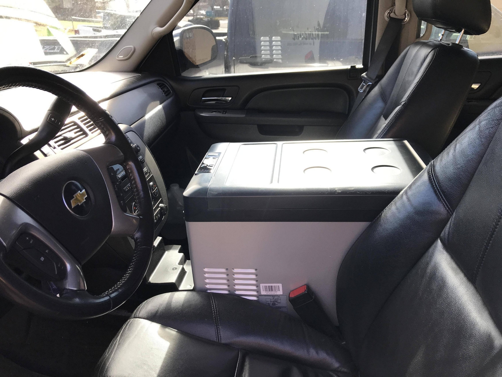

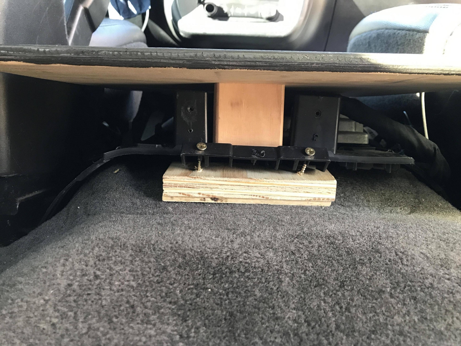

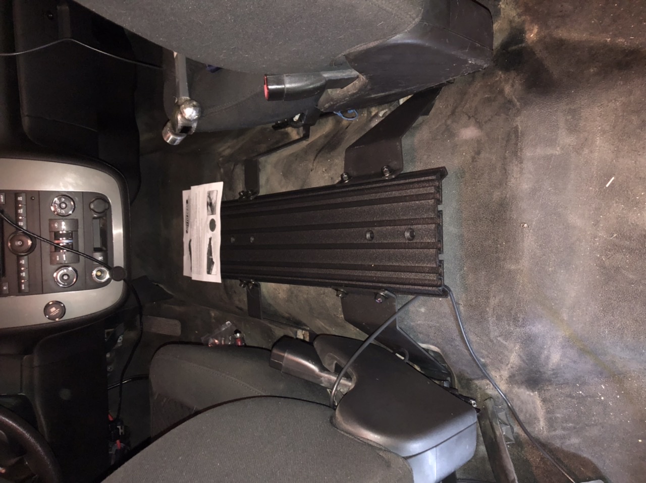

I removed all of the rear seat in thecopcar. Most is space for the overland hound. The rest will be where a 35 or 40 L fridge will go.
as far as consoles go, all the various public safety models use a floor plate that’s tied into the front seat mounting points.
That would be perfect for a fridge mount. Do you happen to know the part number?
the floor plate I have is made by Jotto. I don’t have the model number. Look up Jotto or Jottodesk, the search for Tahoe. It should come right up.

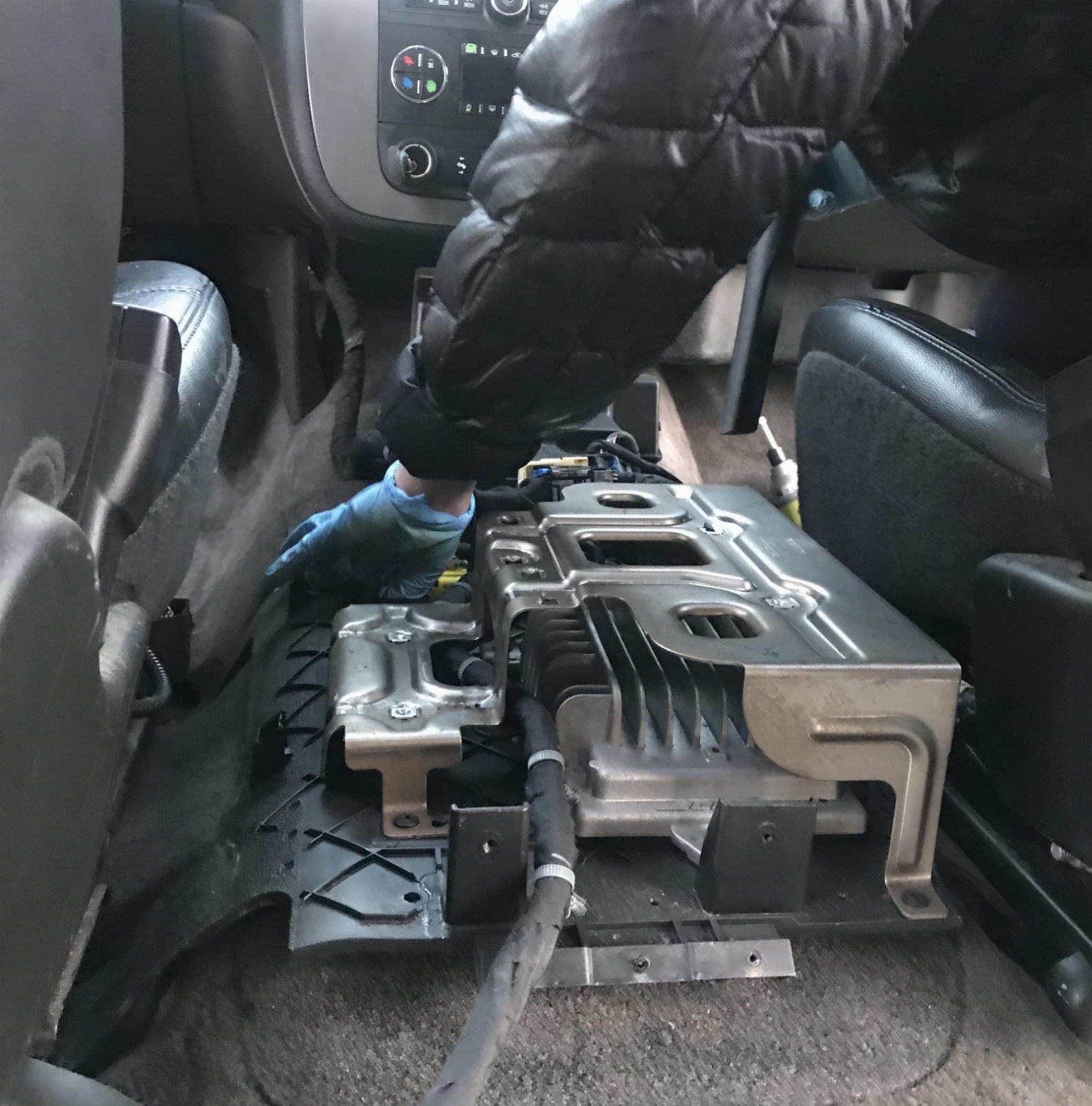

That floor plate would be perfect however my truck has the amp and SRS module, as well as a subwoofer, that seem to be in the way. Interesting to see those may not be present in the PPV...Anyways, at least the attachment legs aren't fixed so I could always modify it. I'll definitely check out Jotto. Thanks for the tip!

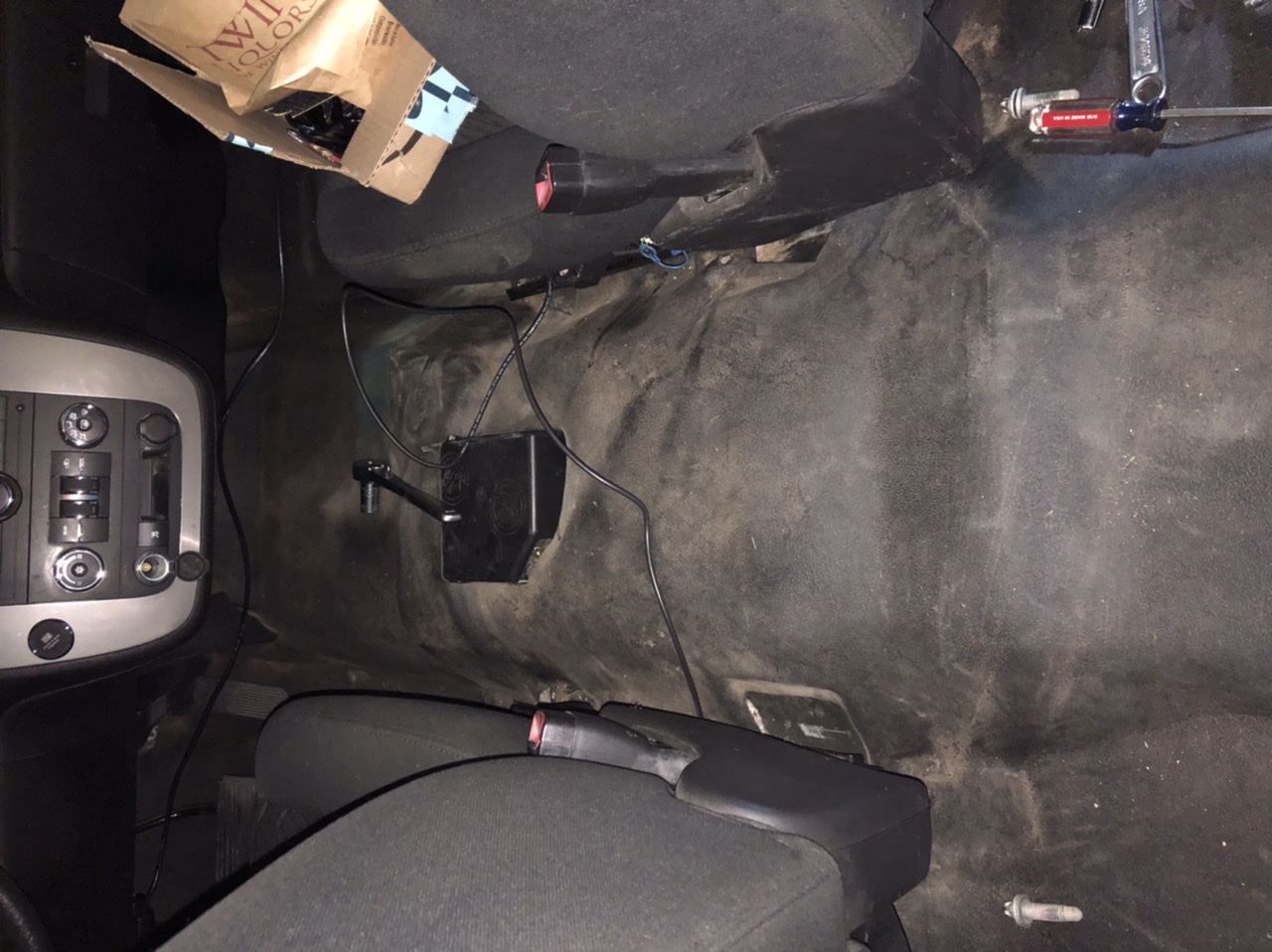

Here’s the bare floor.

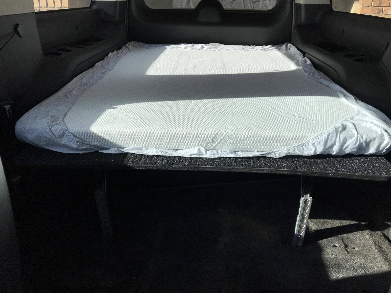

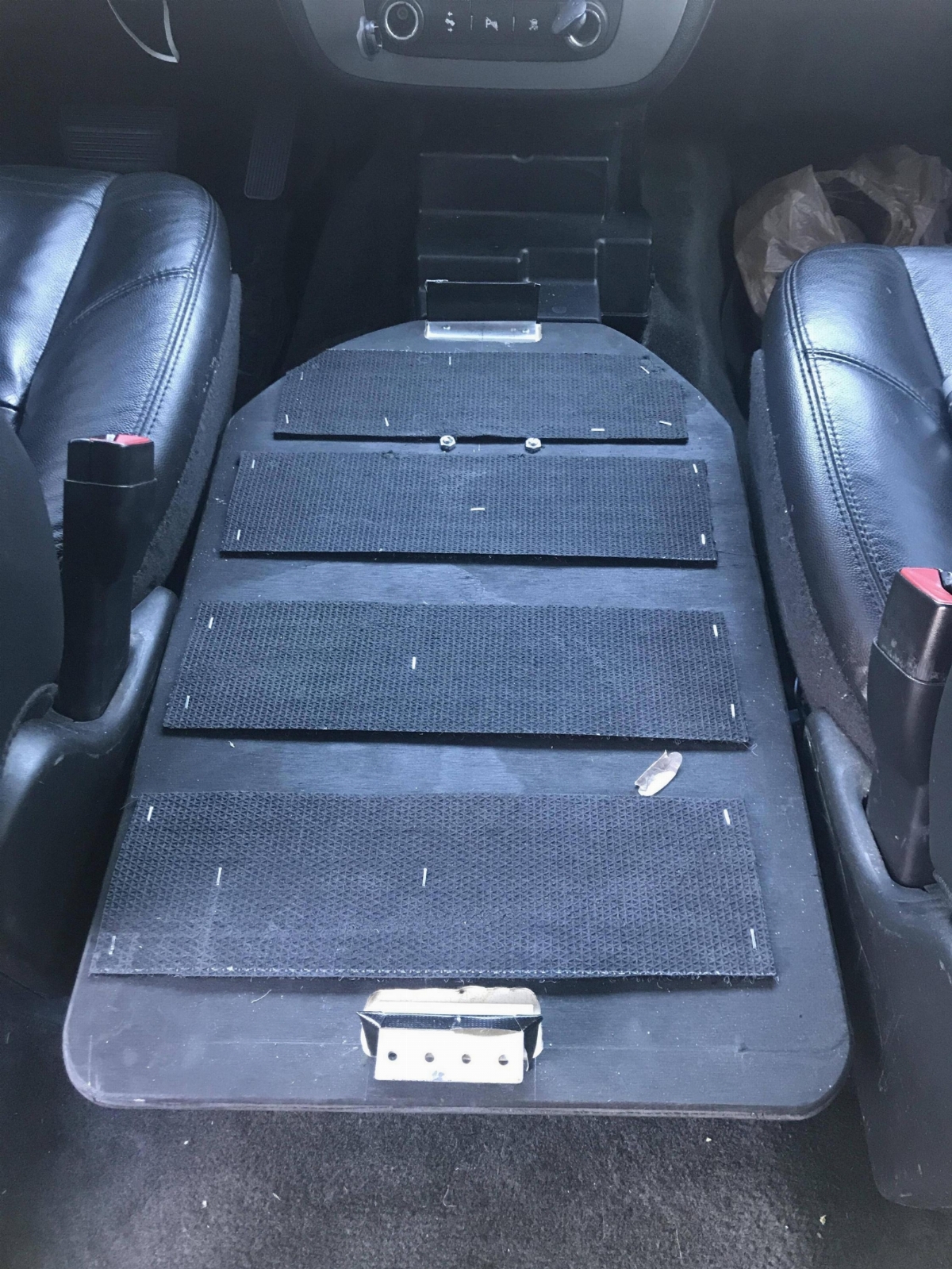

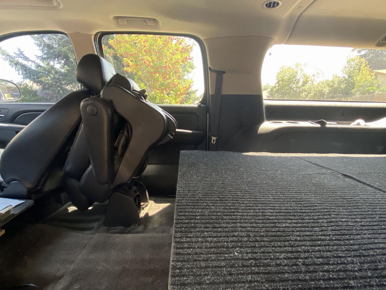

No changes to the build itself but I did reinstall one of the 2nd row seats a few months ago. With the camper folded up there's plenty of room for 2nd row seats, with the seat folded (as pictured) there's plenty of sleeping room.
If I were to do this build again, I would probably just make a removable shelf with storage drawers underneath and fixed legs instead of the hinged shelf and folding legs. Reason being is we don't use this as a camper nearly as much as expected and all the moving pieces can be a little annoying with the squeaking and rattling. Plus a removable shelf would offer even more storage in the 2nd row area when we're not camping (which is the vast majority of the time). I'm happy with the rear platform although there's been a few times where an extra 6" clearance would make transporting large items easier. I wouldn't

I really like the hinged shelf solution, rattle as it may, as we'll have to keep the 2nd row seats in the truck with the grandkids going with us. Nice job!
Even so, with one of those damn Nascar roll-cage baby seats it's going to be a pain until the little guy gets considerably larger. Question for you, though - how were your door mouldings attached? Mine aren't falling off like yours. I'm just wondering what's involved in yanking them off before I ruin a paint job underneath them. Thanks!
Edit: May have just solved my own problem. I could build the platform so the hinged portion is divided at the hinges. Since he won't need the full length of the platform for a few years, I could just flip up the one rear seat that doesn't have a car seat in it to give me room and leave his side with his car seat alone. Once he's big enough for a simple booster seat, all those issues go away.

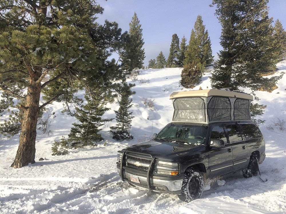

Just throwing this idea out there.. Give you a bit more space, and doesnt effect fuel mileage...
There are also hi-top conversions.. Something like this. This is on a van, but they do make them for Suburbans. These do affect fuel mileage.
