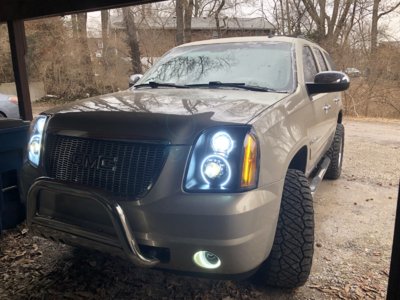

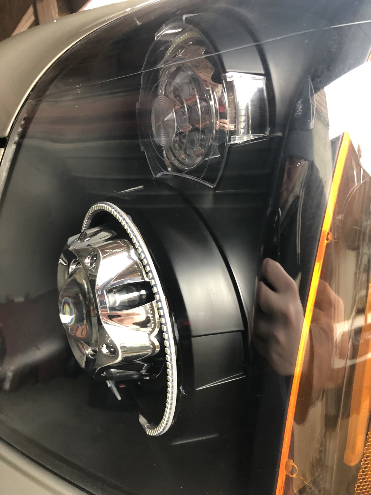

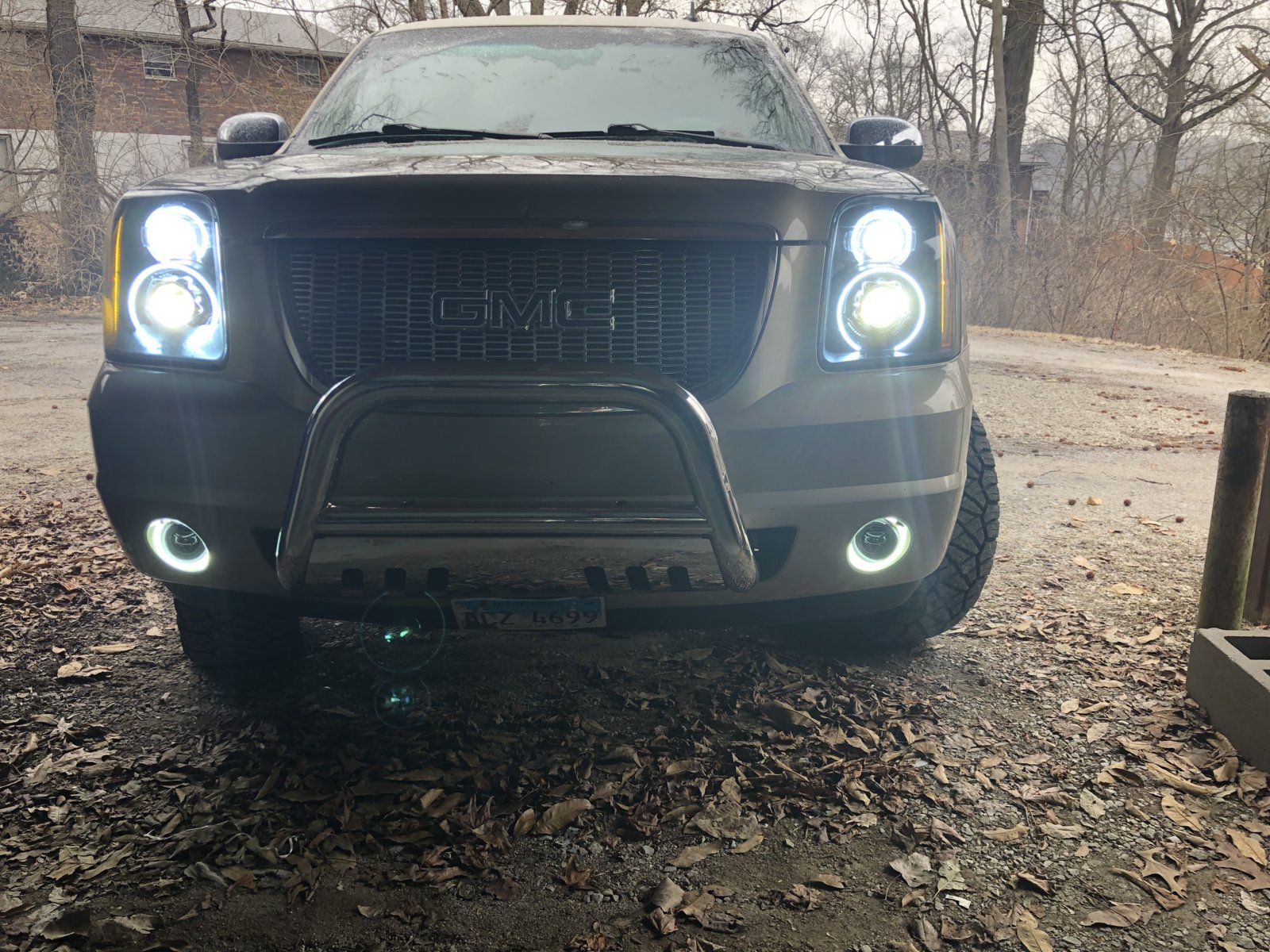

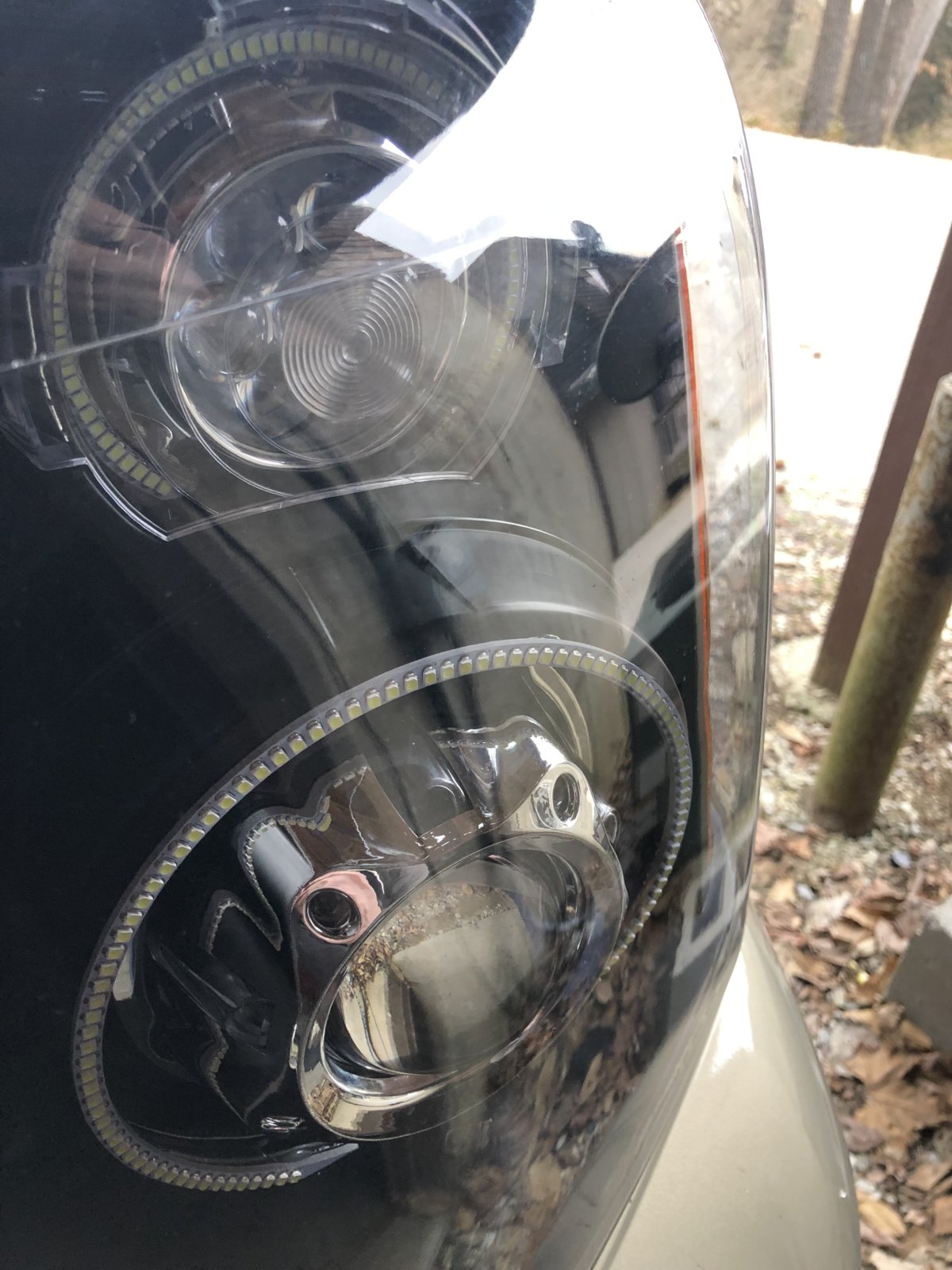

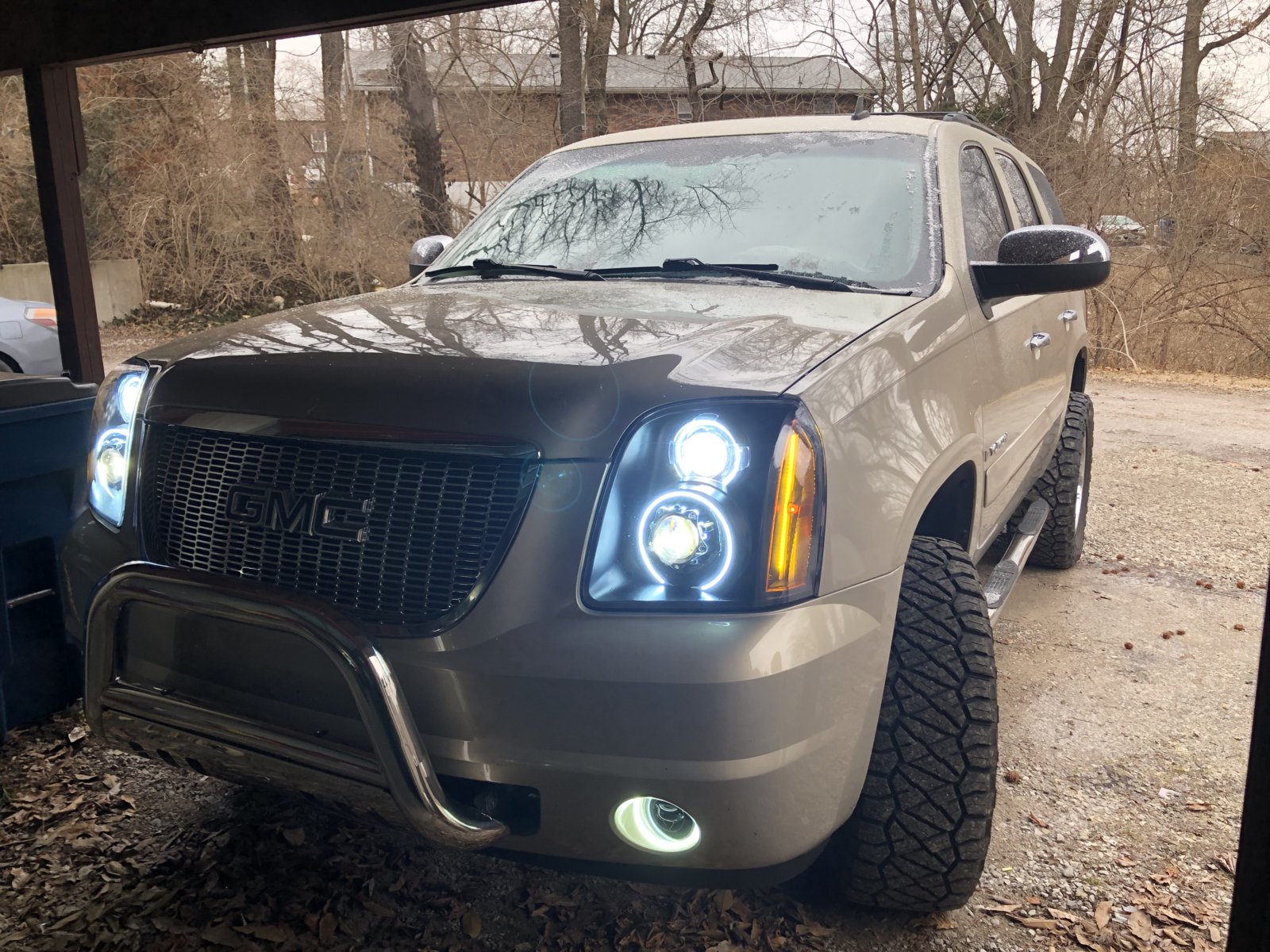

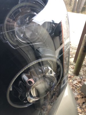

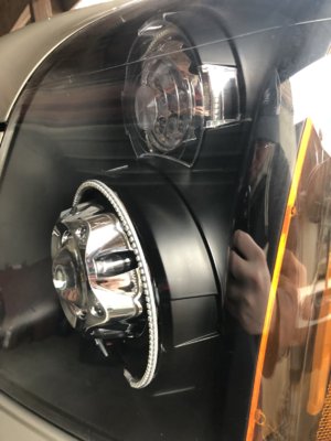

So heres some shots from this morning in the light

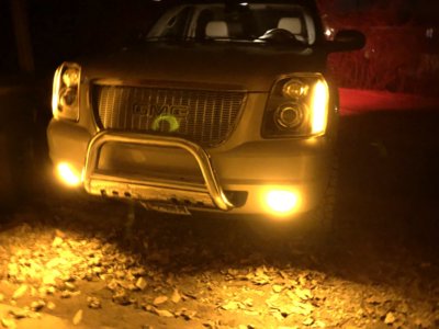

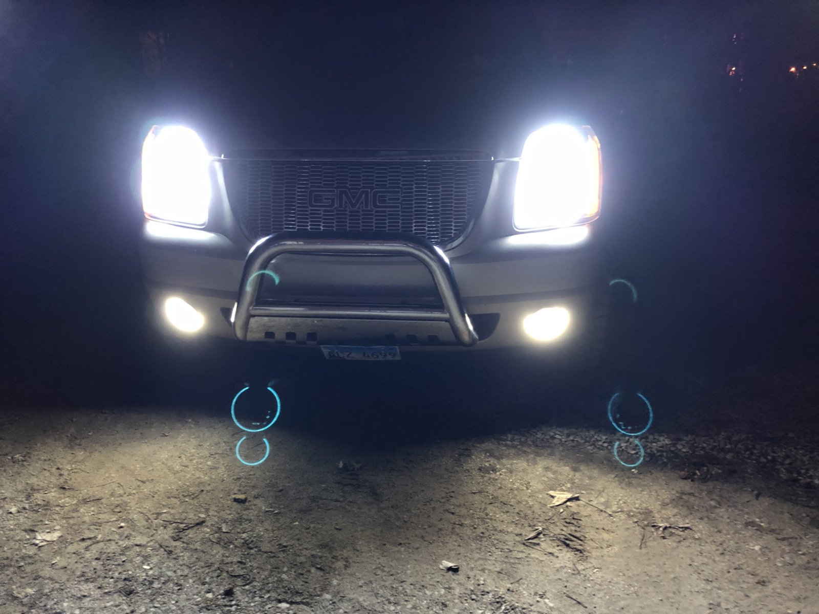

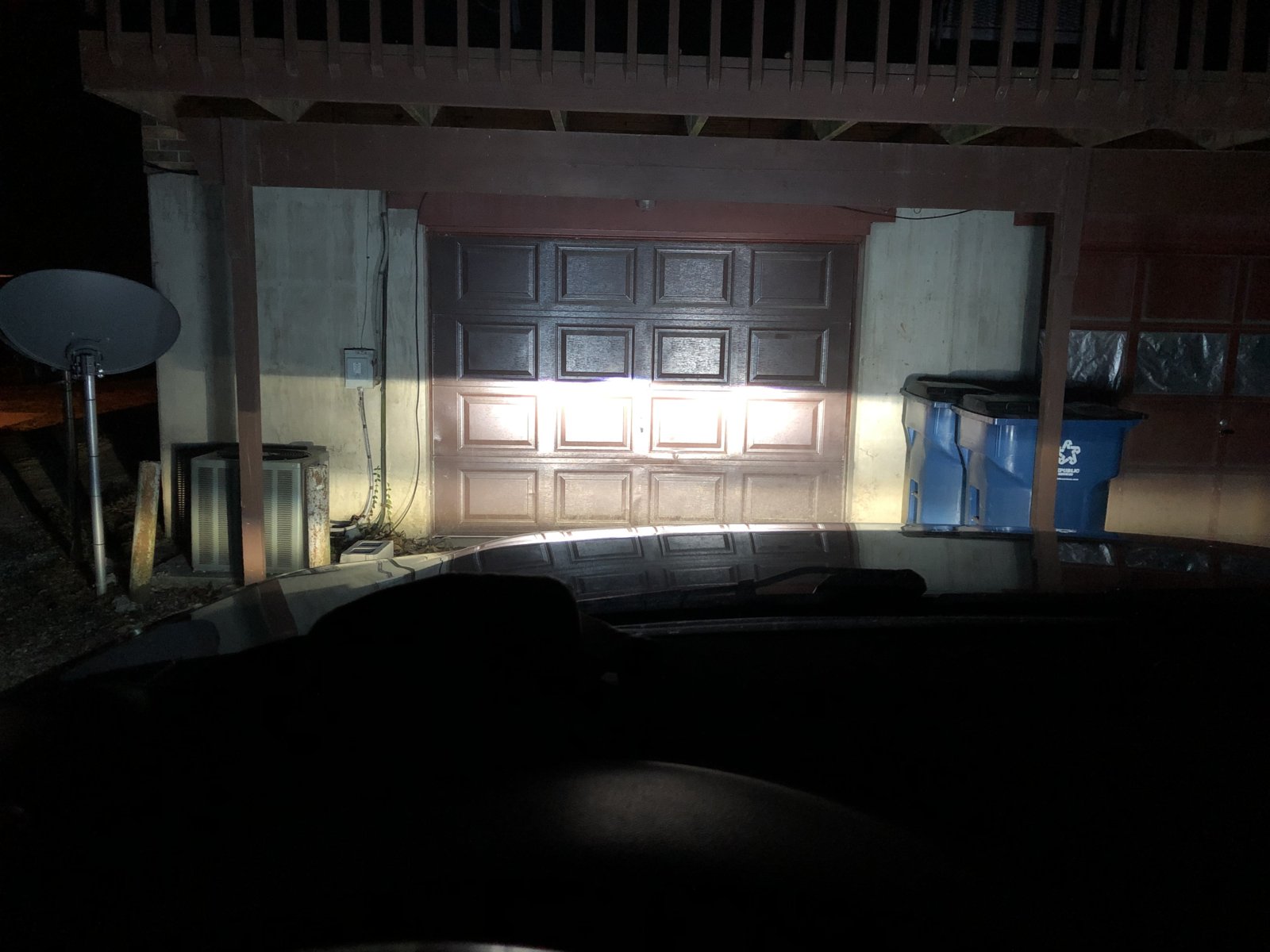

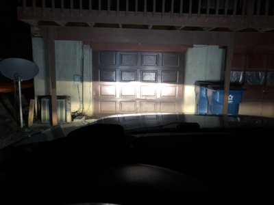

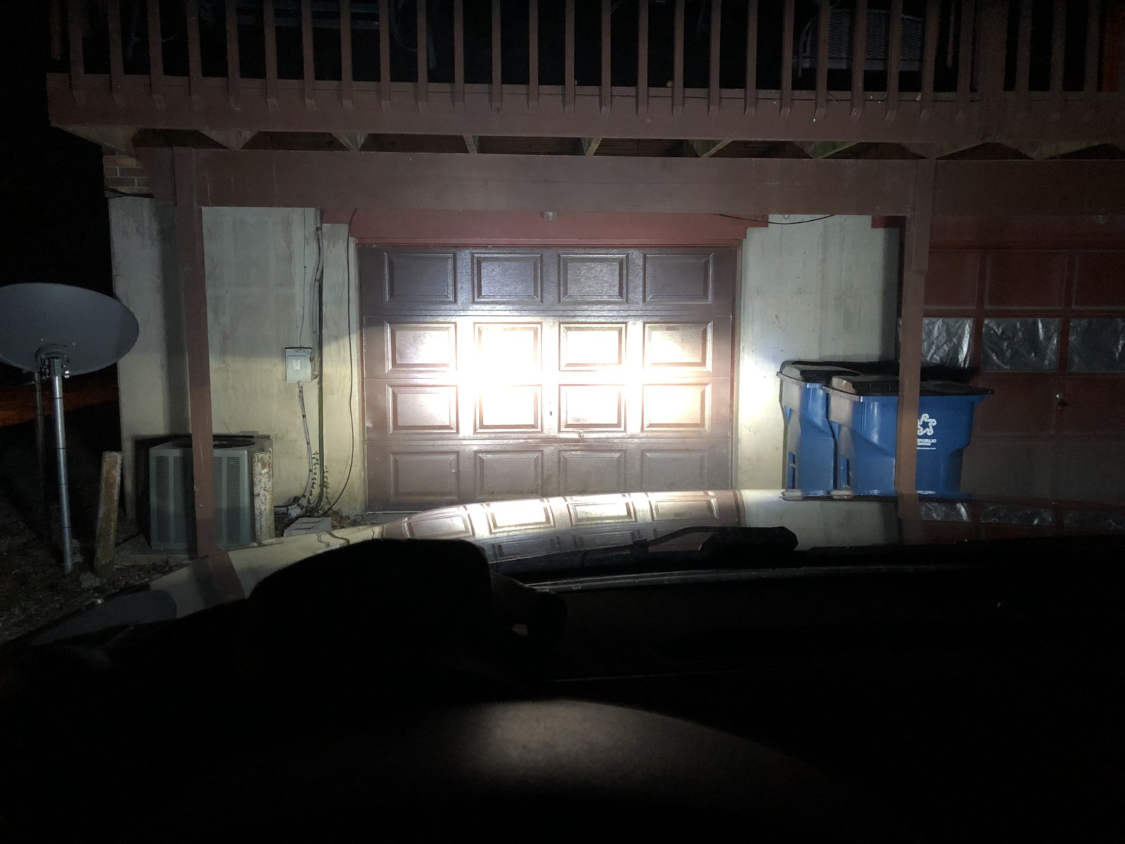

Heres some shots in the dark. Ill be on some dark back roads this weekend so i can take some actual driving pictures if you guys wanna see how the MLED look in use. They are awesome tho. I have zero regets going the LED route rather than HID.

Thank you! Yours look awesome! Id say the MLED low beams are just little less bright than yours and a little less blue in temperature. The housings are new set off ebay. I think some of you guys might call them DEPO lights? Im not sure but there were very decently priced and easy to open up. I actually almost scrapped the MLED plan as well because they just barely fit in the housings. By just barely, I mean that the projector shrouds are actually touching the clear housing plastic! But They seemed to seal back up fine and I had the theory that touching the front plastic might help ensure there's no vibrations in the projectors when I hit bumps and stuff.
I got them aimed slightly lower last weekend but only by maxing out the adjustment rods outside the housings. They are still a tad high but I don't think is worth completely opening them up the housings to remount the projectors. I finally got them all sealed good as well with no moisture in there so figured I stop while I'm ahead. Did several hours of night driving this weekend and Id say maybe one 1 in 10 cars flash me. Which isn't great but also there's tons of vehicle with stock lights that bright to many drivers in small cars. Once I get a couple months of reliable operation from these lights ill get them slightly tinted and that might just take the edge off them for oncoming traffic and would look awesome.

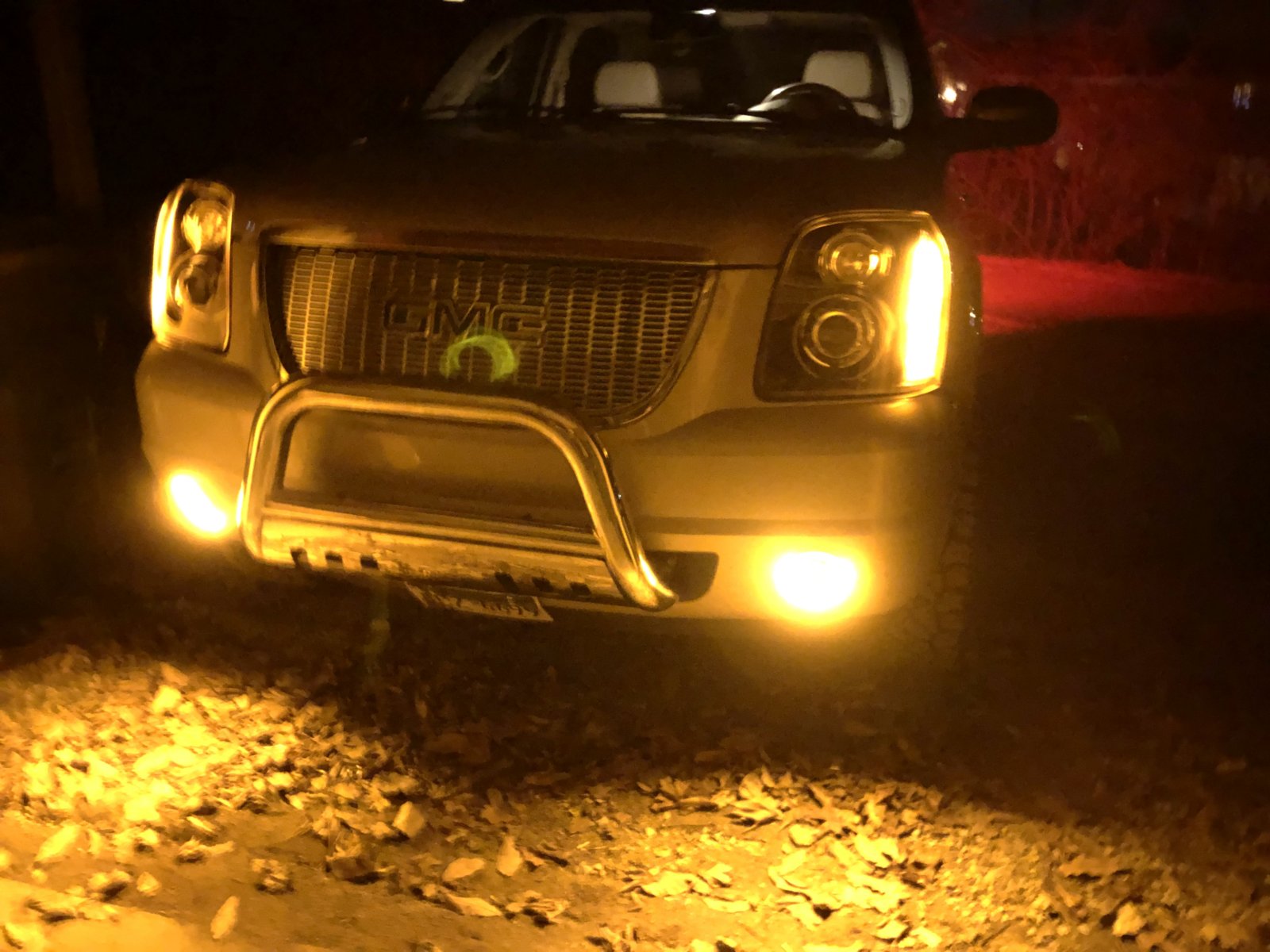

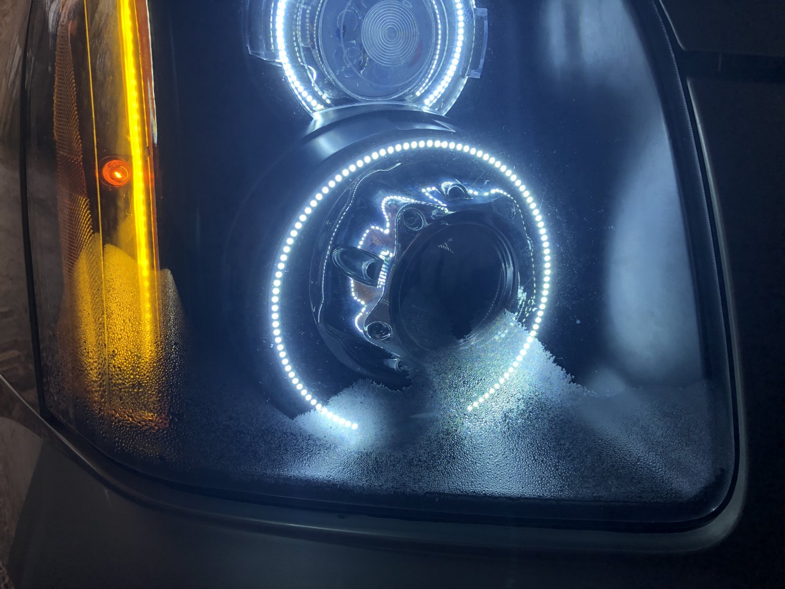

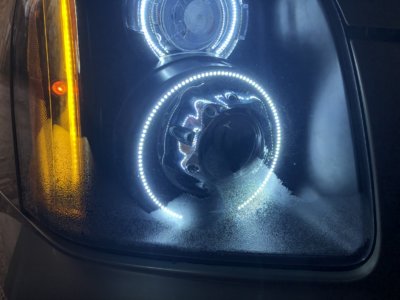

Alright and heres some driving pics. The first pic is only the fogs and halos on.
The second pic is my brights (profile projectors in addition to MLed highbeams).
The third is the MLED low beam only. They are awesome!
