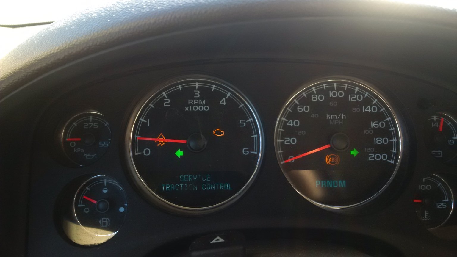

Picture of my dash, note that this was travelling home and things cutting in and out, not sitting at idle as the dash would suggest.

I had similar issues in my 08 Sierra Denali. I had two different techs at the dealership tell me negative battery cable. The both also asked if the door locks were cycling by themselves. I replaced both and my issues have not returned. I got OE my cables off eBay for less than $150 shipped for both. That's where I would start.
