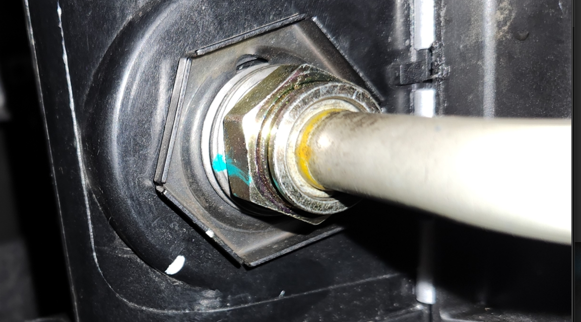

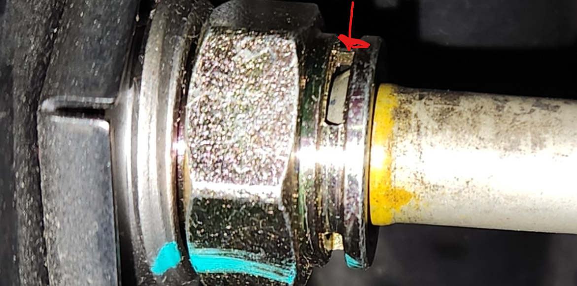

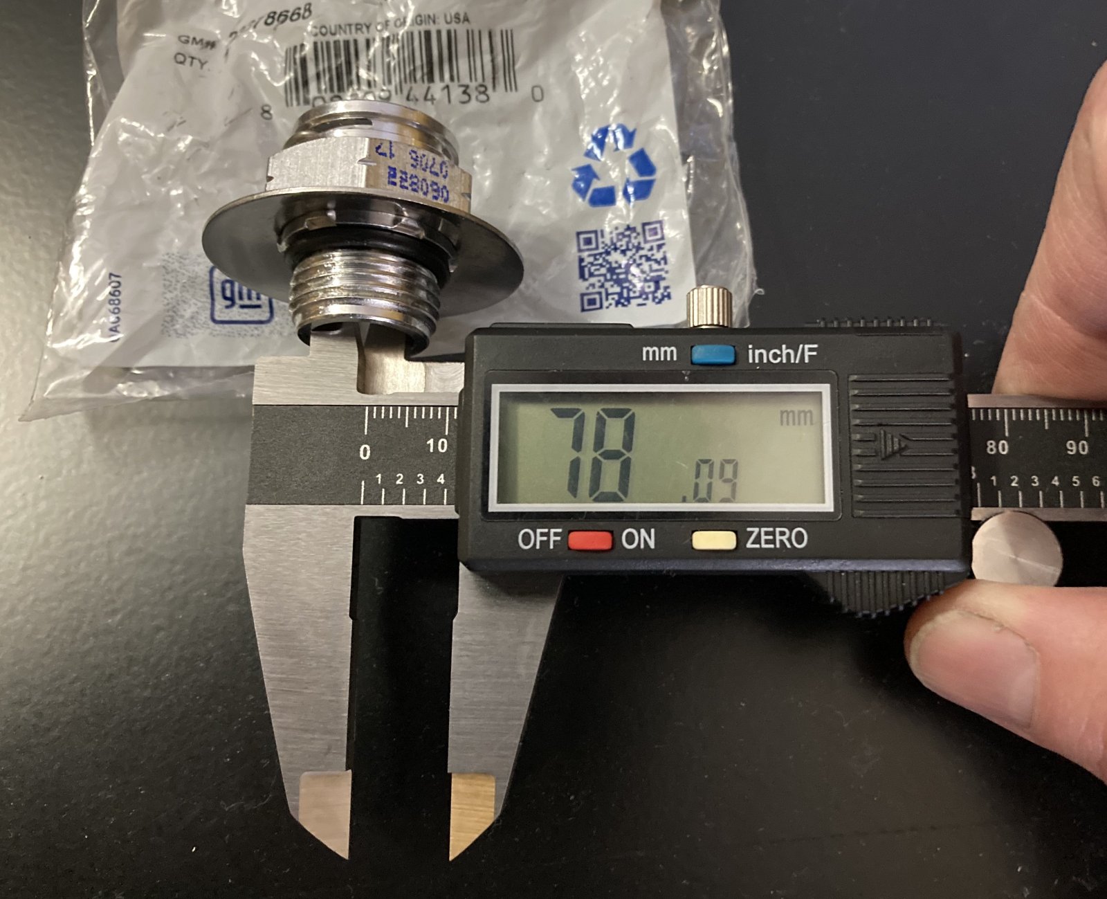

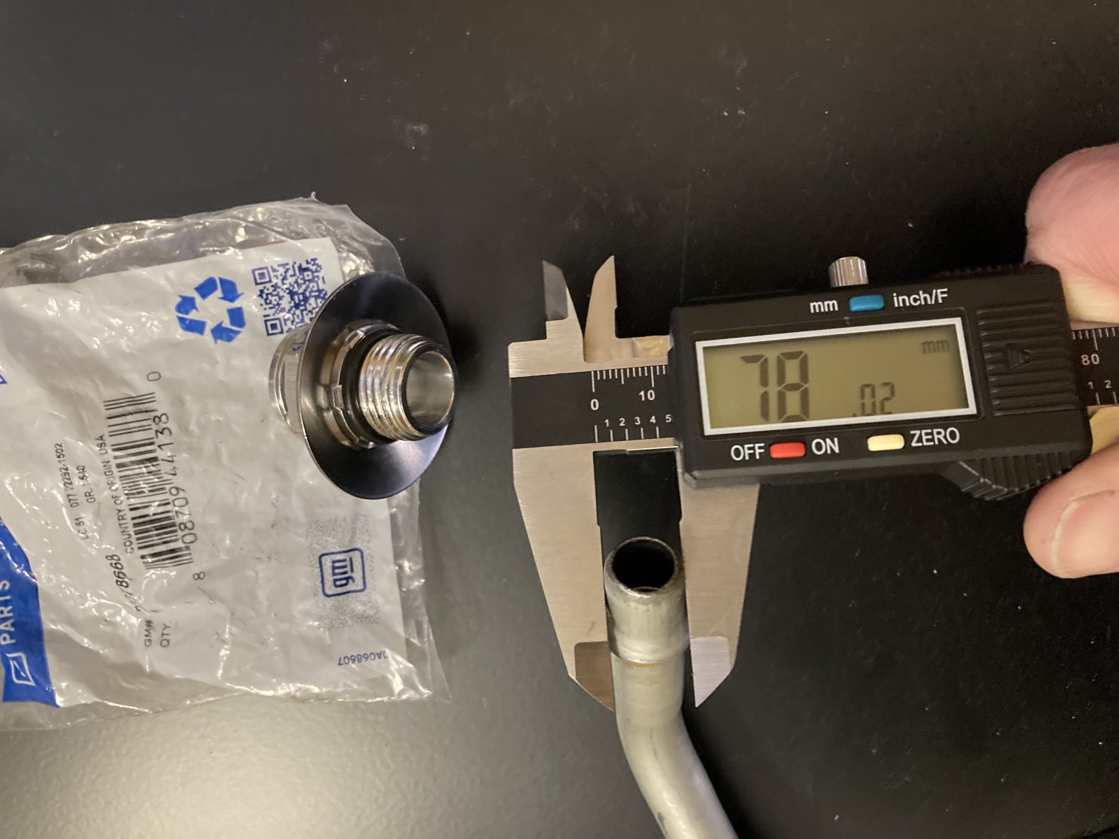

Here are some pictures of the fitting. In the first one you can see the taper on the fitting is not pushing through:

Thanks for the suggestion. I was posting pictures of the issue while you replied, so you might not have seen them.
I'll call the local autoparts store and see if they have the oil fittings. Do you know what torque these should be to (just don't want to break the plastic)?

I do not know the torque off-hand I wouldn't attempt anything over 20lbs and probably stay under that, snug should be fine
