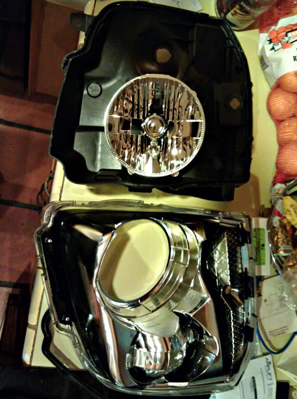

Well I got my salvaged headlights today in the mail. Gonna stick em in the oven and see if I can pop them open..
---------- Post added at 01:28 PM ---------- Previous post was at 12:35 PM ----------
Well, in that small hour since I last posted, I was able to get one open. Only had one minor oopsie as a I broke off the flange on one side. No big deal as it seems simple enough to glue back on and it is a spare. The second one should be much easier. I had to heat this one twice. On the second one, Im going to try for 265* at about 8 minutes, instead of 7 and see if its any easier. The glue was much more runny the second time around.

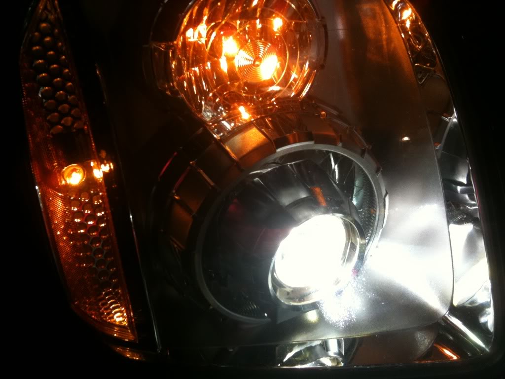

I used a TL projector with the Gatling Gun shroud since it looks like the Denali headlight bezel to start with.
soulsea
Feb 19, 2011
11,857
667,430
Bar
Yeah, the Gatling shrouds seem like they were made for NNBS trucks, they match the oem headlight lines perfectly.
edgaranah1
Jan 30, 2011
3,049
12
Corona California
I love the TL Projectors. they light up the whole highway and has one of the sharpest cutoff line.
