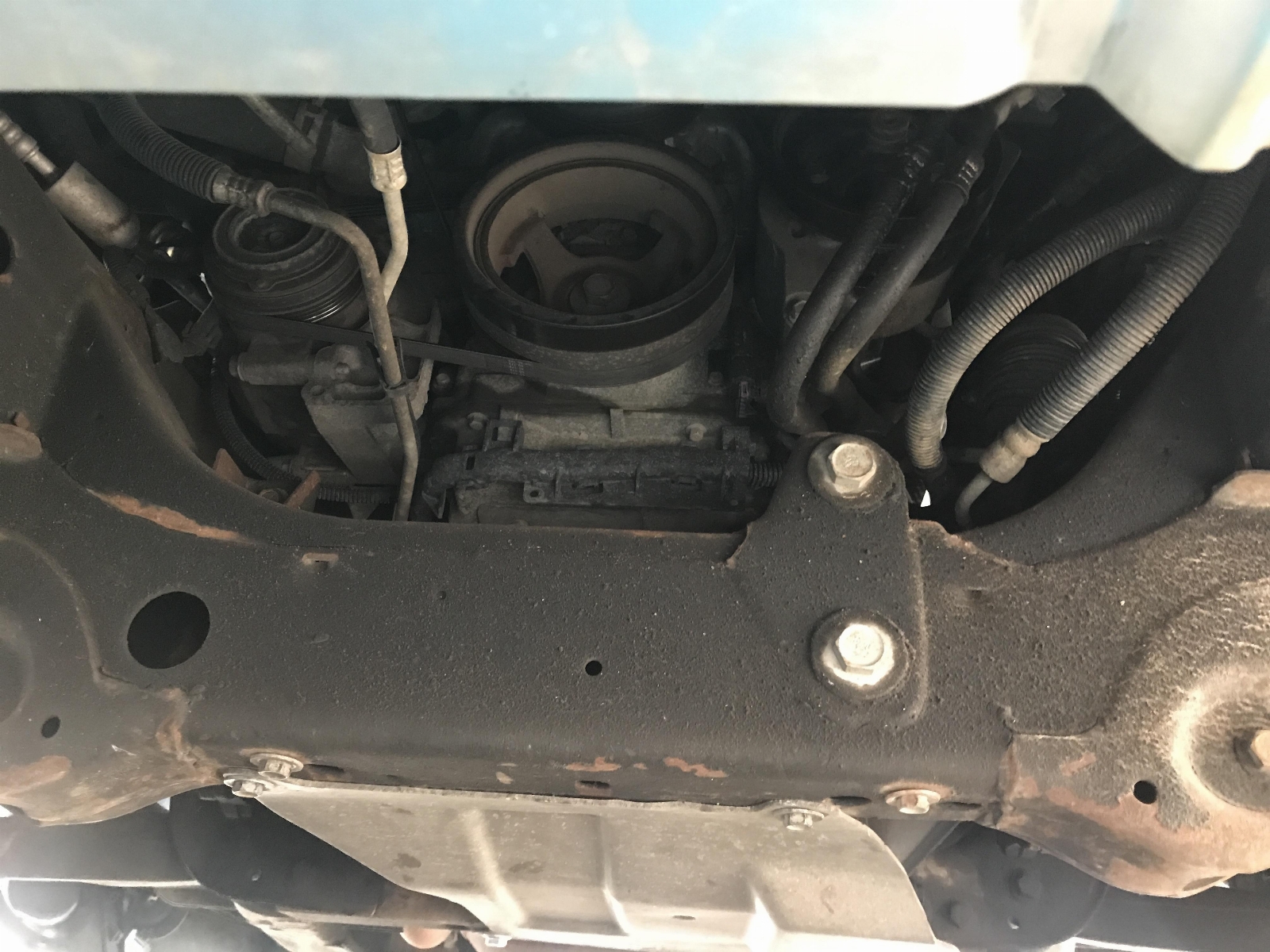

This is the first I've heard of 2 skid plates. I only have one metal one covering the oil pan area on our 2011 Z71 (which I removed the other day as it was missing some bolts - picked up some grade 8s from Home Depot as replacement, which I'll be reinstalling with a generous amount of loctite).
Where should the 2nd be located? I just looked under the truck and it seems like there might be a spot in front of the oil pan skid plate. I see a few bolts installed but aren't holding anything (and they look identical to the other skid plate bolts).

There is a plastic splash shield underneath the opening between the radiator and engine, then the metal plate that covers the front differential that you pulled and finally, there's one on the transmission cross member that protects the transfer case. I could make out part of it in the photos in the ad.

Looks like I have 2 of the 3 then. Here's pics for reference:
Tcase:
Front Diff (turns out the missing was due to a stripped nut...):
And where the missing one should be:
