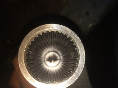

This is the front off the rear driveshaft yoke is it missing a spline

no that is the master spline. if you look on the actual shaft you should see a wide spline that it goes on to. basically there only one way to install the driveshaft
