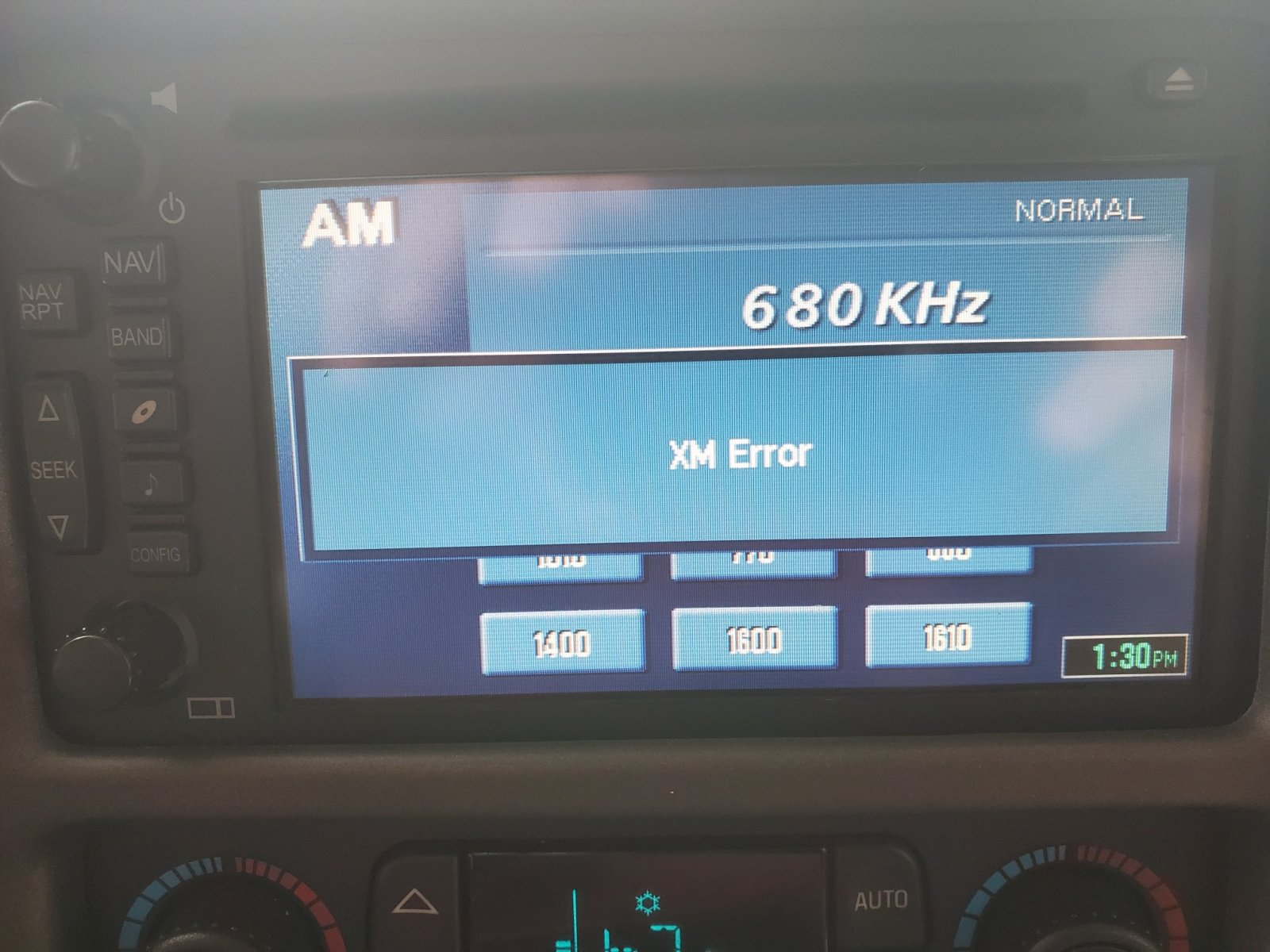

Has anyone ever got this message before, if so what did you do to fix the problem? Everything was working great yesterday and this afternoon this showed up. I shut the truck off and killed the electronics and then turned it back on and it works for about 5 seconds and the error pops up.

Get a Tech-2 or equivalent on it that can read BCM codes and you'll know what's wrong. As Wes said, it's probably the antenna or the wiring to it.

Update:
After ordering new head unit XM tuner and new projectors and the Custom brackets from Custom Brackets & Design, Factory XM is now working again after disconnecting the battery for installing the new HID projectors.
Still going to install the new unit and tuner to add the blue tooth capabilities to the truck.
