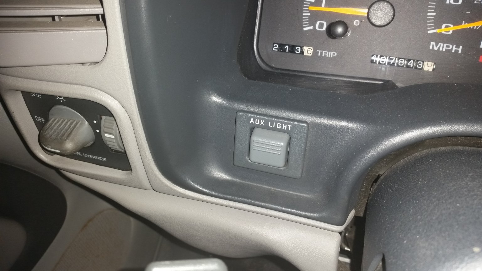

I will get some tomorrow. The switch is on the left side of the steering column and says "AUX LIGHTS". The Tahoe is a 1999 badged as an LS but the VIN comes back as a Z71. It was originally a police vehicle with full lights and systems. Pulling up the RPO codes denotes that the whelen headlight flasher and other aux wiring is all factory from Chevrolet. The one thing is that there are RPO codes that I can't seem to track down.

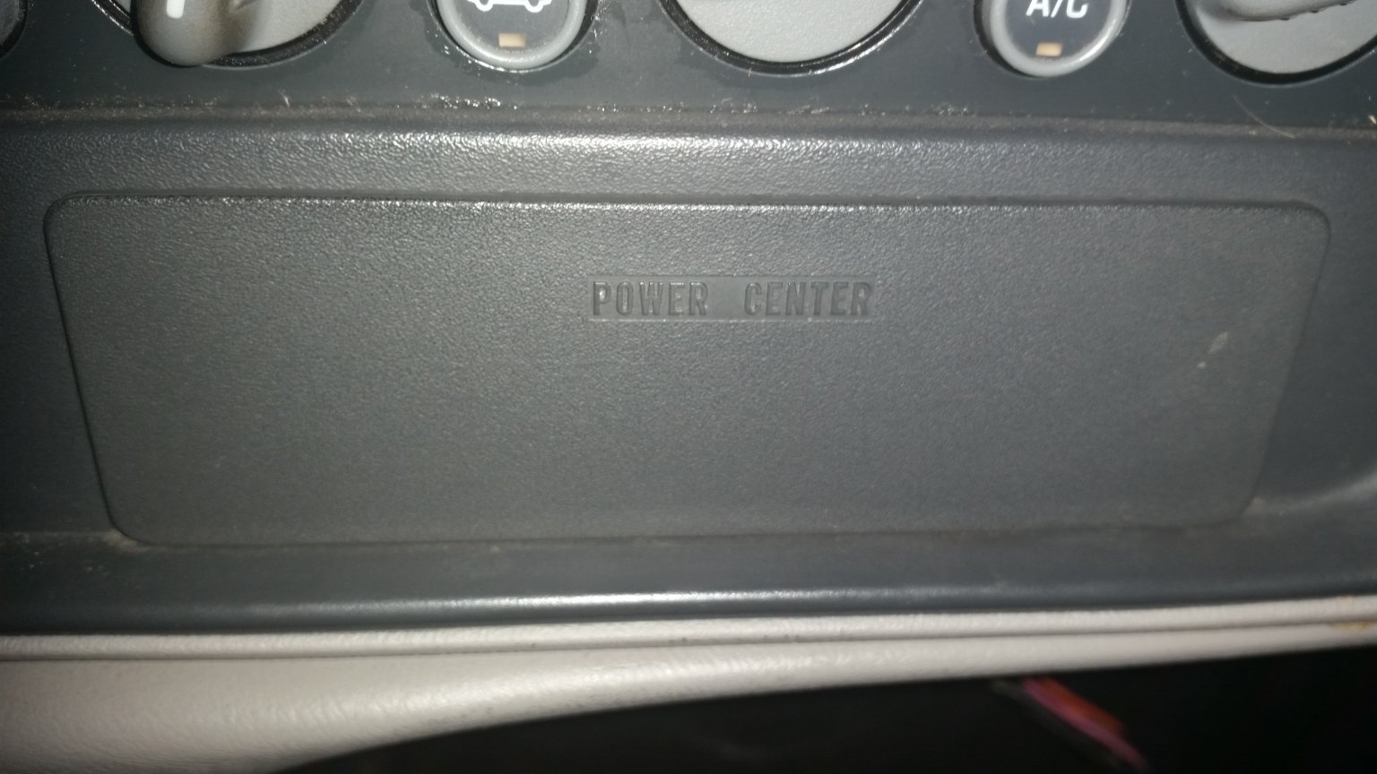

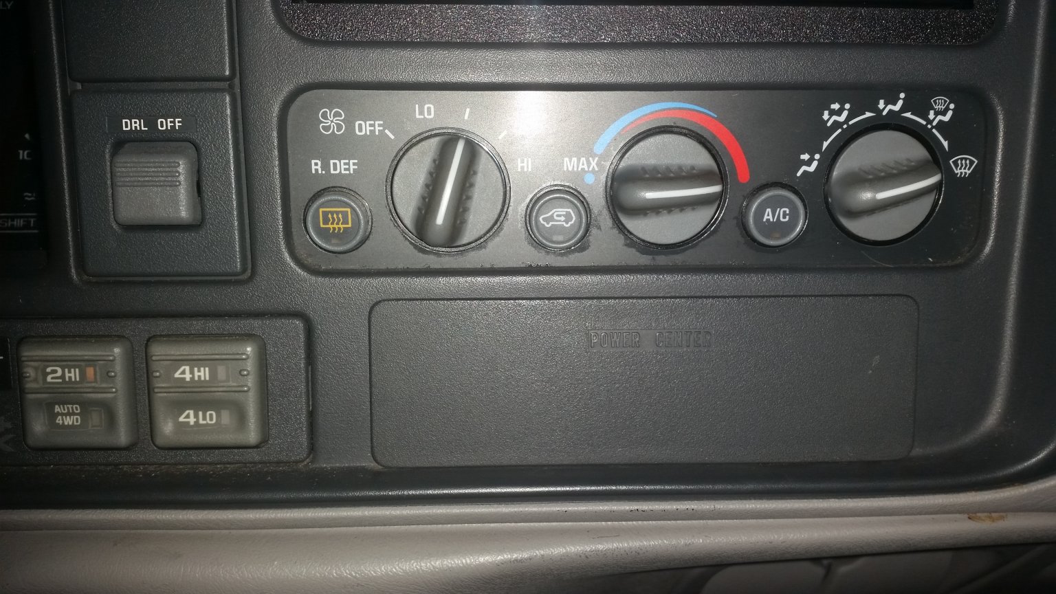

So here are a few photos of the dash, one is the AUX Lights switch and the other is of the "Power Center" which is where the cd player is from factory.
