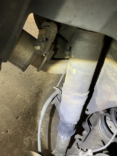

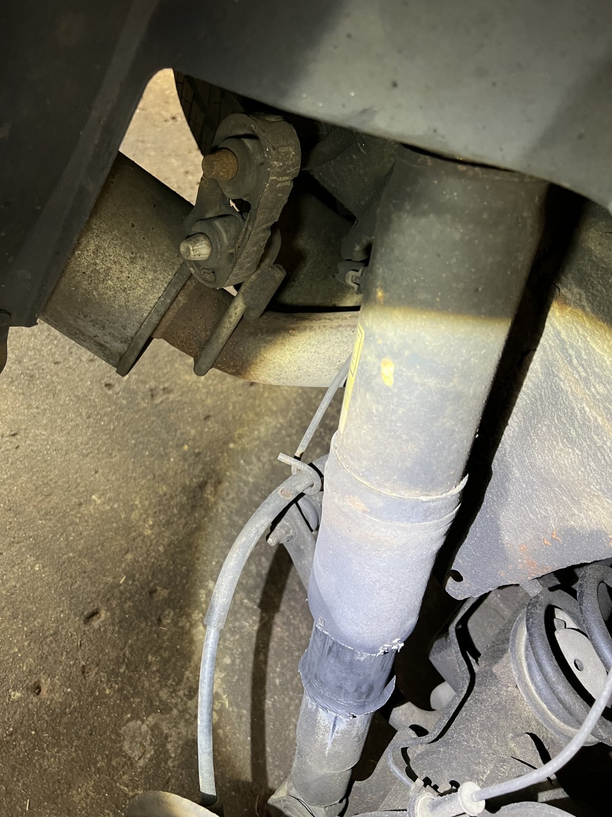

The rear air shock air bags are completely torn and the compressor does not work, but it sits just fine without the air shocks working. We almost never load much cargo or tow with this car, so I think I'm going to ignore the rear for now and focus on the front as I feel this wiggle would be from the front suspension.
