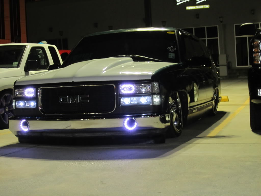

just got done mine ...took the rubber out of the body mounts then trimmed what ever hung below doors.
2lnblktop
Apr 22, 2011
This method sounds like a simple idea and looks goos on that hoe but it kinda concerns me.
---------- Post added at 12:42 PM ---------- Previous post was at 12:20 PM ----------
just finished mine
photo.php
---------- Post added at 03:02 AM ---------- Previous post was at 03:01 AM ----------
photo.php
---------- Post added at 03:03 AM ---------- Previous post was at 03:02 AM ----------
add me on facebook rob robolicious melendez
---------- Post added at 03:04 AM ---------- Previous post was at
03:03 AM ----------
http://www.facebook.com/photo.php?pid=5513973&l=1d53fa625f&id=525786172
Did you bd yours the same as they are talkin by loosin the bushings and trimming the bottom of the frame?
