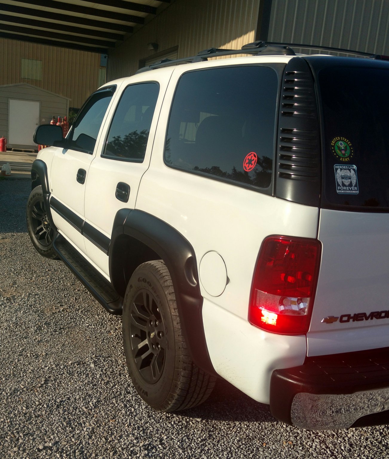

Better picture of the wheels as promised.View attachment 79801

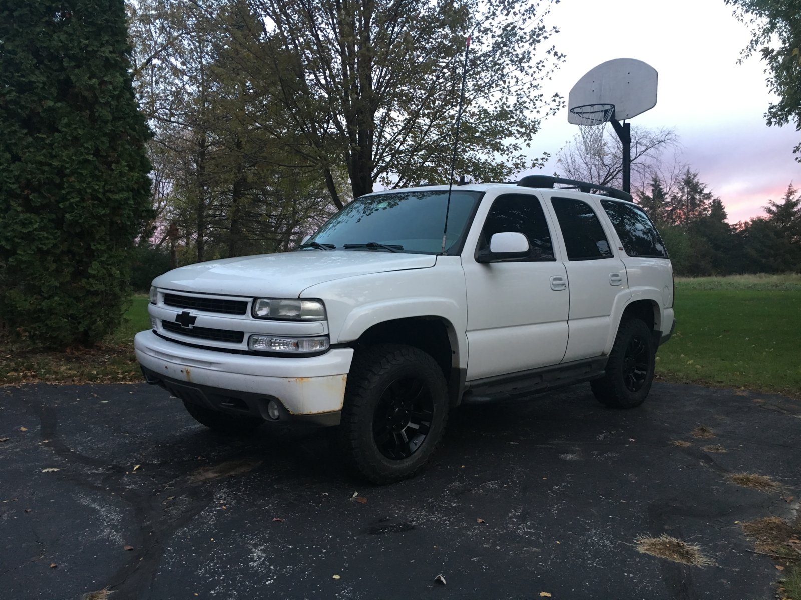

Finally got my Rough Country leveling kit installed with my 285/65/R18 BFG AT KO2's and the black painted '14 Silverado wheels

Looks great. Which RC kit did you use? Any way to have cleared those wheels /tires without it?
I got the kit for the Z71 which included rear spring spacers, all 4 shocks, and both keys. There's a lot of threads/debate on here if 285's can clear without the leveling kit. I mainly got the leveling kit because I wanted a little bit of a lift and especially wanted to level it out from that nose heavy look. The secondary reason was so that the tires would fit. Also not sure how they would fit since the '14 Silverado wheels have a 21mm offset which makes them stick out an inch more than stock Z71 wheels.

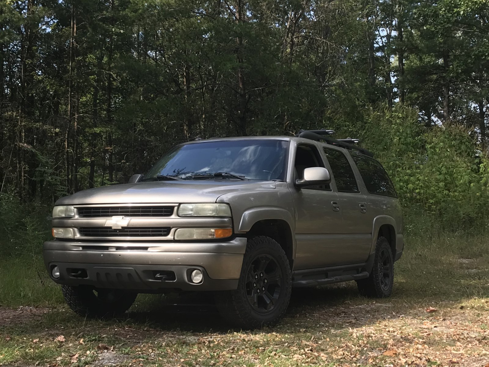

I ended up with the midnight edition z71 wheels and love them. The duratracs make some noise though. I’ll be going with Falken at3w when these are done
