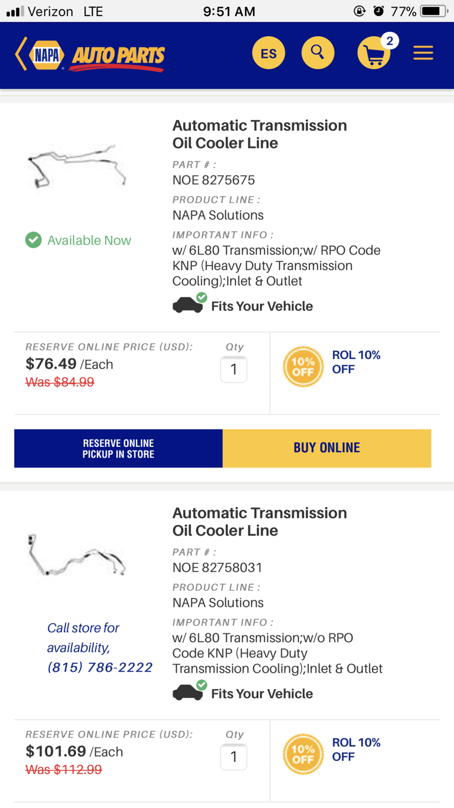

The ones that are leaking are the 2 that run up to the cooler. I’m confused about the with or without rpo code
1 has a trans cooler, the other doesnt. Look in your glovebox for rpo codes
Better yet tell me, do you have a trailer brake controller, from the factory, by your left knee?
