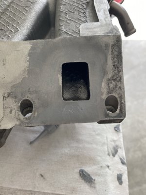

I am in the process of installing the MPFI Spider upgrade this week. I have the latest Felpro intake gaskets, and new Felpro bolts. When I pulled the lower intake, I noted extreme corrosion pitting at the coolant port gasket surface. I soaked the lower intake in a hot tank parts washer, and media blasted the corrosion. I am building up the surface with Metal Set A4 epoxy.

Nice smoove surface now! Hope you Alodined' it before epoxy. It will probably last long enough even without it, because you blasted it clean.
