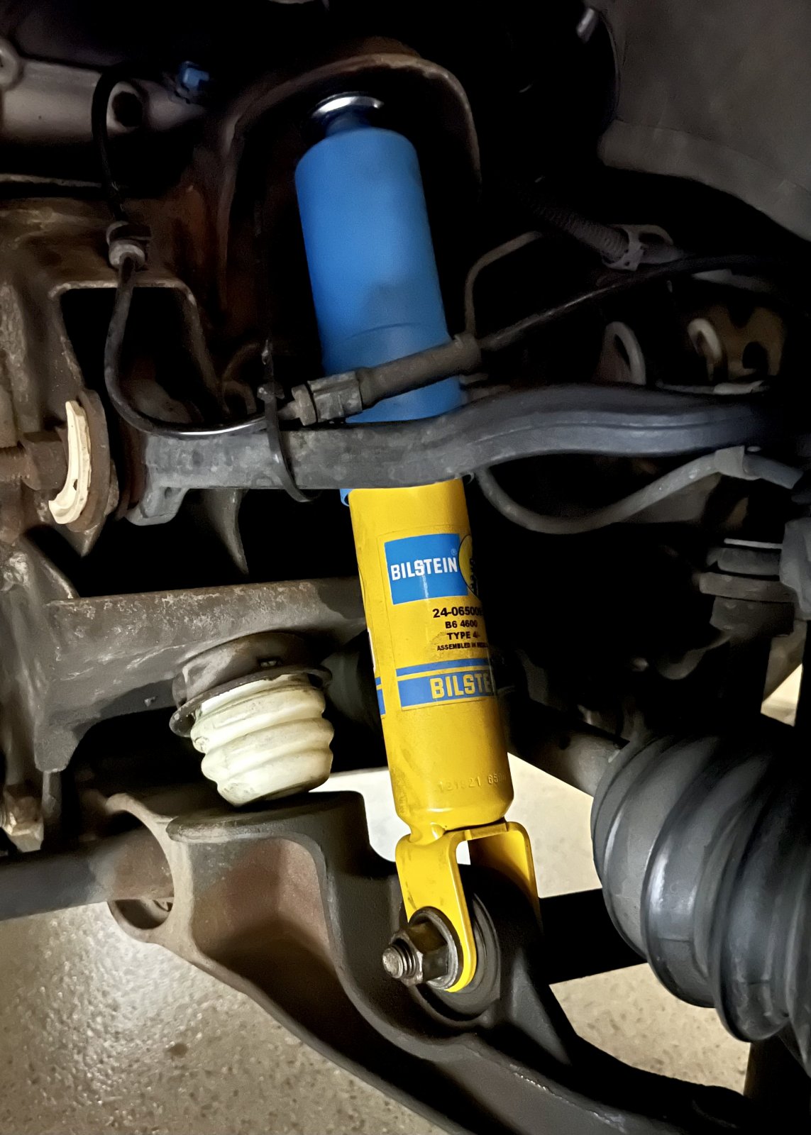

Can’t go wrong with Bilstein B6-4600 for stock OEM neutral lift and general riding around on a mix of highways, streets, fire roads and double-track. There are a lot of good options but I think this is best bang for the buck. Less than $100 each.
