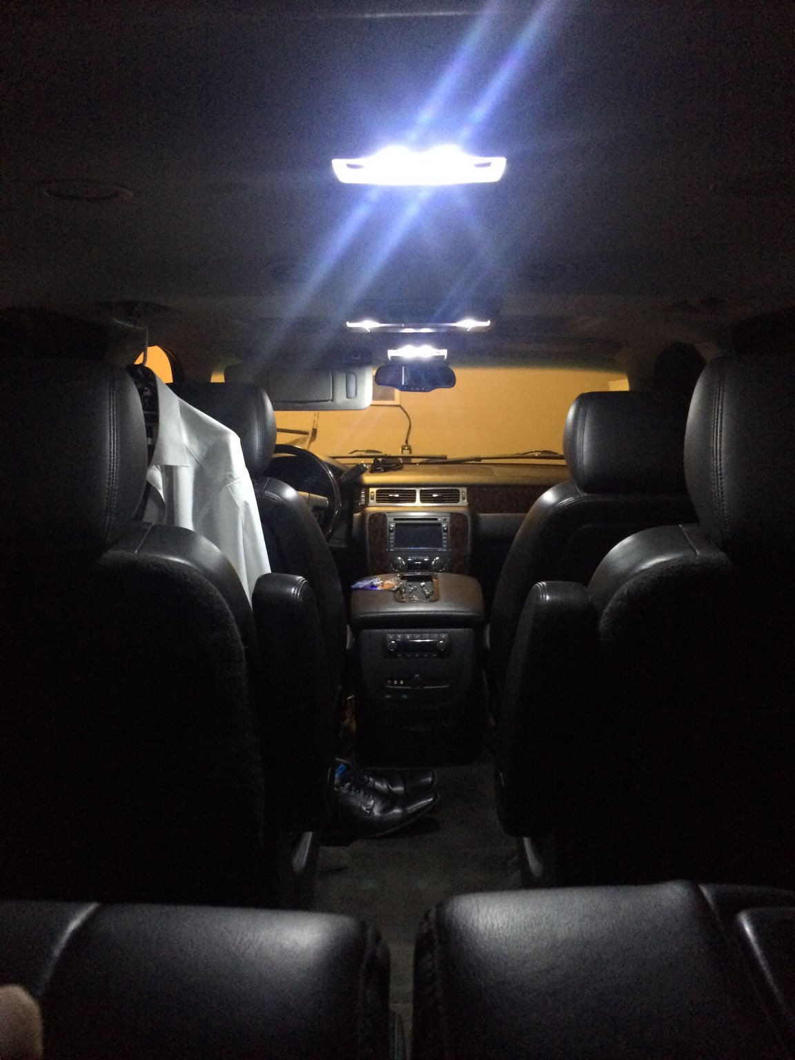

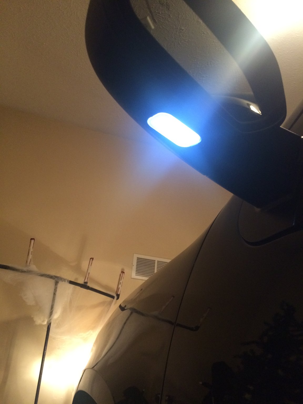

I attached interior LED and the puddle light LEDs that I installed tonight. Took me 15 min to install. Super easy. (Ignore the Halloween Decorations in my garage haha)
Esky taillights installing Friday, and 5% tint all the way around (I have 20% all the way around now). 24" wheels coming next month.

thats a lot of spider webs...your spider man aren't you !!! :D

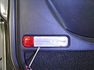

you can just run a wire from the interior light harness at the drivers side kickpanel thru the rubber boot in the doors and then just ground the other end to the door.
when you unlock the door with the fob the puddle lights will come on same as the interior lights or when you open the door, etc. you can add turn signal mirrors the same way.
I would splice into the door courtesy lights . No fishing through boots.
