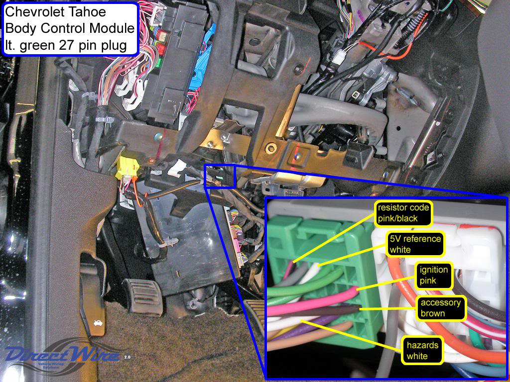

i have a 2010 tahoe and i am putting in a high output alternator and i need to find a place to tie into my fuse box that will act as a remote turn on for the alternator. Which one can i use?! It needs to be something like a cigarette lighter fuse or something of the sort that turns on and off with the ignition, when i look at all the different spots i don't know what the abbreviations mean.

Fuse taps are horrible. It's best to use the pink ignition wire that is on the green harness on the BCM.
