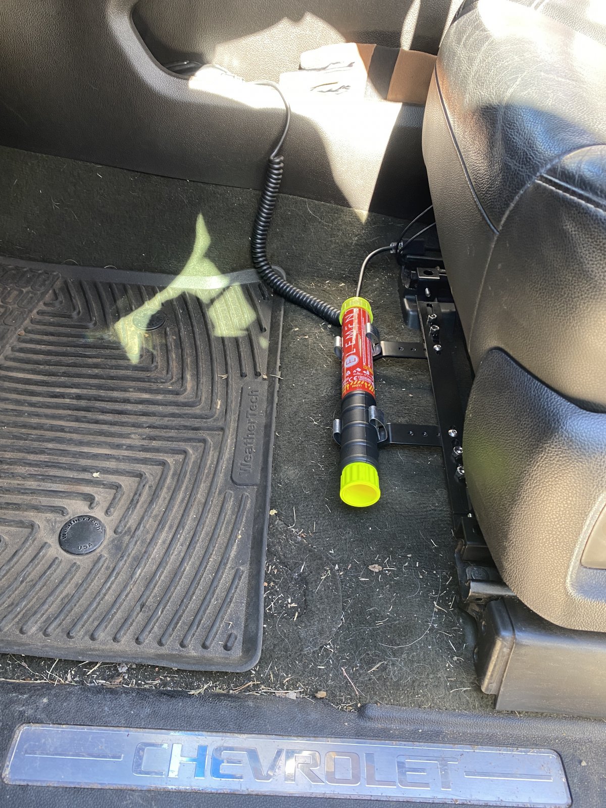

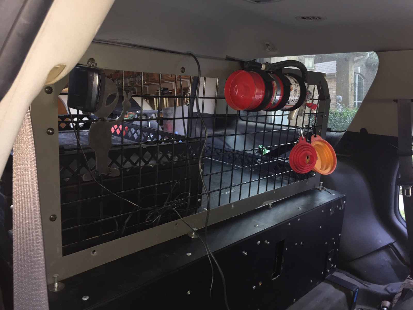

Where they fit.
In thecopcar. 5# dry chemical.
In thethirdtwin. Element.

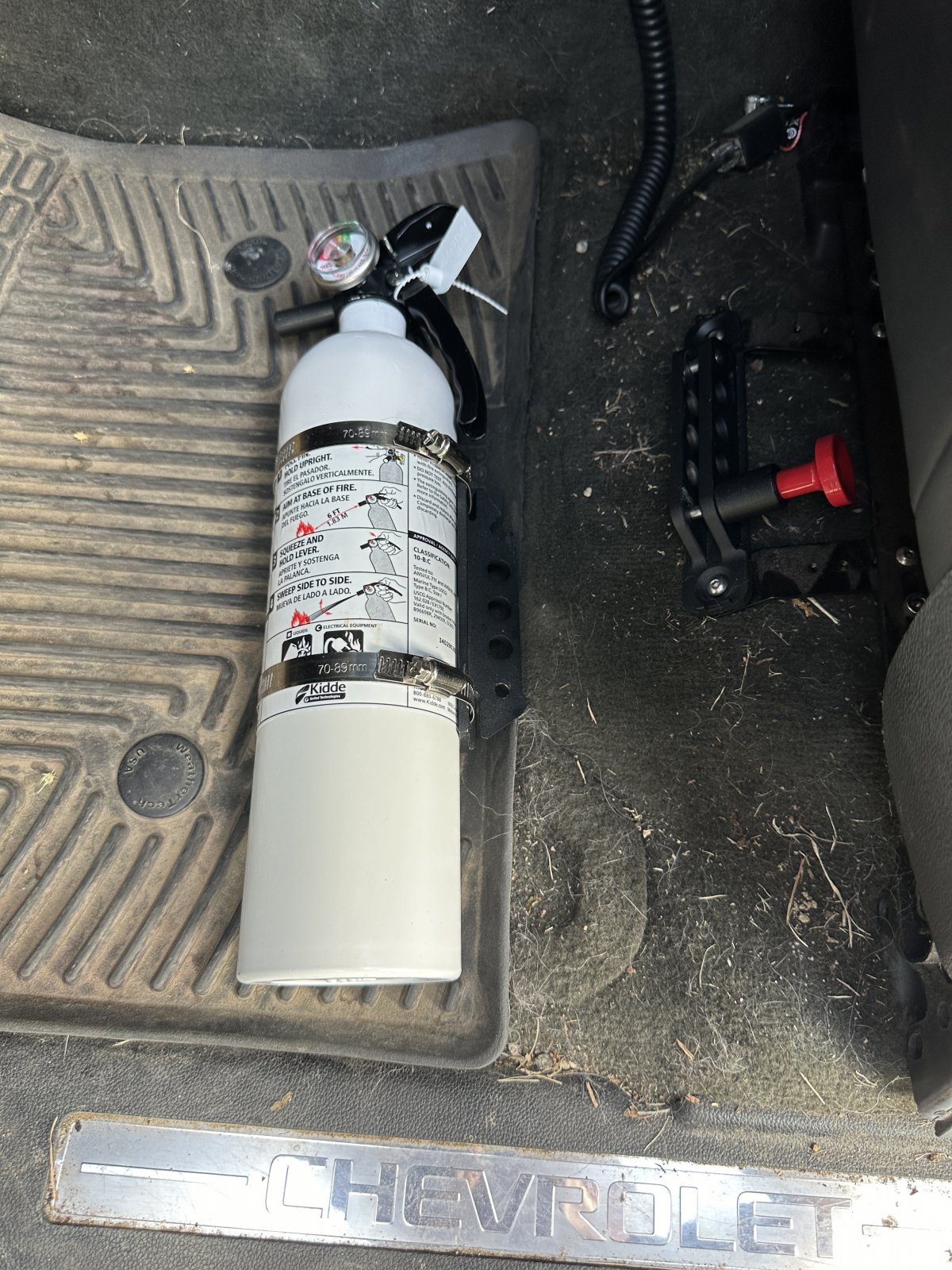

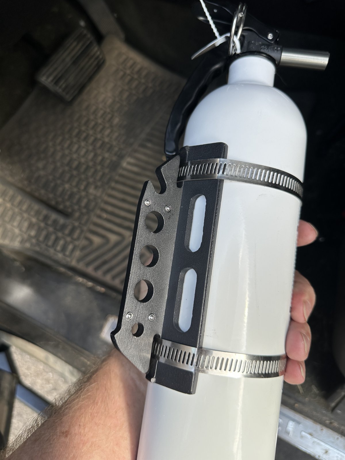

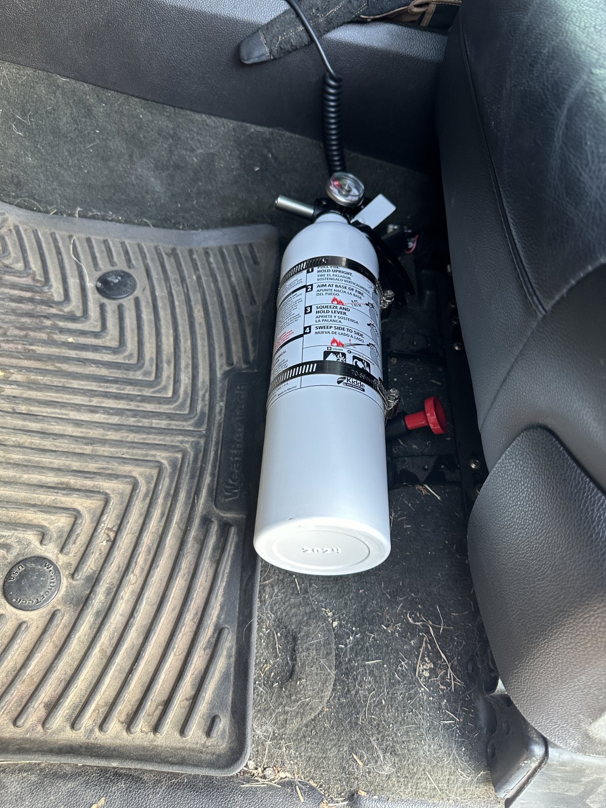

Even before @Doubeleive brought up concerns about how close you apparently have to be with an Element, I had decided on a supplemental unit.
A Kidde 4# BC unit and quick release bracket mounted to the Bracketeer mount I already had.
The Element is now in a door pocket.

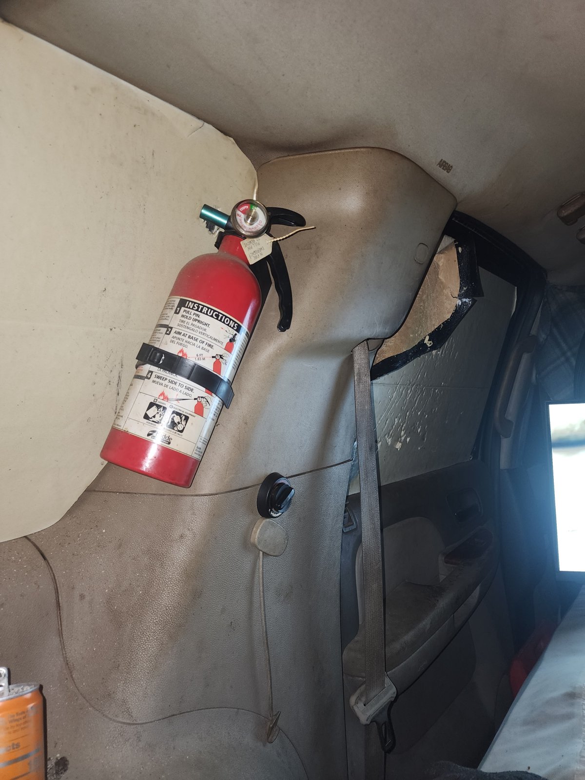

I had a white one like that for years until I checked it one day random and saw it was no longer charged, the fire department at one time here would exchange them for a recharged one at no cost but they stopped doing that i guess

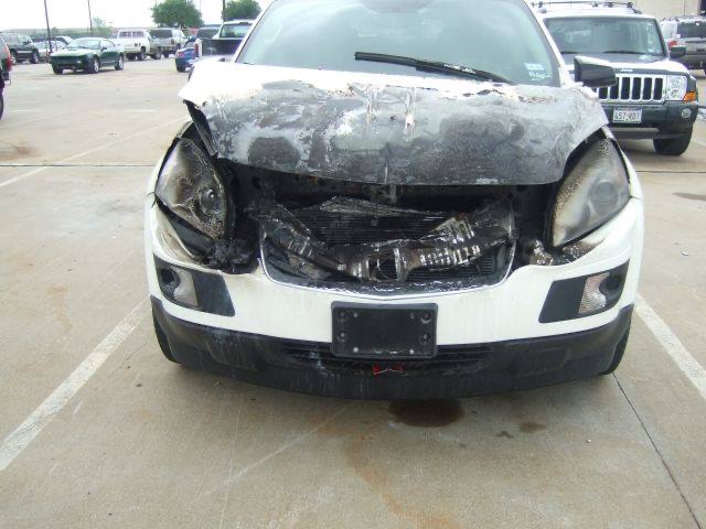

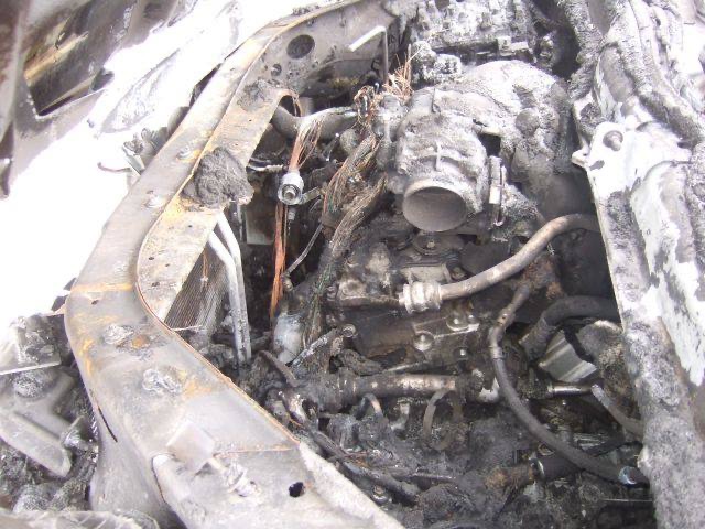

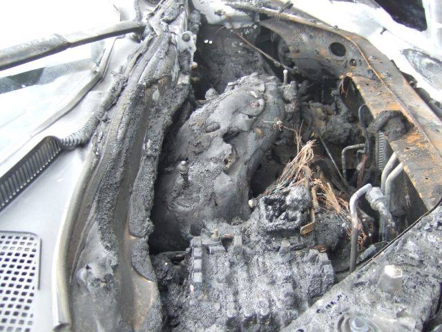

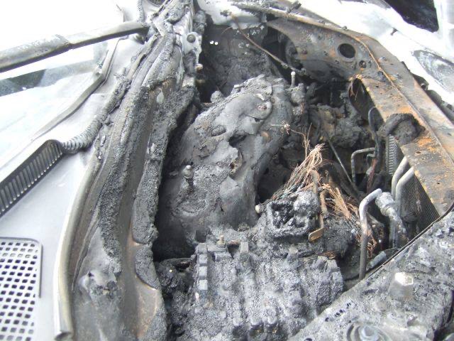

Getting to a fire early is the key. I had a first year Saturn Outlook. One with the washer reservoir heater. Sucker caught fire while I was driving it. By the time I could get stopped the hood release had burned through.
I emptied a 5# extinguisher through the grill. A guy at the gas station next door emptied a 10#. A trucker in the same parking lot also emptied a 10#.
In the end it didn’t matter.
Need to also carry a 5 foot pry bar to force open the hood when the hood release doesn't work

How do you like the "Bracketeer Mount?". I've got a 2006 Tahoe, which mainly lives on trails / off road. Is it super secure? I've been debating making my own but has just been an excuse to put of the project. I should just get an off the shelf solution...

Given the option, I wouldn’t want to use a traditional extinguisher on fuel spill as the “blast” just pushes the fuel around to larger areas. And knowing I have the Element to tackle both fuel and electrical fires is peace of mind.
That's why they sell extinguishers rated for fuel, Class B. I carry ABC extinguishers in my vehicles; A (combustibles) and C (electrical) are worth having, hence ABC extinguishers.

The bracket works well. The only issue I have is if I move the seat too far forward it bumps the bracket off the seat rails. I’ve adjusted the preset back just a bit and avoid the issue.
Knowing that a fire has to breathe pointing the extinguisher nozzle at the base of the fire will actually “suck” the retardant into the heart of the fire and extinguish it quickly. In your case there was no way to extinguish the fire. It was enclosed in the engine bay and drawing air from underneath the vehicle. Nice try though.
