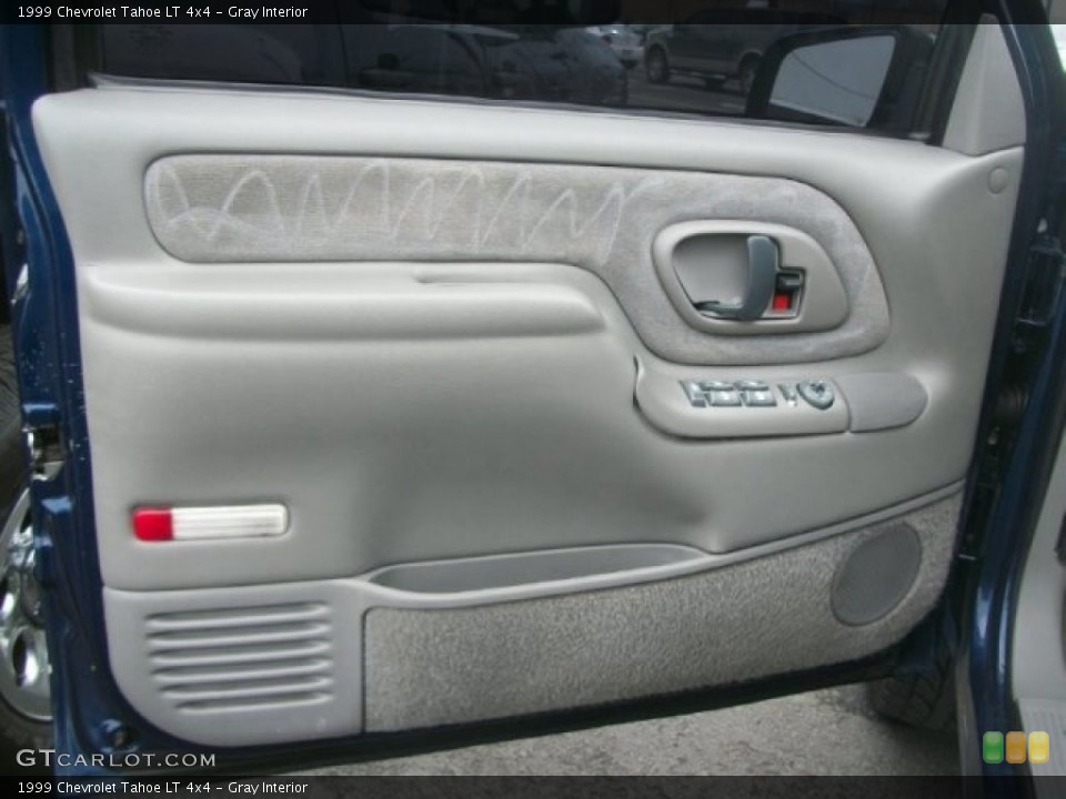

I have a 2000 Yukon Denali with the Bose system. The owner's manual says there are six Bose Acoustimas speakers plus the subwoofer but I can only see 4, two in the bottom of the front doors and two in the rear doors. I am assuming that the missing two speakers are tweeters located somewhere up front but for the life of me I can't see or hear them. A photo of the front door is attached and although they are not shown there are no visible speakers on the windshield posts.

I'm not 100% sure, but usually in that body style I though they were on the door just in front of the mirror buttons (on your wood grain) like this...

I have taken that door panel off a couple of times to replace the window motor and the lock actuator and I'm pretty sure I didn't see another speaker including on the area near the wood grain mirror/window buttons.

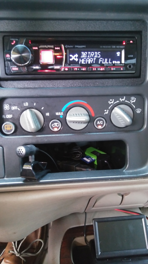

Thanks for the reply and the information Stick. If the picture below leads to any questions I'd be happy to answer them.
That is an Alpine CDE-148BT head unit ($189) with bluetooth, a replacement pocket for the Bose single disc CD player which holds my wired microphone and the head unit's USB cable with a SD card reader and 32gb card. I love the head unit's Pandora feature as if the source is set to that option it connects and starts playing my current channel about 20 seconds after starting the Yukon. It also has HD radio, USB, aux inputs and has a single disc CD player supporting mp3 and wma files. It doesn't play audio DVDs though.
I put nice Alpine 6.5" type R speakers ($120) up front, Alpine type S ($65) in the passenger area, and replaced the fake Bose 4x10" speakers in the rear (they were actually 3.5" round paper speakers on a 4x10" metal plate!) with some Kenwood honest-to-goodness 4x10s ($55) as I couldn't find Alpines in that size. I spent about $400 altogether mostly at Crutchfield as I used a Metra integration kit to tie into the existing Bose amp and I left in the subwoofer but basically turned it off on the head unit and with the Alpine TuneIt apps 9 band equalizer.
The system sounds great and the bluetooth phone functions and sound quality have so far been excellent. Since I didn't mess with the center console to change the amp or subwoofer it only took a couple hours to install everything including a small back up camera (only $30 on amazon but nice video quality) which is shown at the bottom of the picture.
