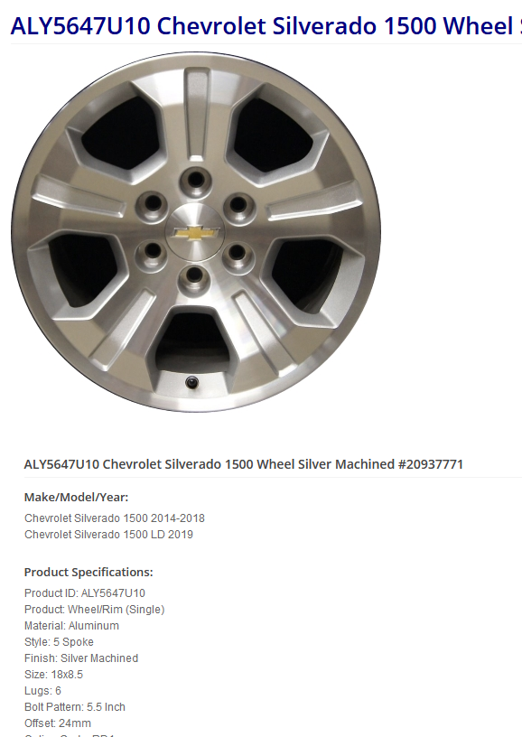

I run 18x8.5" 2015 Silverado wheels on my '04, with a 24mm offset and 265/65 tires so the tire circumference is close to the 16" OE setup. I think your '0' offset is going to stick out too far. My OE 16x7 wheels had a 31mm offset.

So I played a little around with that wheels size calculator and I think a 9" wide would be a very tight fit, or it would exceed the wheel well. He likes that aftermarket look, so OEM wheels are not an option unfortunately, but thanks.
