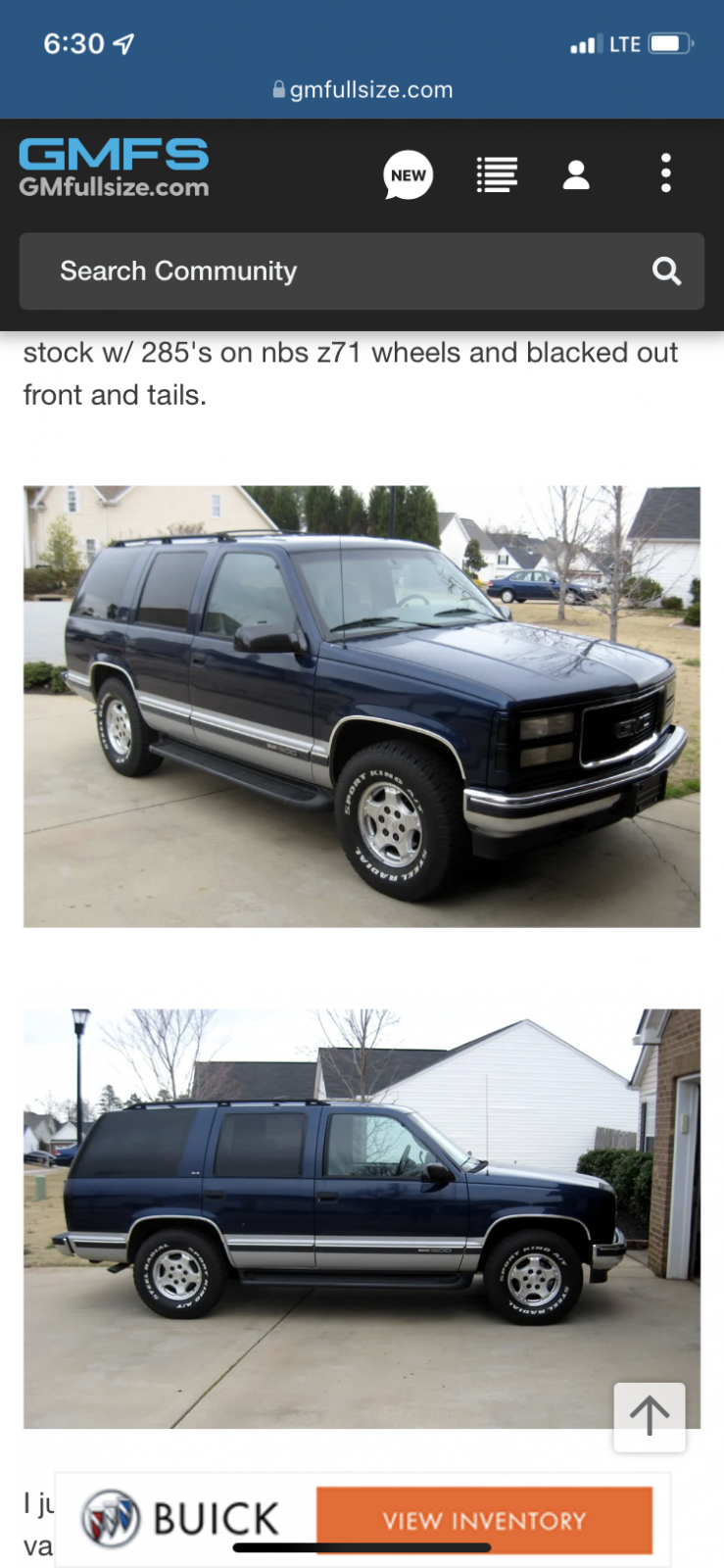

The six lug pattern is the same for the subsequent 99-06 Silverado (GMT800 platform) and is a common swap. Later years are probably the same.
From a random search, rims from a 99-02 (plus or minus) Silverado:

This Yukon came with 245's will I have any problems if I go up to 265's?
east302
Dec 21, 2016
1,686
1,681
Mississippi
265/75/16 was a factory option so no issues there.
You can fit most 285/75/16 on them as well (BFG AT for example).
For different rim sizes, compare overall tire diameter.
