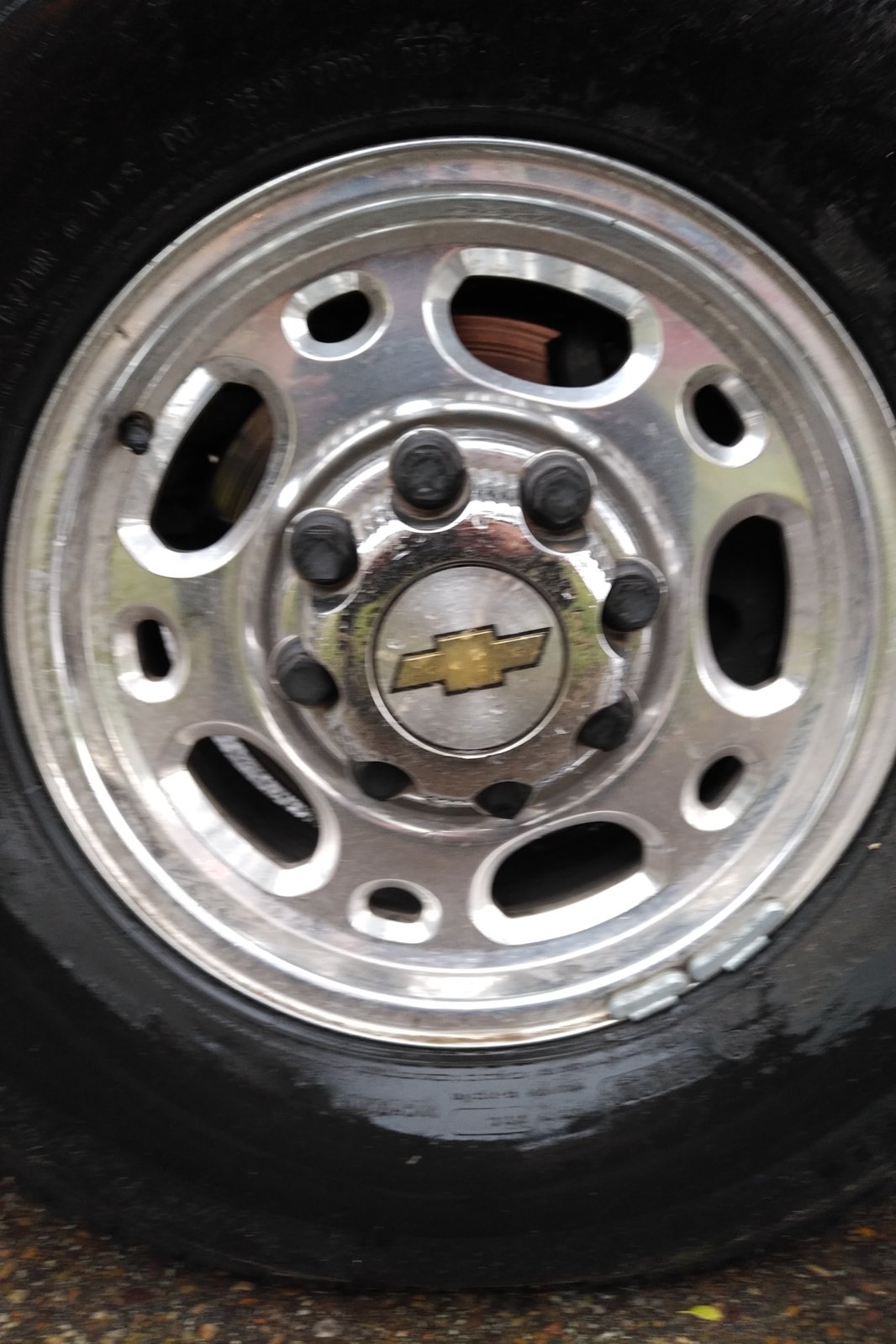

These are my oem wheels. The specs I posted earlier are the ones I got from call Discount Tire. I am in no way knowledgeable with regards to backspacing and offset which is why I asked for assistance. The specifications on the rims that were gifted to me are from the manufacturer website. That being said, in theory, the gifted set should fit and I do not need to re-gear, correct?
adriver
Aug 18, 2018
787
477
No, you won't need to regear, but you will notice a slight loss in acceleration. I see those OEM wheels weigh in at 25lbs, and the new wheels are 33 lbs (first and only weight I saw that I'm going off). Then a larger tire is going to be several pounds more. You're going from roughly 50 lbs per corner to roughly 65 lbs.
