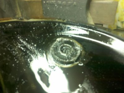

OK, pulled the rear diff cover and everything appears intact. Ran a magnet around the bottom of the pan and then dug my hand in there and found nothing. In the picture you can see metal shavings have collected on the diff cover magnet, but that's 220k miles later because it appears that the gasket is original and the rear-end looks stock and untouched.
Could those shavings be the root of my problem or do I need to look elsewhere?
Thanks again for all your help...
