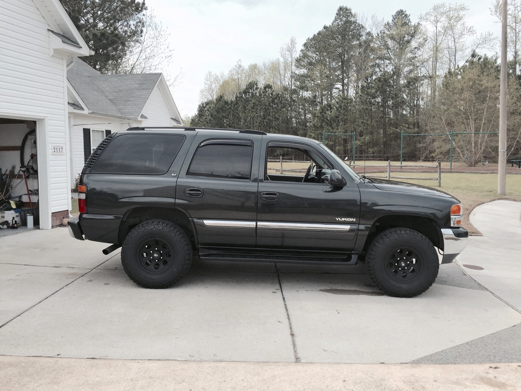

I prefer smaller wheels as well. Better for offroading and cheaper for tires.
I'm running 16x8 with 285/75 MTs. Just look at my sig for details

I did 2.5" torsion lift with 1.5" rear spacer and went from 265 to 285 tires (almost 33") I did a pro comp 7069 16x8" wheel rides great

The 285/75/16 isn't rubbing? Did you don't any mods or just swap it with your stock size tires?
