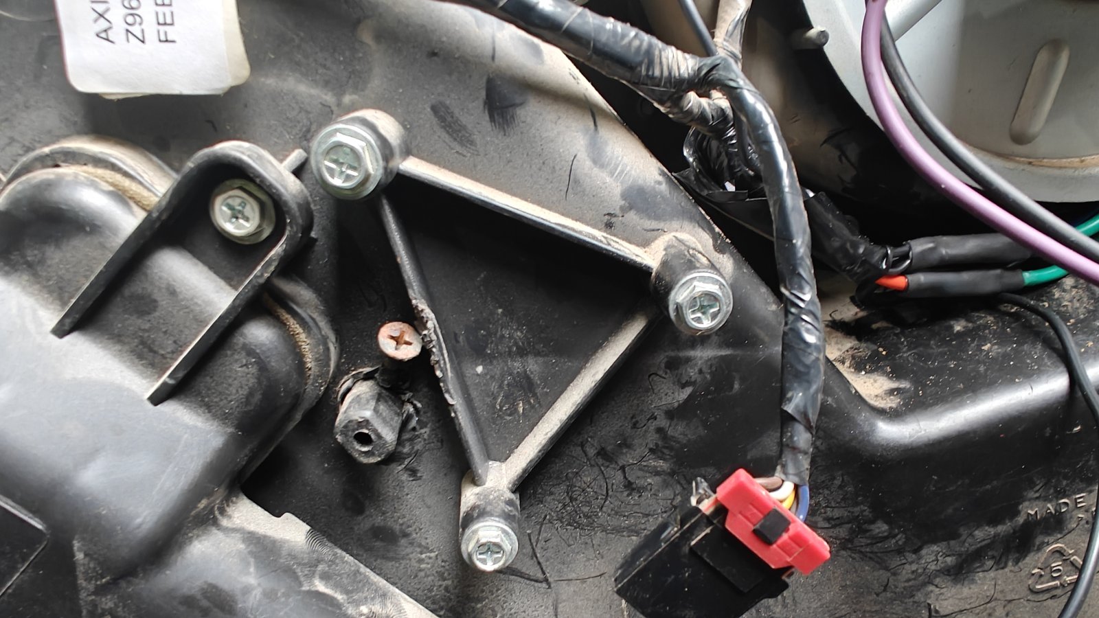

Back on May 12th I had taken my Tahoe to a local shop for some work to be done, one of the things being the AC to be charged since it wasn't working and I suspected a leak. No leak was found at the time so the system was charged and sent on my way. The charge ended up lasting about 2 weeks which seemingly turned out to be the condenser. I got it swapped and charged the system and all seems to be functional. My rear blower hadn't been functioning since about that time for whatever reason. I traced it to the ground circuit for the rear control module (auto climate control) and got that working today. Now I find out today that I have no temperature control at the back. I connect my diagnostic tool and I have a B0434 fault code which is related to the temperature blend door. I go to look at the actuator but it's not there. And there a drywall screw holding the end of the door sticking through the case. Where is my actuator? I know when I took my vehicle to this shop in the spring that system was functional. I used it through the winter. Do I go back there now wondering what the hell is going on?

That is odd……. Unfortunately, you probably, don’t have a before/after picture of that area…...
Be ’nice’ to your mechanic,….. Let him ASSUME, you knew the actuator was there,….. and ask him,..
“ What's the story about my actuator” ??
See what his reply is…..
One thought…… have you ever used the rear system, with it set to heater?? Maybe it was missing already…..
( Did you buy your Tahoe new ?? )
Look closely, at those 3 screws…… is there dust on the 3 screws, the same as the other screws, evidence, they have been recently turned?

@mountie I had the trim panels out after I had bought it because I redid the headliner (bought in 2022). It sat at my parents place for about a year while I did work on it. I'll have to look and see if I have pictures of that area but I doubt I do.
I used the heat back there the last two winters so far I've had the vehicle and the AC the summer before last summer.

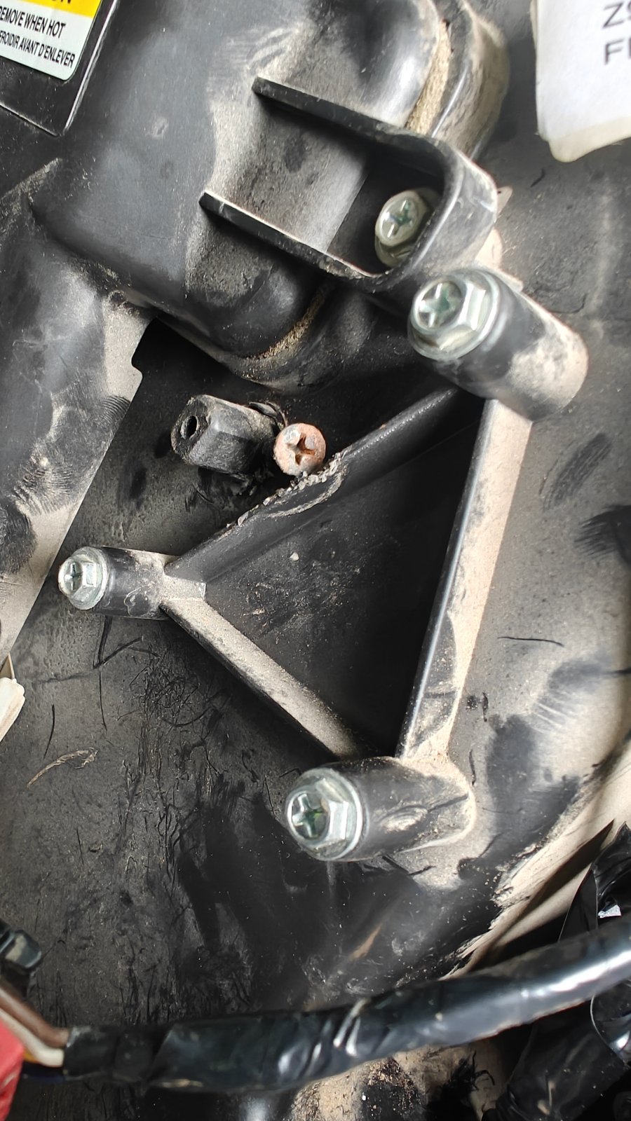

Here's some other pictures of it now.

Yea something smells bad. I'm fighting the urge right now to just go pick up the part I need and fix it myself vs leaving everything as is and going in there tomorrow to talk to the owner.

Apparently, your actuator is ‘manually adjusted’ at the moment….
Fortunately, that part is around $45 bucks. Do NOT buy at a dealer….. they wanted to charge me $145.00. !!

I would just hit the junkyard and grab one, take out the screw, clean up the plastic bits a little and install a actuator from the junkyard and call it a wash.
no telling what happened previously, where or when.
and without proof your just barking up a tree
if you "feel" it was said shop, then leave A BAD REVIEW and never go back.

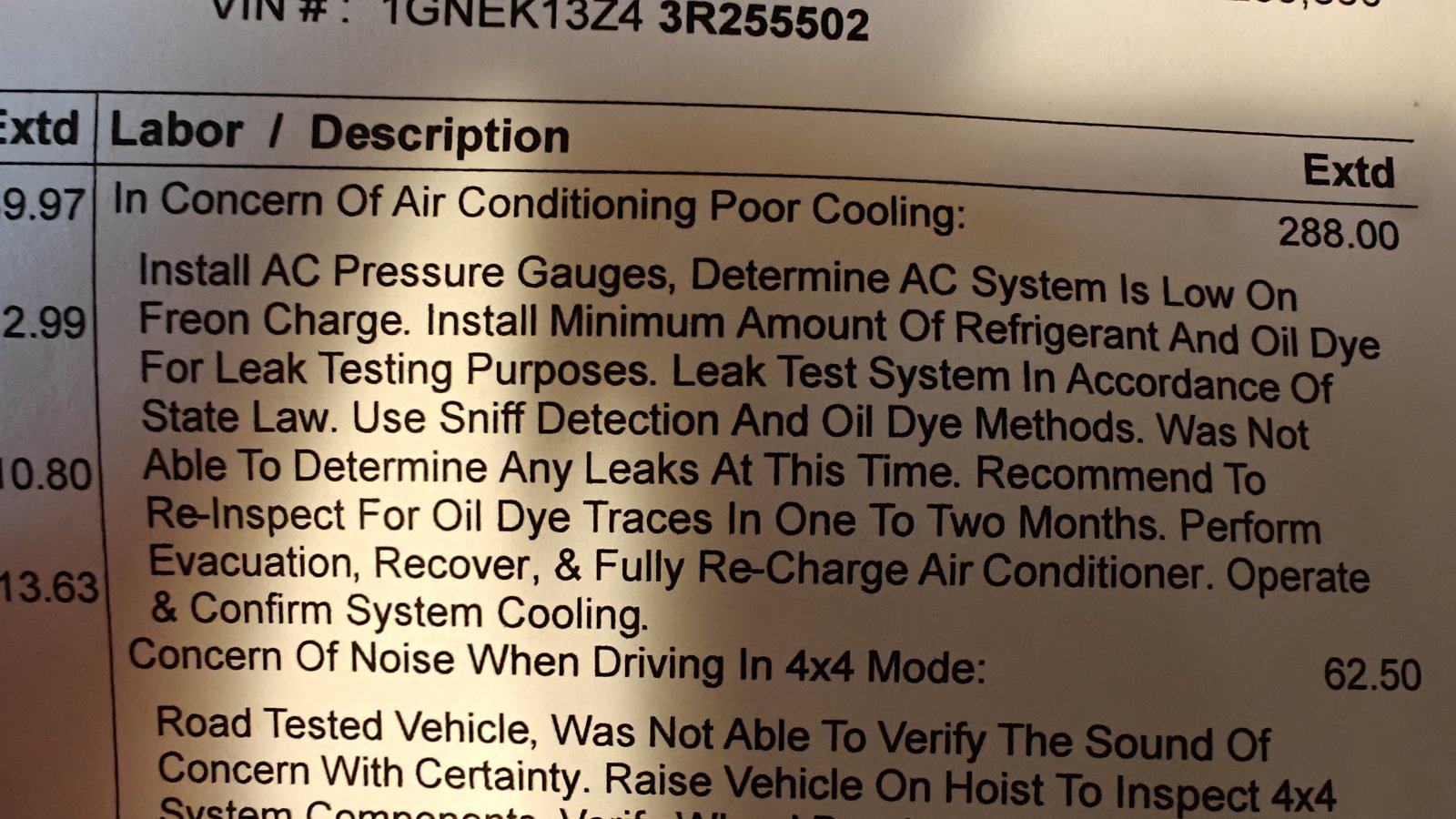

@Doubeleive the mechanic had told me too that after he charged it everything working and the AC was nice and cold. I noticed later that the rear blower wasn't working and had wondered at the time of he didn't turn it on back there or it wasn't working and he didn't say anything. But I didn't think you could fully test the system unless everything was functional. But to your point the AC can't be tested there if the actuator isn't there.
And yea nothing was mentioned about it "missing" or noted on the workorder.
