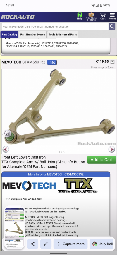

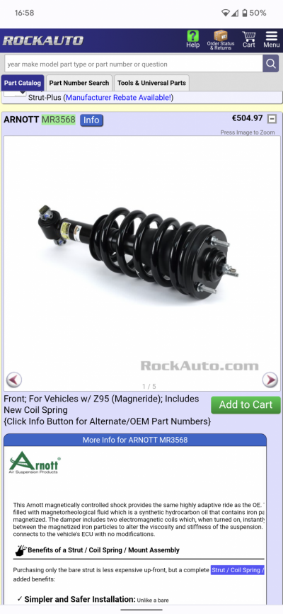

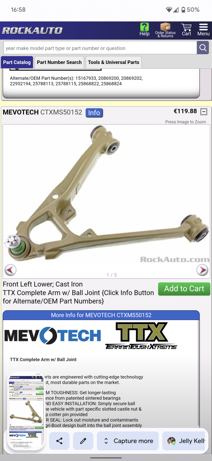

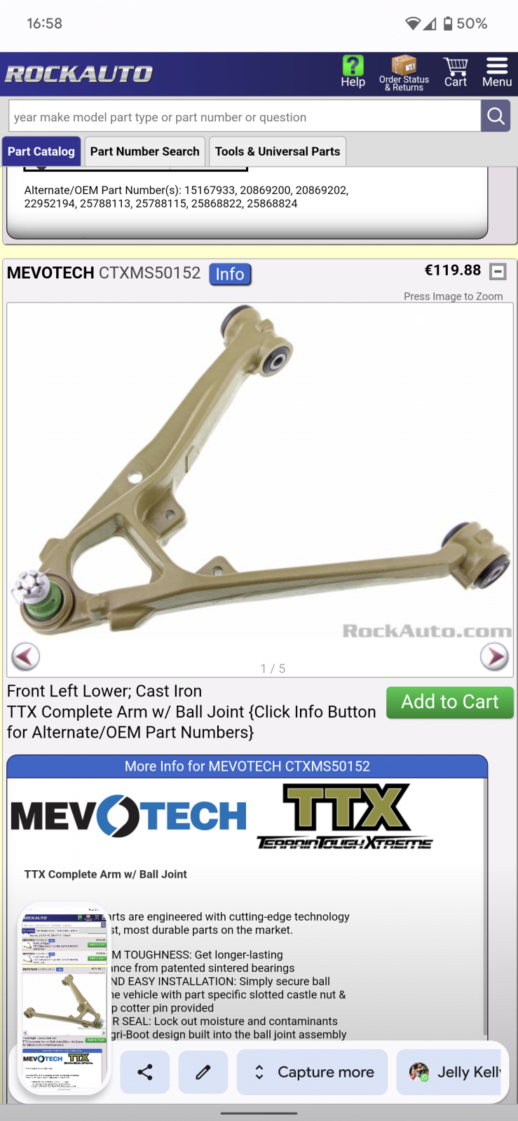

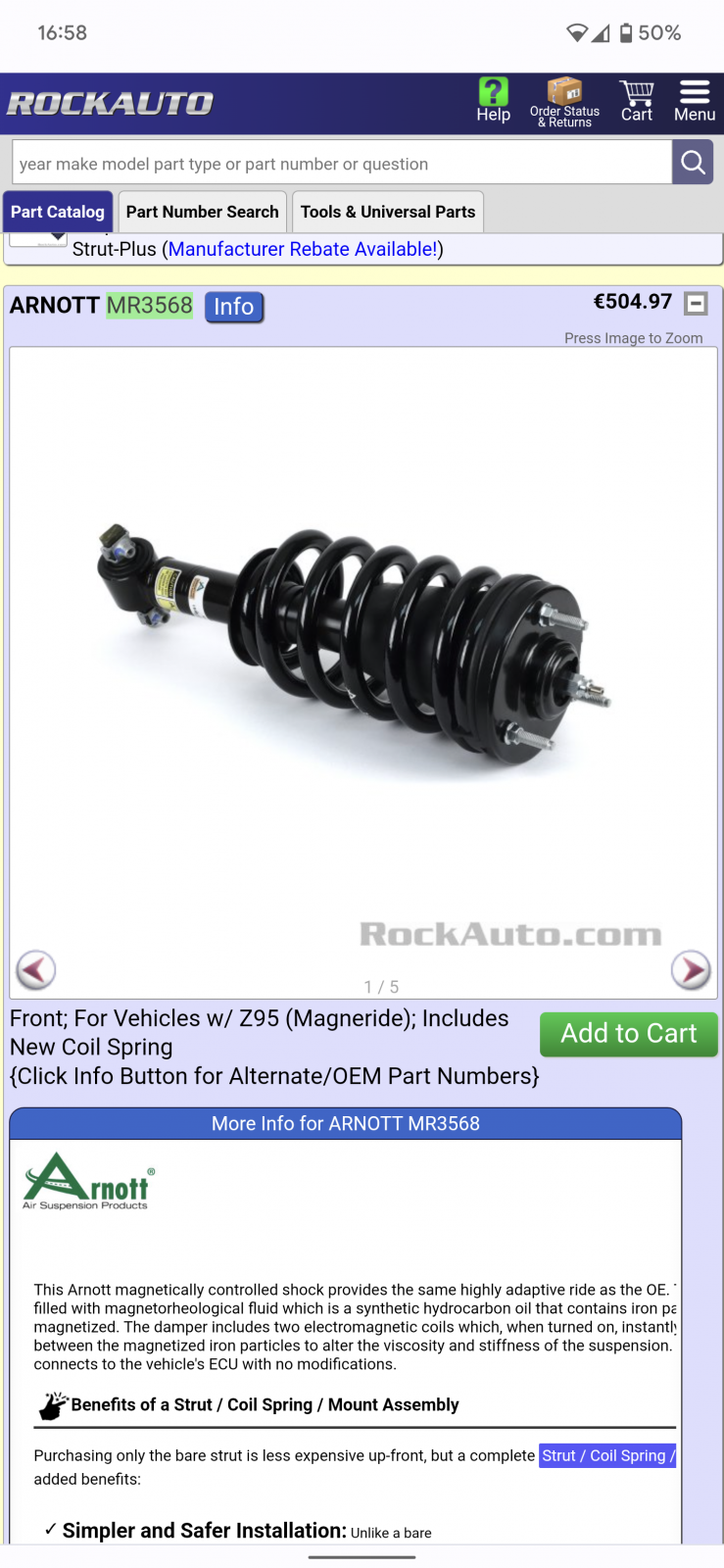

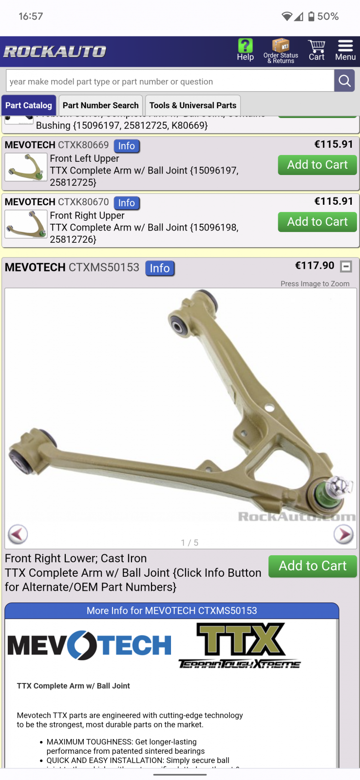

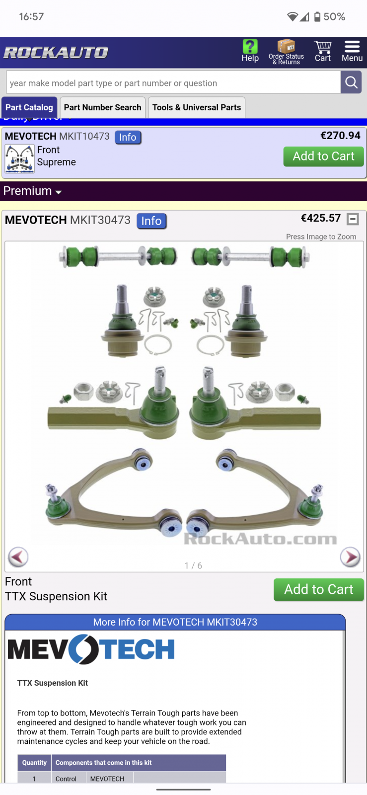

OK folks, so ive bit the bullet and spent some $$$$
Ive ordered 2x Arnott MR-5368 (I actually found European stock in Germany!)
And then a Mevo TTX front end kit, plus Mevo TTX lower arms.
Is there anything else obvious that I should be ordering?
Thanks

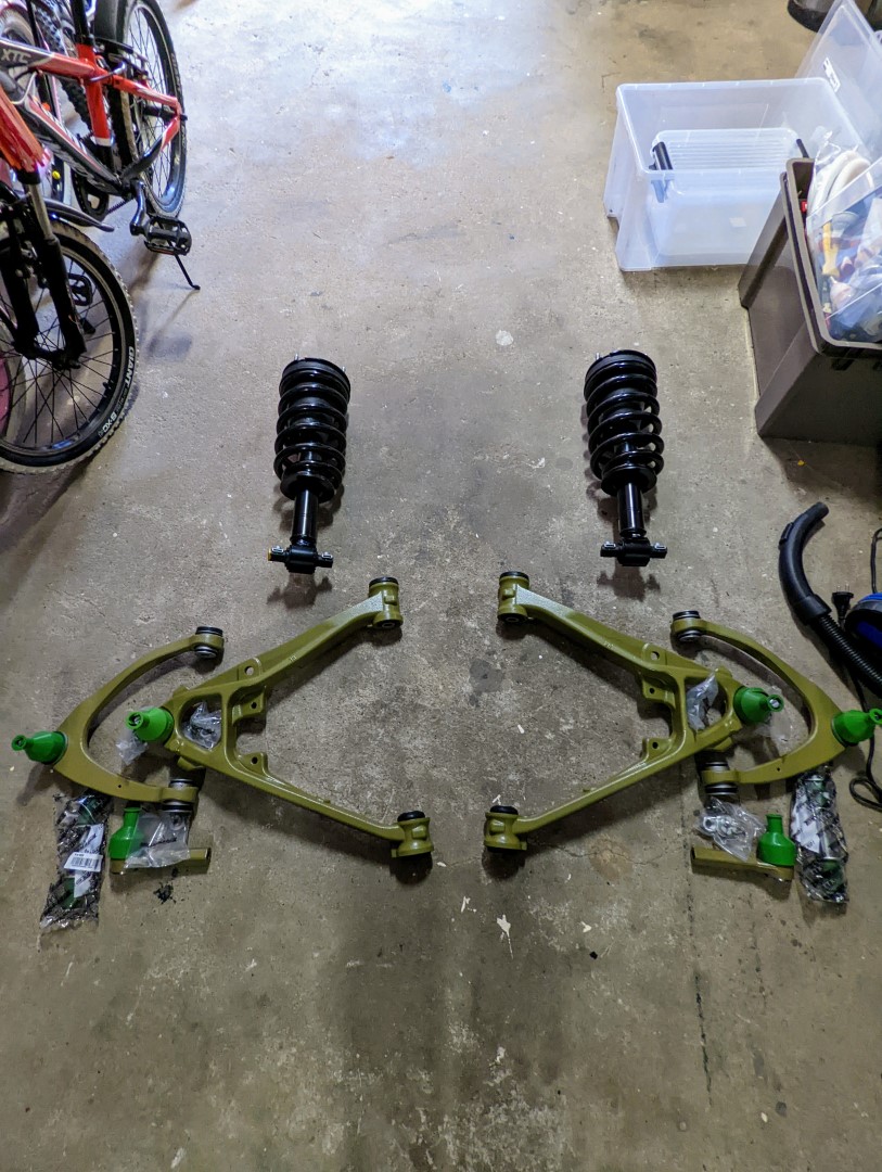

Well, almost all the parts are in. Just waiting on some suspensionmaxx 1.5" levelling spacers.
Shop time is booked 21st September :)

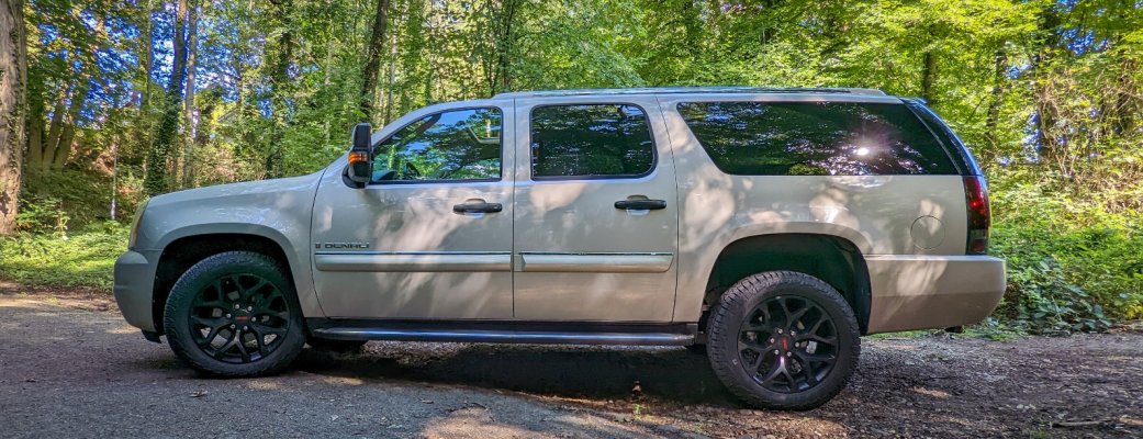

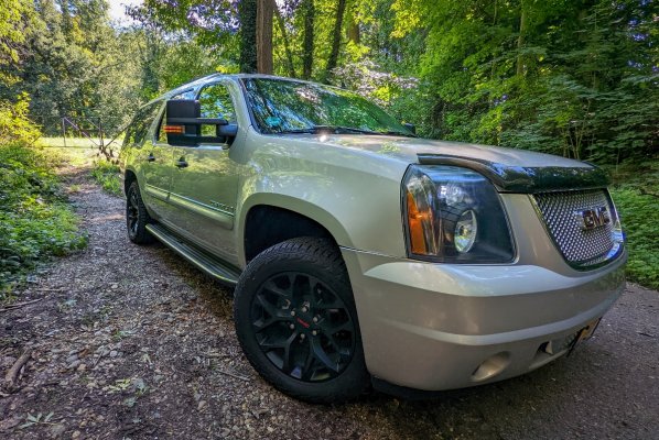

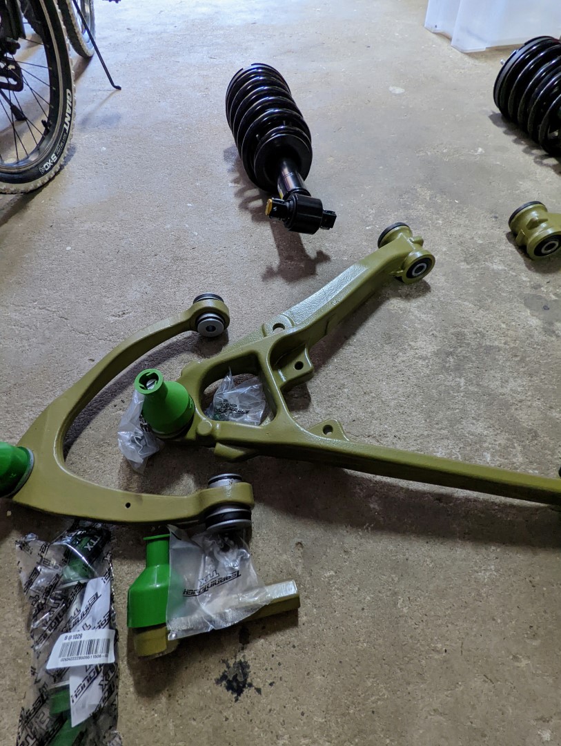

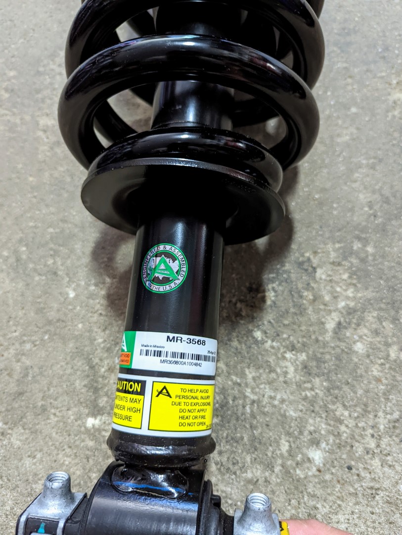

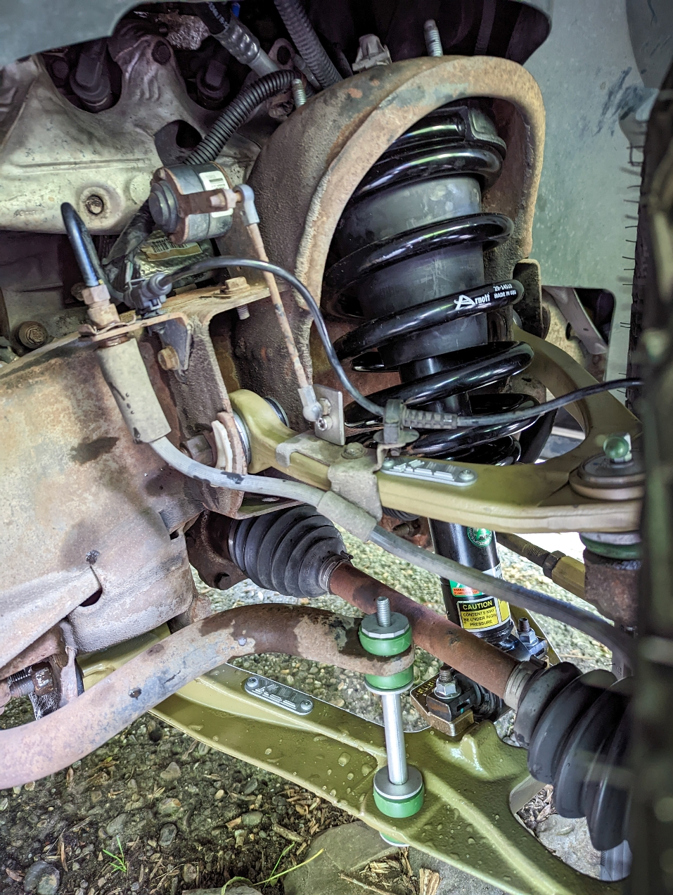

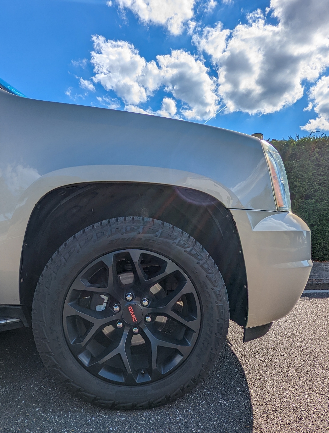

Finally on the car!!
Super happy with the results. It drives great and also eliminated my highway shakes/wobbles in the wheel. It drives beautifully.
I also took the opportunity to do a 1" level. Now got space for 33s :)
It was a sizeable investment on an old car, but I hope it will be worth it.
TTX arms and balljoints etc = $1150 incl intl delivery and taxes.
Arnott electronic shocks = $1000
Level kit = $280
Workshop hours for fitting = $600
So almost $3k. I hope the old girl stays reliable and pays me back.

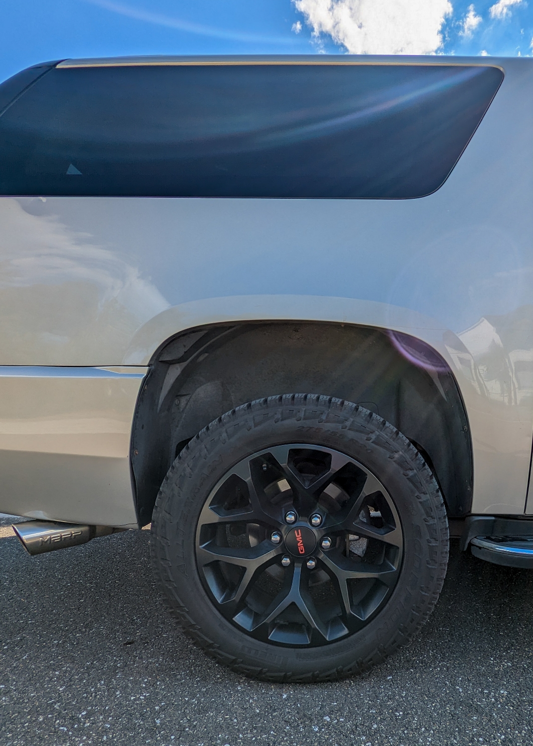

More pics

Rkosinski
Nov 13, 2022
I am curious about the Arnott shocks you chose. They are specific to the Z95 Magneride suspension, not the Z55 Autoride suspension which your Denali has.
I believe the fit is the same, but the Z55 front shocks do not use the Magnetiic fluid which is specific to RPO code Z95.
So while they might fit and not generate a fault code, I would be skeptical that they are actually damping they way the OEM Z55 shocks would.
Did Arnott ever advise you about this or say they are interchangeable?
