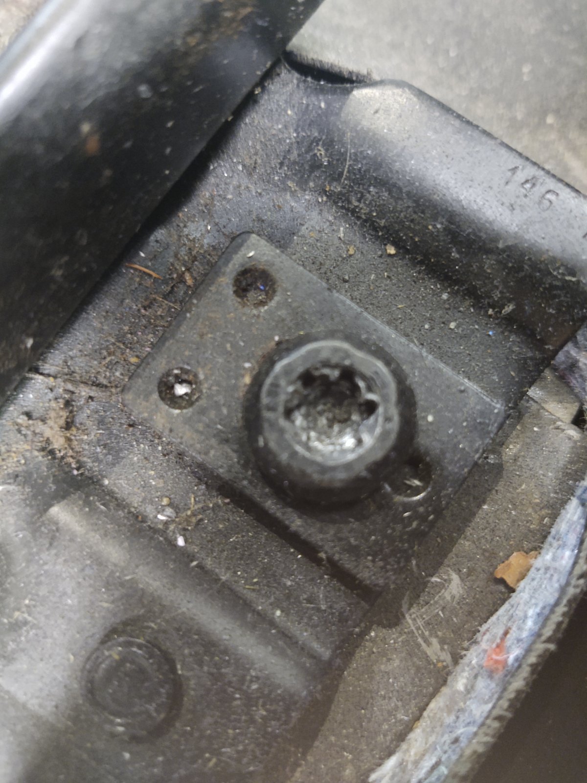

Going to pull my seats.
What would be the proper type for fit? A star bit? It's not spline or triple square. Nothing in my torx set fits properly (either too small or too big), but maybe my set doesn't come with the proper size.

That bolt has been messed up and probably won't find anything that will fit.
Probably needs drilled out and new bolt for replacement.

Yup. It’s a T50. It bites perfectly on my truck and the parts cars I’ve been on getting my Caddy seats.
