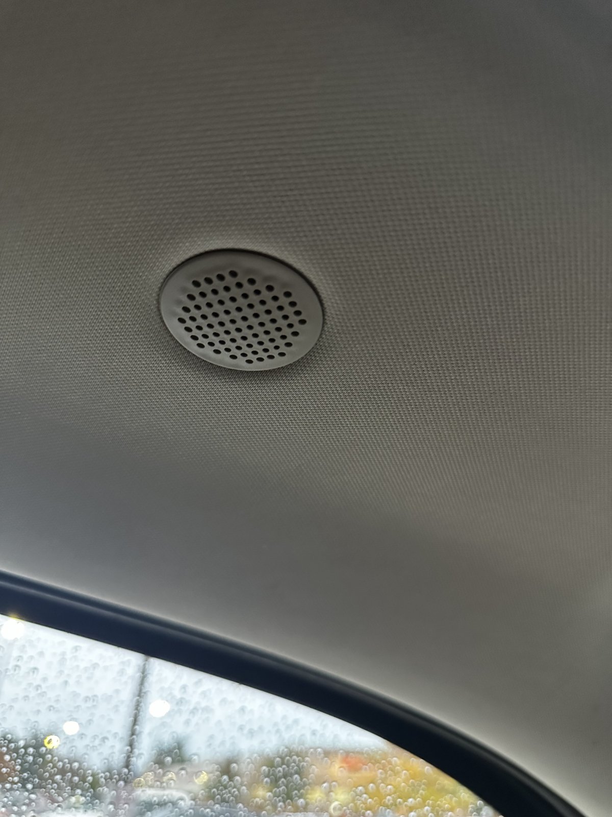

What the heck is this thing?

What is this doohickey and why does it make the most annoying vibrating sound ever all the time?

Pull that cover and clean the hair and dust off the fan blades. If it doesn't work, get another aspirator, 22834330. If it fails, your Auto AC won't work right.

environmental sensor for the hvac to properly regulate the interior temperature. it has a small fan and a thermistor, the fan motor goes bad and makes the noise. the fan blows air over the thermistor and changes ohm's the ohm signal goes to the hvac, the hvac then adjusts the temp up or down to keep the temperature where you have it set.
a new replacement is about $25 online and is easily replaced by both unclipping it and reaching in from the side of the headliner.
just pull the side of the headliner down "carefully" just enough to reach inside

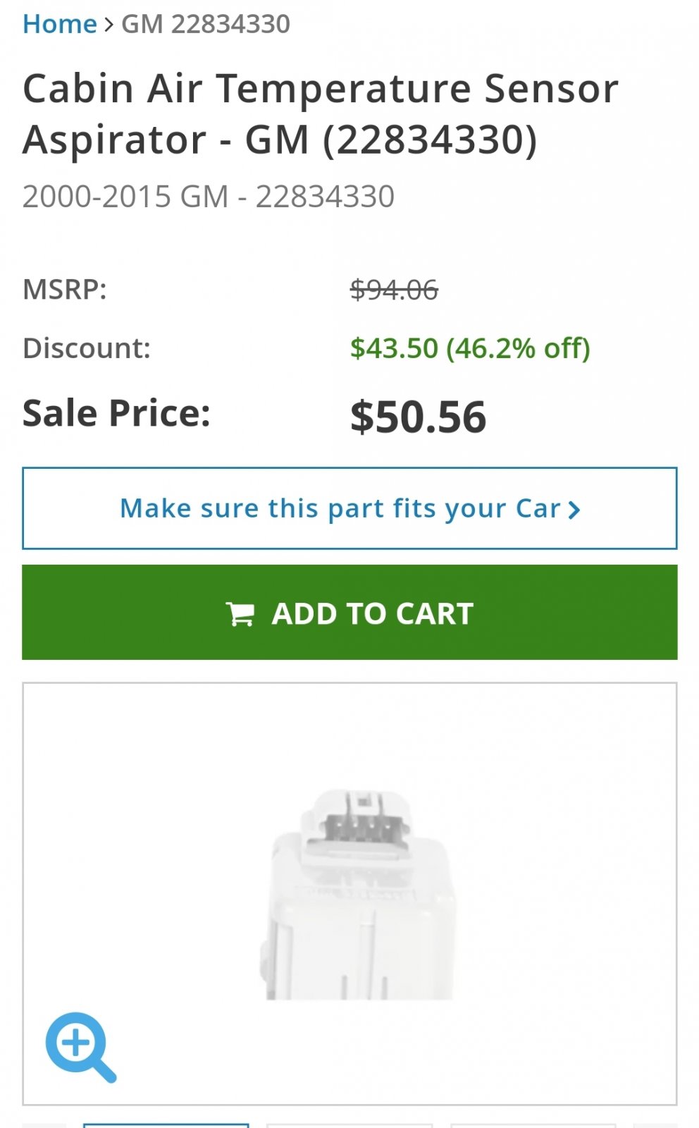

Anyone still finding these for $25?
solli5pack
Jun 17, 2023
486
741
RockAuto is the win. What you really have worry about is counterfeit parts from others. Use the discount code below for 5% off.
Yes it is! Can someone provide some guidance where to enter the code when checking out? Thanks all for the info!
solli5pack
Jun 17, 2023
486
741
Just ordered! Saved $2 but still cost about $50 with shipping and tax. Now just need to research how to put it in without destroying the headliner...Thanks again everyone..
