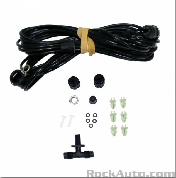

I think there is a tiny o-ring inside the air line connector but I would need to go look at my spares and verify, you can buy a air line kit and replace that piece if you need to, it obviously works well as GM has used the same design since the 70's or before.
if it is holding air now no need to check the other side as both lines are connected together the a "T" connector, it is not pressurized left/right.
8,148
11,300
Yes, there is a small o-ring that seals the hose and its 90 degree hose connector to the shock's air connection nipple. You can see them in the photo below, which is a replacement air hose kit for this suspension.
