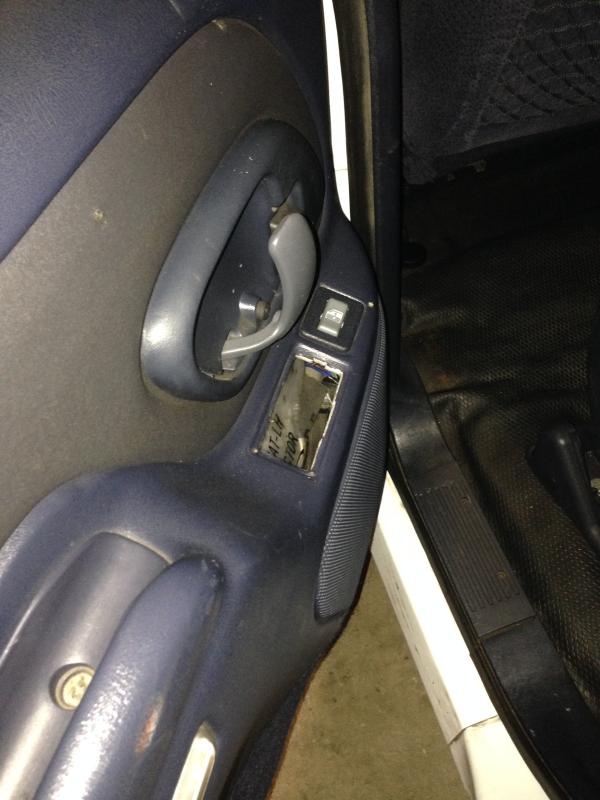

An ashtray? A doorlock switch? Please include link. Thanx
F
fredfifty
Sep 19, 2014
23
DC
I cant seem to find that part, looked on CL, Amazon, etc..
Plus i dont see or feel any harness that would hook up to a switch?!
Wierd.
---------- Post added at 04:45 PM ---------- Previous post was at 04:19 PM ----------
lmc truck didn't have it? but I checked ebay....again..and they had it.
I knew it couldn't be the doorlock switch because it was too small for that opening..

I thought about adding a USB female cable on both sides so whenever who in the back can charge the device
ekylypse
Feb 14, 2015
Did you ever add this?
If so, can you give a little insight on how I could do it?
We could let this thread die, but why?
Honestly, if you would have an issue wiring USB ports in this panel the next best thing would be to wire a 12v socket and use a bullet-type adapter for either a single or a dual USB port. 12v is supplied to the window switch. Though, in that instance the driver could 'lock' the USB ports too since common practice is to remove the ground for the window lock. I suppose an alternate ground could be sourced easily enough.
:hmmm2:
getonerd
Feb 8, 2014
51
dayton oh
The plan was to get an 12v to 5v usb adapter and wire it to
battery or tap into the cig lighter
