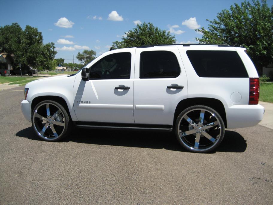

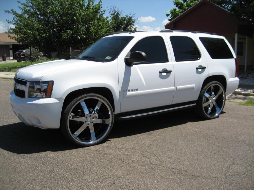

Finally got a picture of my Hoe,, what kind of drop do you think i will be able to do???

Looks nice, but good lawd those are big.. i dont know about drops but id say about a 1in or so.. tires look like they will hit.. as stated above

yah same as ive done on other customers trucks. 1 inch in front and rear 2 inches.

Drop the rear 2" to level it with the front and call it a quit.
I was rubbing pretty good with a 2" drop, 26s with a 305/20/26 tire and a +35 offset.
Don't attempt dropping it at all, more than 1" in the front will not work in any way w/o grinding more stuff than I had to with the 3" front drop (I removed, bent, grinded, trimmed and it still rubs)
