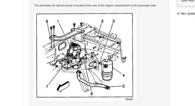

that spot was originally used for a air injection pump that pumped air into the intake during the first 60 seconds or so this was to help idle during a cold start, it was basically useless so they eliminated it sometime during the 2001 model. my 2000 had one and it eventually leaked and caused check engine lights, pulled one out of a junk yard and it lasted until I sold it. now it is the battery compartment on the 2007+

secondary air pump
52,956

ya the pump was only on the 2000 and some 2001 then they deleted it but ya its a perfect battery spot
