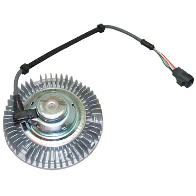

Unless you have a C42 RPO Code
https://www.rockauto.com/en/moreinfo.php?pk=1028578&cc=1380372&jsn=2375
