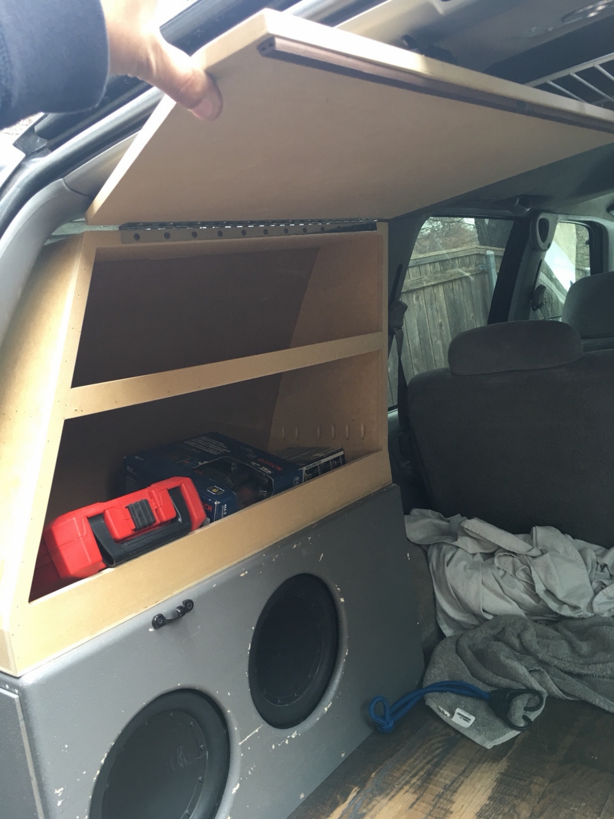

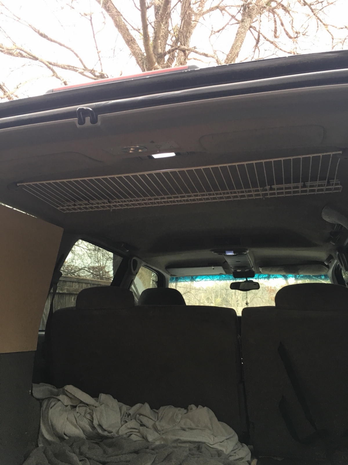

Made some storage solutions for the Yukon Trying to get ready for me and the wife’s 2 week long Colorado camping trip
You put hardwood floor in there? That box is really nice looking. Good build. How is ceiling rack secured and what is your intended purpose?
DallasTahoe
Aug 17, 2012
711
214
Lol Yea 3/4 in oak flooring, it’ll be coming out soon and replaced with something lighter and softer. Thanks man, been thinkin about rebuilding it for a single 12in instead of dual 10’s. One side The rack is held up by the coathooks and on the other side I punched a hole in the headliner on the right and left and made two pins that slide into the headliner, that way I can remove it quickly

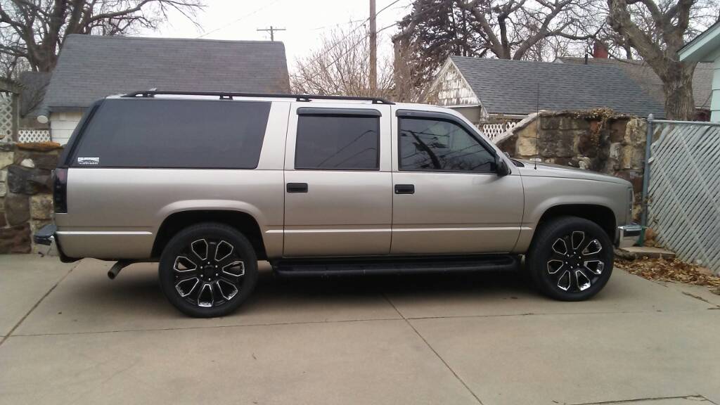

Got the new wheels on over the weekend. 22 inch 2017-18 denali reps with wider than oem tires. 305/40/22 instead of 285/55/22.was going to get snowflakes but like being different lol. Think they look much better than the other wheels we had.i might need to lower it a bit though and fill in the gap. Glad i went with the black with chrome inserts instead of all chrome or grey w chrome inserts. Only thing i dint like is the wide tires, they don't ride in the grooves of the road very well so it tends to pull left or right if the road isn't true

Looks good.... level front ‘up’ and that will look badass....i guess ‘down’ will look good too....lol
jiggie
Jul 14, 2017
167
102
Actually had to go down quite a bit to get it level lol. In this pic the rear was at 35.75 inches and the front was turned way up at 37.75. The adjustment bolts were way up in the cross member. Now it sits at 35.5 in the front. Had to back the keys all the way down and count my turns going up. 3 turns got her right! Found out mine doesn't have the 2 inch blocks factory in the rear like i thought it would. I think the tire shop turned them up to clear the tires but it wasn't really needed. Im chewing over the beltech 3/4 drop kit for it. Will get it lower and fill in the wheel gap but still be functional 4wd.
