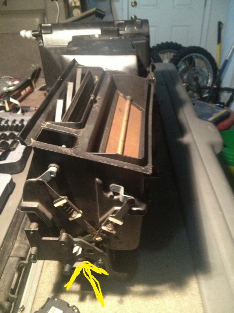

Recharged the ac and dug into my flapper door issue, seems like the linkage came apart on the flapper door because the rod going through the assembly that flapper is mounted to has come loose on the passenger side of the assembly. Does anyone have a diagram of how that all should be assembled?

No the servo is good, it appears to be part 26, it came disconnected somehow on the right side opposite the servo. Because of the servo arm came disconnected. I should be able to fix it once I get the door back in place
Ty for the diagram its gimma be a big help

it seems like the door has come loose where the arrow is pointing to, this has caused the circled black pin to pop out. What im hoping is that i can get the door back where it belongs without having to tear the entire dash out
