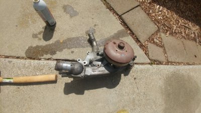

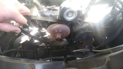

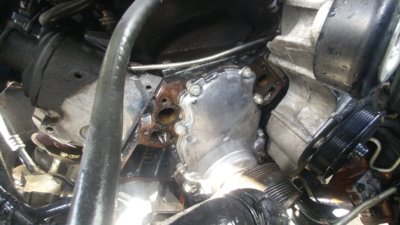

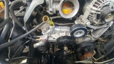

Ive noticed higher temps lately and some coolant leaking occasionally. Figured it was a waterpump.

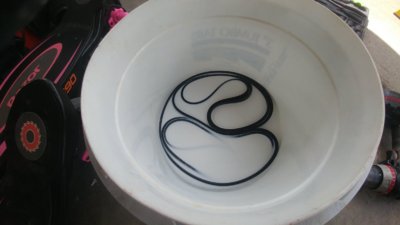

Changed the water pump, thermo, ac belt, lower rad hose. Soaked belts in aerospace 303 which makes them last longer apparently.
View attachment 195280 View attachment 195281 View attachment 195282 View attachment 195284 View attachment 195285
Did it cure the leak,..just did the same thing to by buddys 03 z71 ...thought it was waterpump,..then we found a leak in the crossover tube, the tube that goes from one head to the other.
So far so good. Temps are better. I drove it around a few hours.
Water pumps weep out of the vent hole when they Are on their way out and dont flow well at low rpms.
