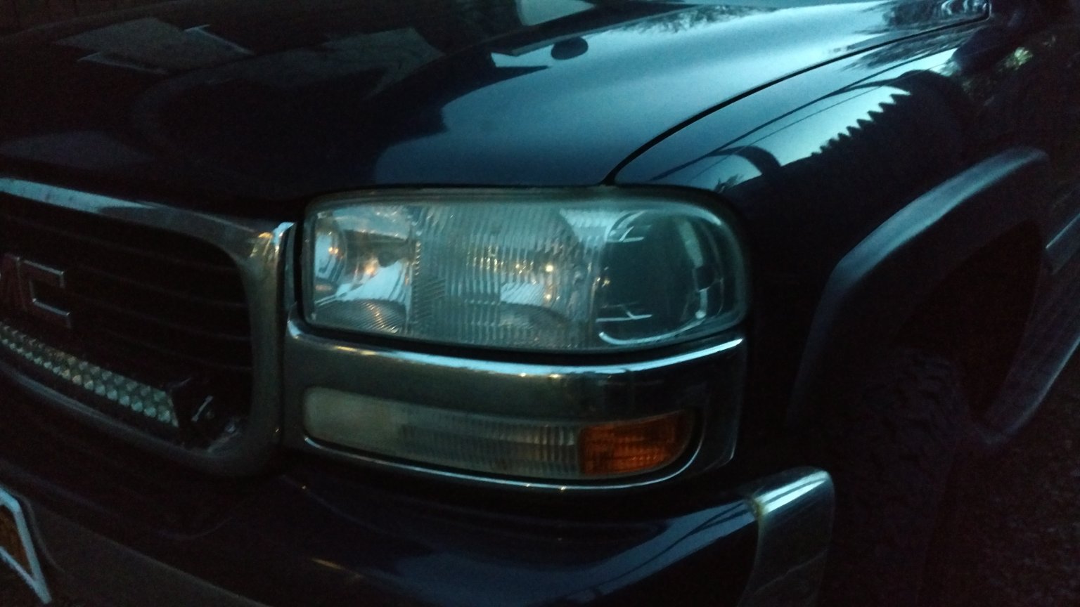

Had to replace the passenger's side headlight from when a towtruck driver "forgot" to chain down my ass end on a flatbed, and it slid forward when he went to stop. Grille cracked, and the headlight assembly broke. The owner of the garage was cool, got me a like-new assembly, a new grille shell, and a replacement set of 9006 LED headlights.
While I was swapping parts, I remembered that someone on here had disassembled their headlights, and popped the amber marker out. Since there isn't a light assembly behind it, I figured "why not?"...
View attachment 81776 View attachment 81777
Now I've got to look for the lower light assembly in an all-clear version, will find amber LED's to fit in them.... might even use some of the 18mm Blue LED's I have, put one in each corner where the amber lenses were.

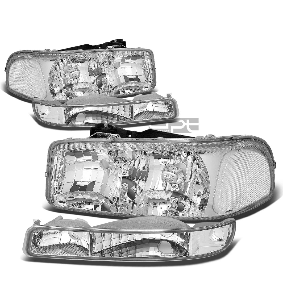

thinking about clear lights, got searching E-bay - which do you guys think would look better?
Black housing/smoked lens?
Or black housing/ clear glass?View attachment 81779
Or Chrome/ clear glass?

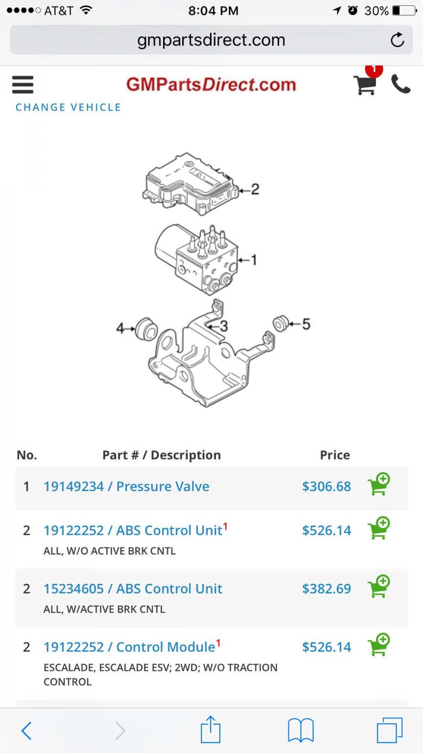

View attachment 81785Like both 1 and 2. Added up it's kinda close to the price they said.
#1 is the modulator valve, not the ABS control unit. It seems like the mechanic would state he's replacing both parts. If it was me, I'd send the ABS module in to be rebuilt and see if it fixes it. Module Master has some troubleshooting steps you can take. You can also describe your problem and ask for guidance.

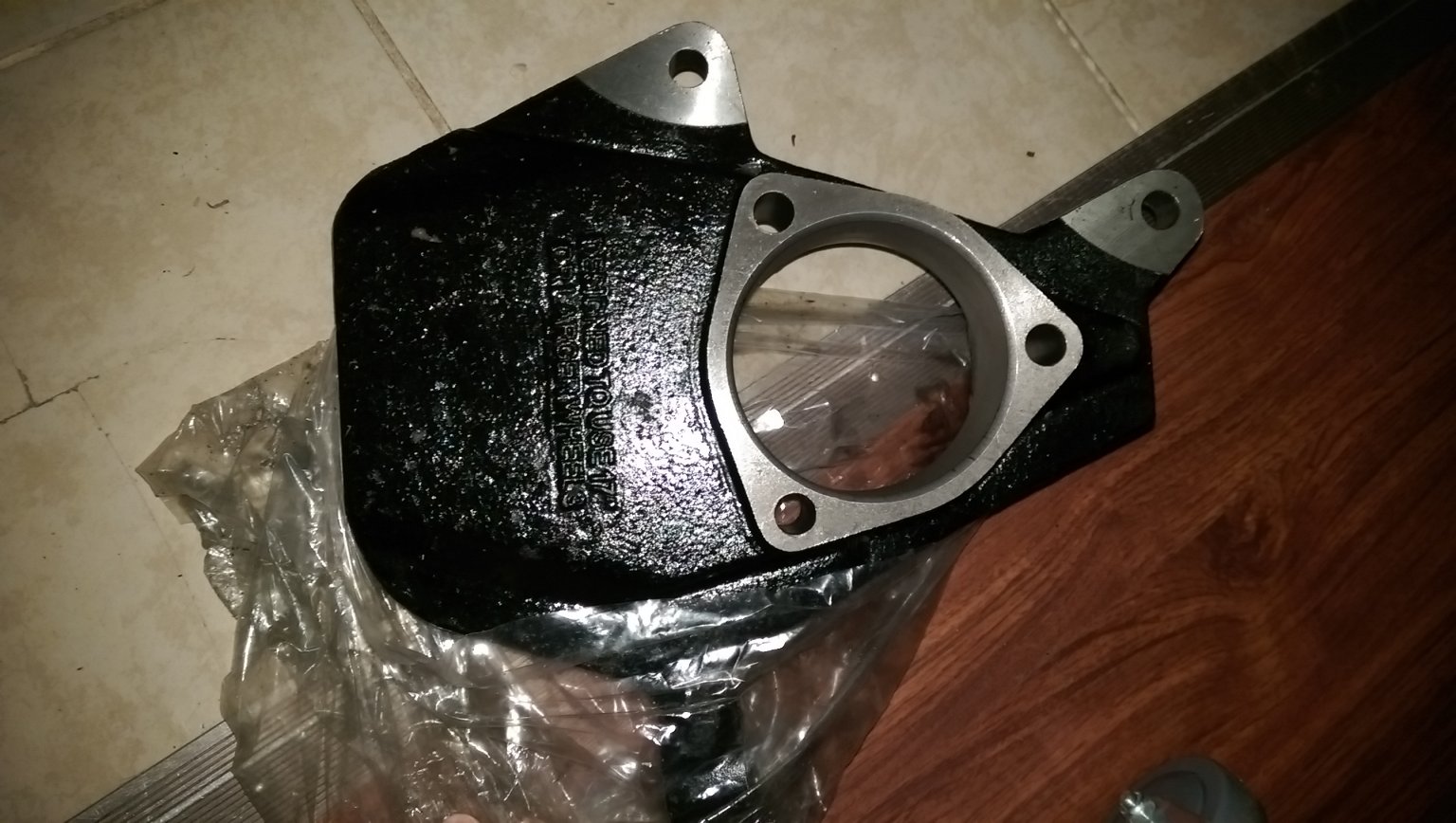

Got my 2" drop spindles today. View attachment 81786Now what do I do with my 2" drop keys? Crank them all the way up and install these? Would that work?
It should work. The keys are 2" drop max, but I believe they can go back to near stock height. Or use the spindles and use the keys to drop another inch for 3" total.

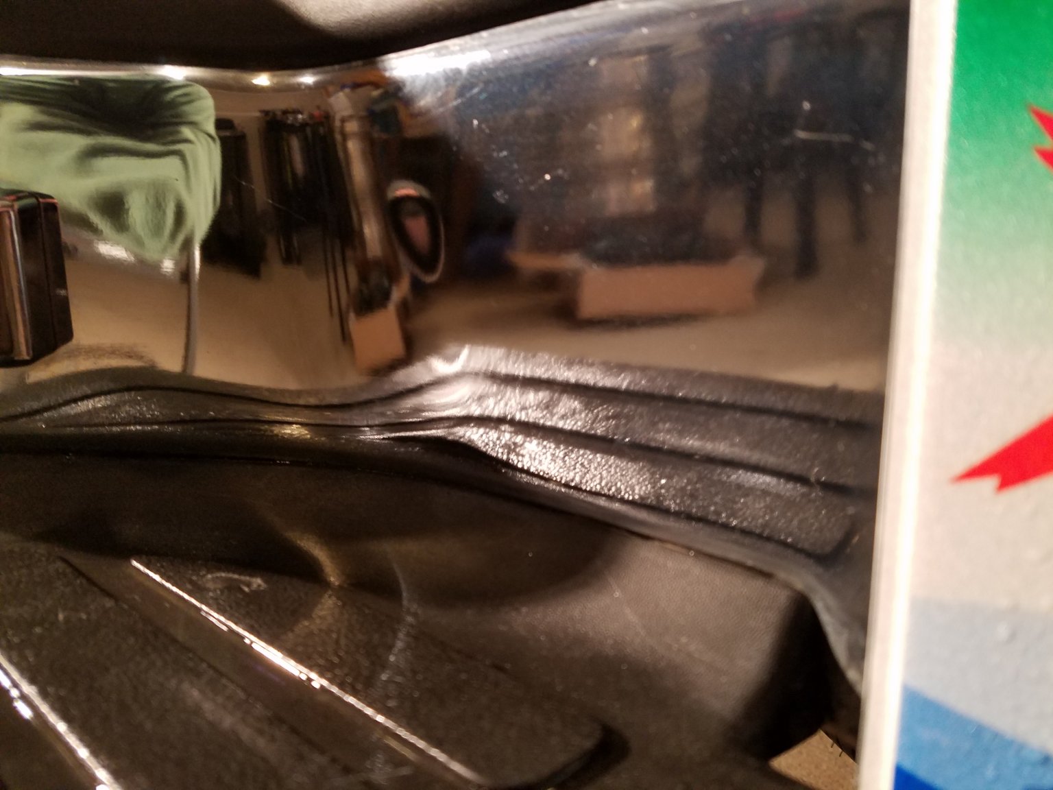

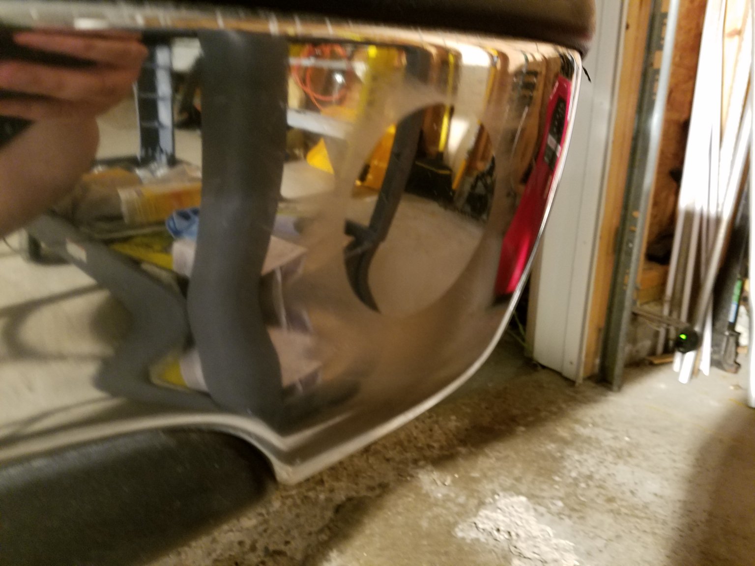

I was bored, and went out at 2am to scrap the remains of the bumper stickers off, and polish the rear bumper on the Yukon XL.
It looks like they tried to use steel wool to remove the circular one. I just used my razor scraper and some goo-gone and they came off without any fuss.
Looks like I need to get another bumper sticker to put on this side, or just put the one I got over this spot.
