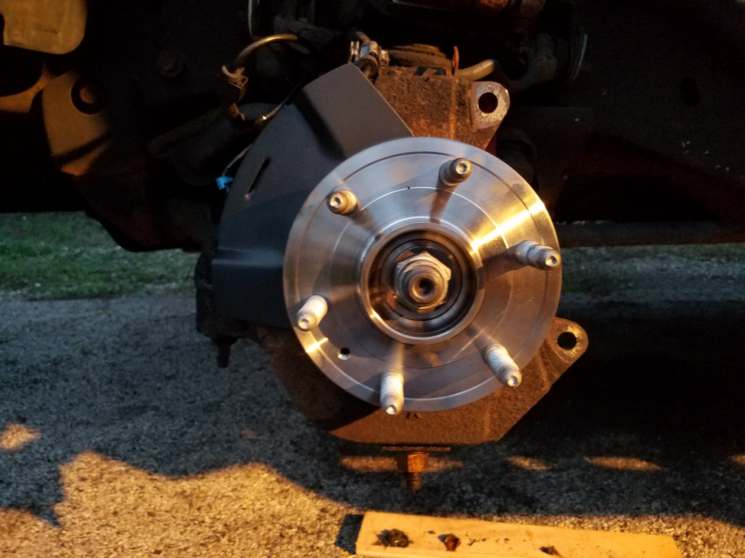

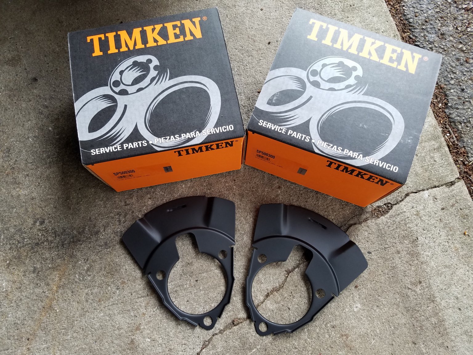

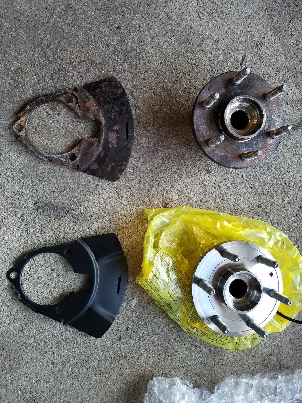

Did the driver side hub and shield... It was screaming like a banshee. Pretty straight forward. Will do passenger side when new brake stuff gets here.

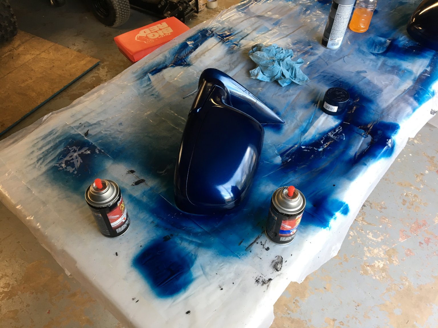

Painting the whole mirror assembly vs just the cap turns out so much cleaner.
I did the same and have been very happy with it since I had it done.
Nice work. :thumbsup:
Can't remember, but did you disassemble your mirrors when painting?

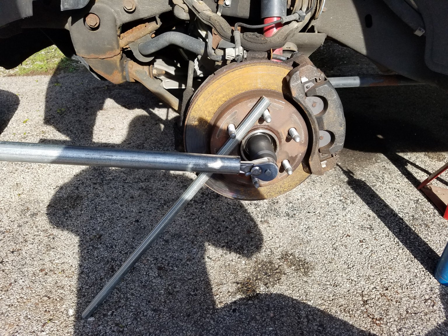

I'm going to be doing mine in a few days. How did you break the axle nut loose- on the ground before you tore everything apart? I saw A1 Auto torque them down afterwards by installing a wheel and lowering it down but they used an impact to break them loose.
An impact would've been nice (I think an electric one from HF is in my future). First, I had taken the wheel off and hit everything I needed to touch with PB the day before. When it came to the axle nut, I had seen arguments over the size, 36 or 35, mine is 35. I put a torch on it for a minute and used a piece of 1/2" rigid to hold it and about a 2' piece of 1" on my handle for leverage like this :
I just flipped it the opposite way to reinstall, and torqued to 135.
I didn't bother with the T55 caliper bolts. I compressed it with a C clamp, pulled the 2 18mm bracket bolts, and lifted the whole caliper assembly off in one piece.
Used the 2 wrench trick to crack the 3 15mm bolts for the hub, they came fairly easily. The hardest part was breaking the hub loose from the spindle. I shot the seam with PB, beat the hell out of it with a 3 lb sledge, and ended up using a cold chisel to help "walk" it out. I'm sure my neighbors loved it, I probably hit that thing 100 times.

They came like that. They are Dorman.
They are the only ones I could get quickly local. I didn't originally plan on changing them. I was happy to see black because I'm planning on black rotors. I still haven't made a final decision, but probably the ones that @Red Rocket got with the red calipers.
