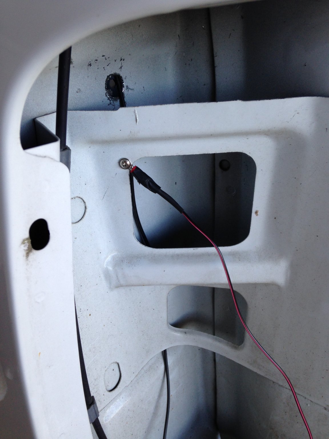

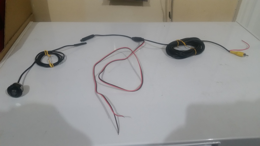

This is what I got @Tonyrodz
Mount the camera and run the wire to the main harness. From there run the red and black to the reverse light. From there run the rest of the cable to the deck. Plug in the yellow rca to the AV/in ......and I guess the red wire coming off the rca splices into the reverse trigger wire on the back of the deck?
I know it's simple but I feel dumb, it's my first camera install and Mr ebay never sends instructions for anything lol.
Run the power line for the camera into the power of the reverse light, and ground the black wire from the camera to the body like I did
Then you have to get the Head unit to "see" when you switch into reverse, I tapped into the wire running up the a pillar to the reverse mirror that shuts off the auto dim function when reverse is engaged. There is another wire you can tap into at the BCM, but I couldn't find it well enough.
33,199
51,441
Exactly what he said @05Single .not hard at all. Hardest part is running the cables and hiding them. We have faith in you! :waytogo:
What about that red wire that comes off the yellow rca plug? I figure plug that into the back of the deck instead of running a separate wire to the a pillar. Has to be interconnected in the harness to the other wires that connect to the reverse light. What else is it for ?
