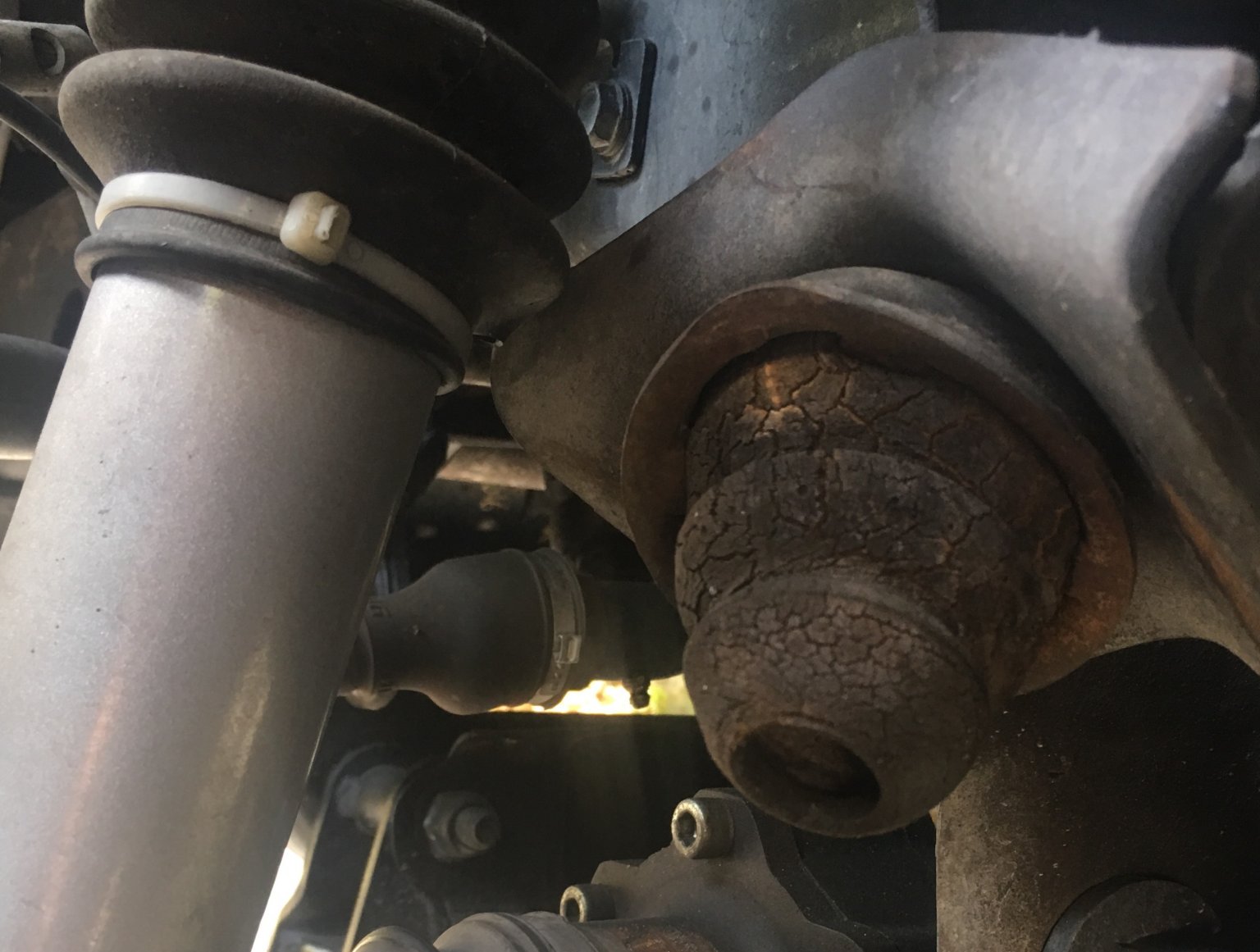

Back to the jounce stops, what holds them in is there a bolt inside or what
Nope, they're just kind of pushed in. Use a flat head screw driverdriver or a small thin prybar and pop out the old ones. To install, just clean out some of the loose debris, if there's any, lube the top of the new one and twist, turn, pop in the new one. You're done. You might have to Jack up the front a little bit, just to make a little room between the lca and the bump/jounce stop.

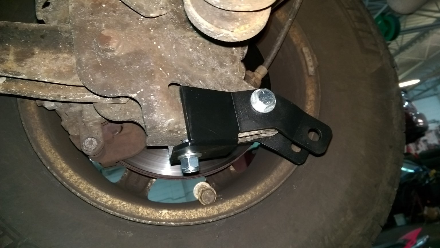

Yeah my RCX lift came with 6in brackets that bolt into place on the lca's

I thought you said you have 10" of lift though? I was wondering since I see all that space under your jounce stop in the picture.

That's including a 3in body lift and some 3in RC keys that I only cranked up an inch. The bracket is just out of frame in that pic. There's approx. an inch gap between the jounce bumper and bracket in the passenger side. The only way I can think to fix my driver side is to cut it off and weld a new one in its place.

They're designed to be in contact with no gap. Probably ride a lot better if you can fix that but that might be a challenge with that much lift lol.

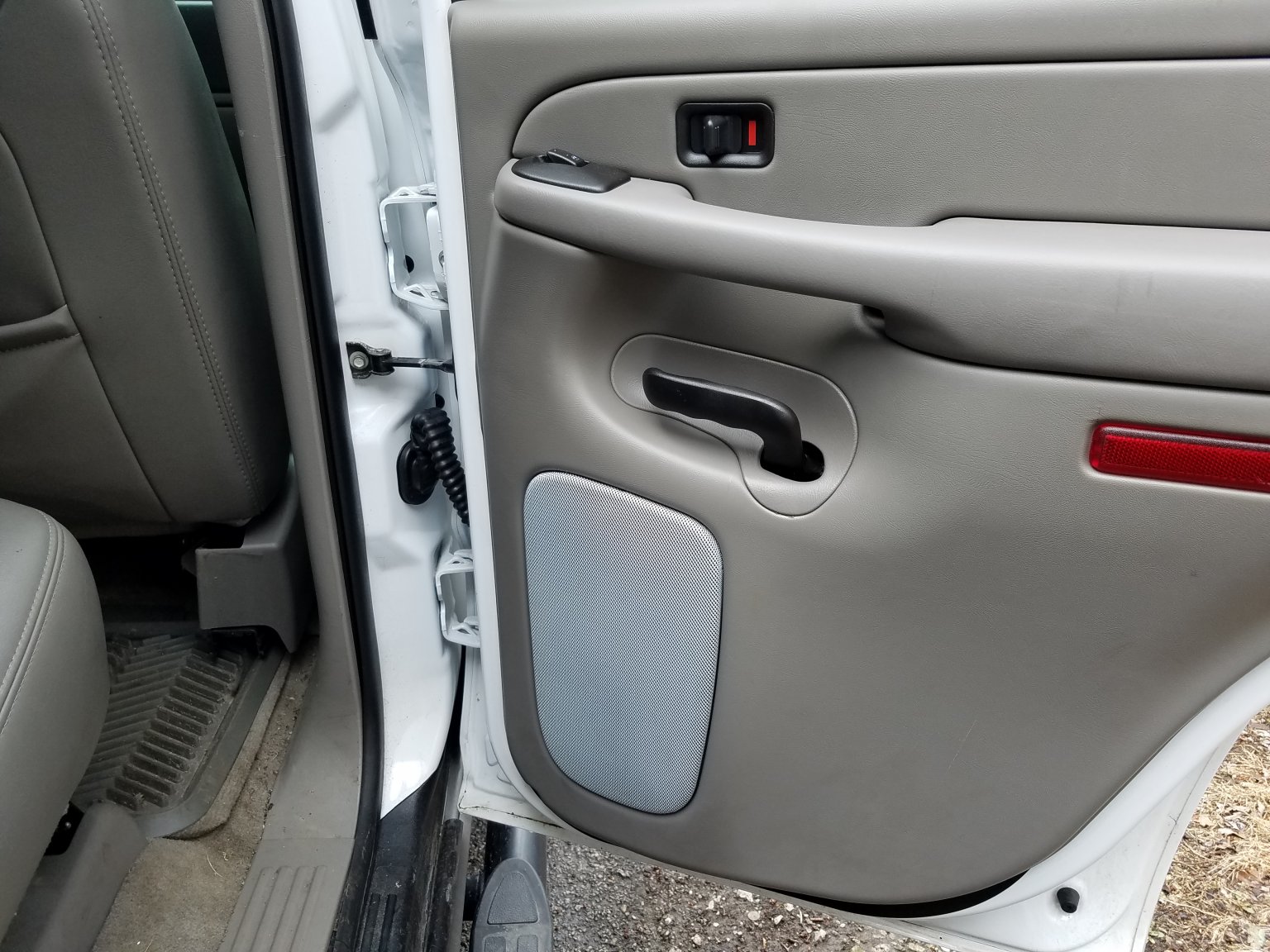

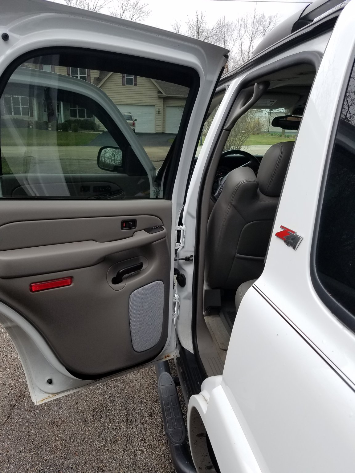

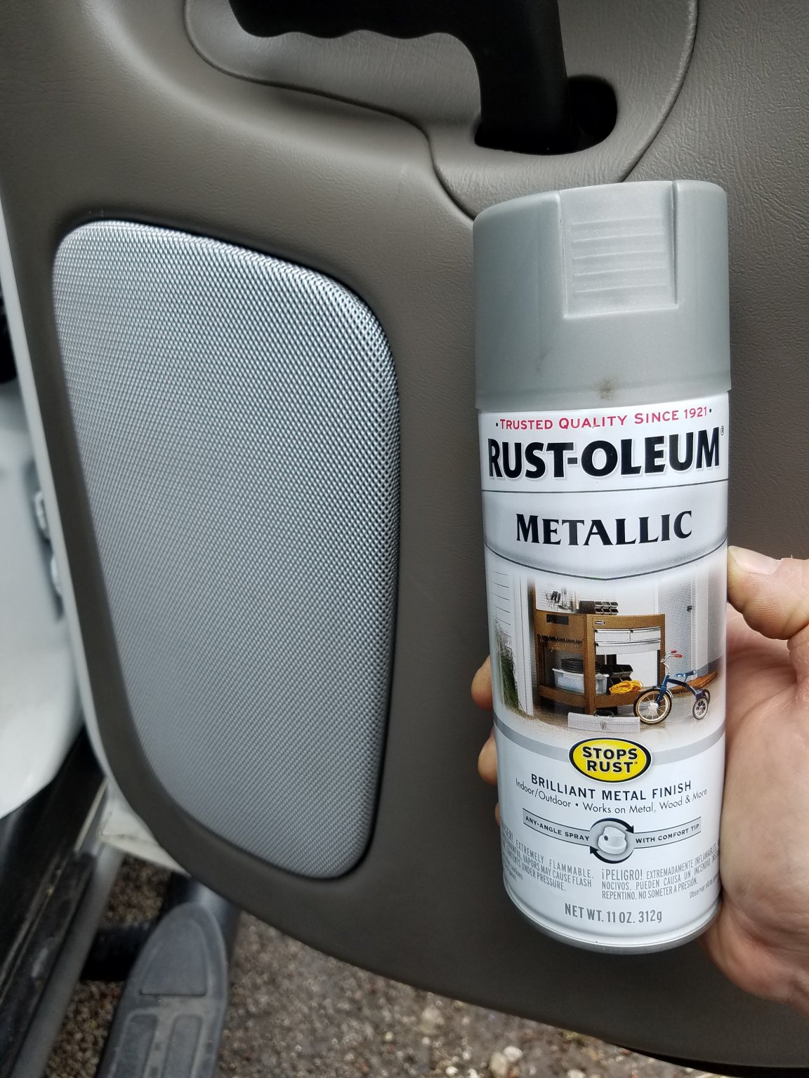

Not to totally get off the jounce stops, cause I know it's a big one with us all lately, but today I pulled and painted rear speaker grilles...

Nice, did you pull your panels off to do them ?
I plan to do mine gloss black
Yeah, you gotta pull them. Took about 2 minutes a piece. No big. Thought about black, too. Decided to try the brushed look since I had it around, and I really like it. Pictures don't quite do it justice. Will update when I do the fronts.
